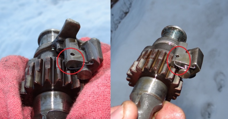

I suspected that the ratchet pawl had come apart, or that the spring had broken. When I got the engine apart, it was obvious that the spring had simply come out of position. See the picture below, which shows the spring out of position (left), and after I put it back into the hole.
Before I reassemble the engine, I want to ensure that this spring stays in place. Any suggestions? Maybe a silicone-based sealer in the hole?
