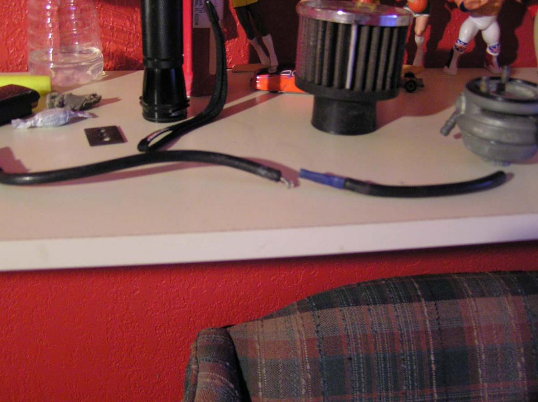

so i checked the plus and the wires were jack ( broken in half and joined back together). I pulled the coil out and you were right Spokes I pulled the wires right out of the coil i didn't even have to remove the the plastic resin no resistance. I'll replace the wires with 7mm spark plug wire aka; snowmobile. I'll also pick 2 NKG caps with rubber seals from honda mini trail.

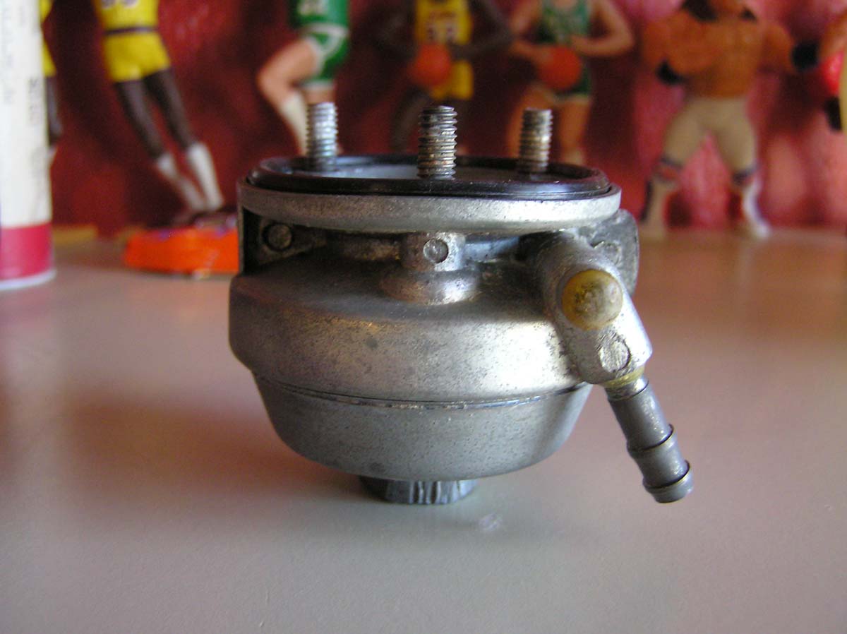

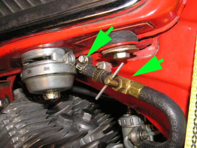

3rd problem i have is with the petcock my lever doesn't work so someone put a brass shutoff valve in the rubber line. I bought a petcock but it looks different than the one i have now so i'm not sure if i should use it? can the experts determine its true DNA ( year,model)

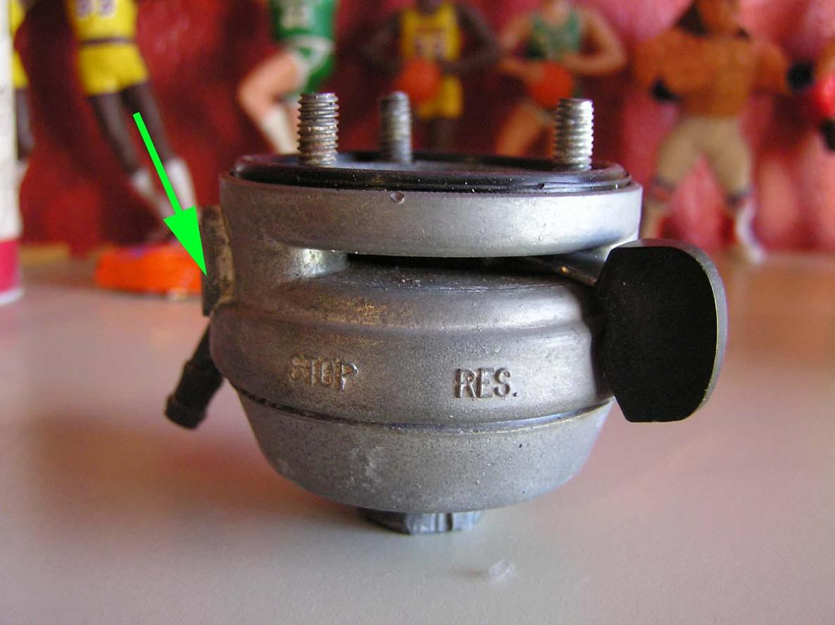

The petcock in the pic is the exact for the year Honda you have. The one you purchased off of ebay, is exact. It was a petcock that was traded for with another member of this forum. The person who sold it to you needed the cash to complete his CA160 as funds are tight.

heres a pic of the petcock thats on my bike, the fuel outlet is on the right side
yes i thought that petcock might be the one you posted pic's of it looks Marvelous Spokes thanks

did anyone ID the petcock pic i posted? the fuel outlet is on the left side of the petcock?

The petcock in the pic is the correct one for the bike. Your replacement should be there this week. Just install the new one and your good to go.

replaced the petcock with the Spokes special, oh the other one i had is off a Ca77 the fuel outlet is on the left side of the petcock because it mounts on the right side of the tank not the left side as on the CA95

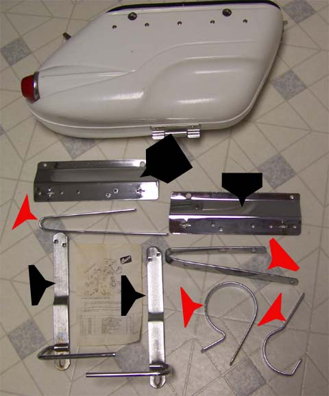

oops i almost forgot, i bought a set of Buco Saddlebags and i'm looking for the ( bullet ) light set up with housing / lens and all but i can't seem to find them?? anyone no a source?

I have built and restored many Buco Twinmaster Saddlebag lights. But at this time I can only get painted bodies. You can still get the original Buco bag lens at http://www.stratolite.com You can also salvage the original bodies if you have them. Check the Buco thread in this forum.
I have also restored the bags and I build new original copy but improved hangers out of stainless steel.
I have just finished a method of wiring the bags without drilling holes. I will post a pic when I send them out to one my contacts.
