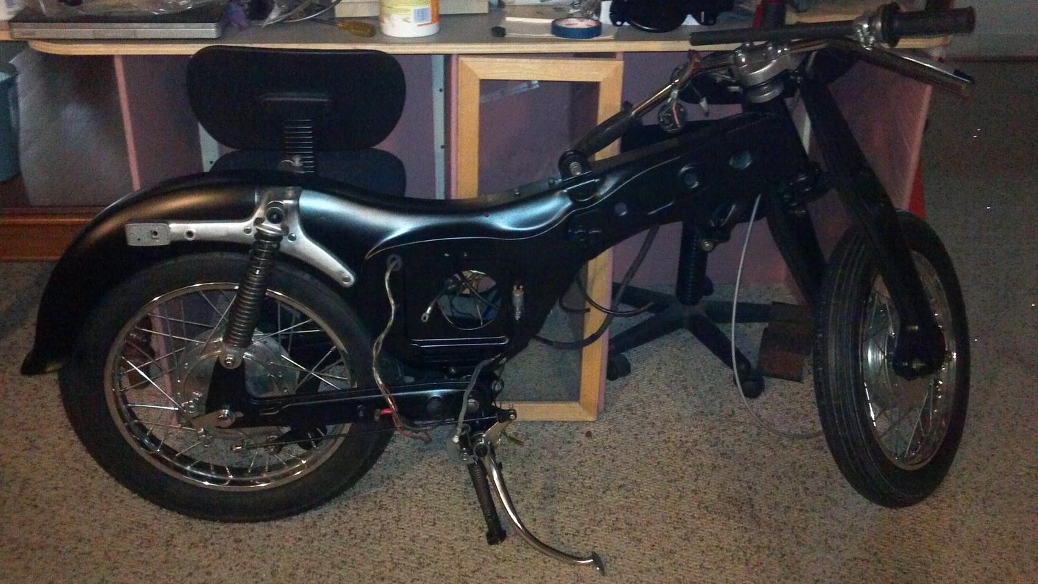

So I'm finally getting around to reassembling my 66 CA95 basket case... I go to route the harness; check the parts fiche; the manual- I think it's going OK- I mount the coils, starter solenoid... but the rectifier- where does that mount? Manual says in a hole far up beneath the tank... I don't see it- I now have it mounted to one of the holes aft of the fwd seat mount (there are two holes in the top of the frame, one each side) but I don't think that's correct. Can anyone let me in on the secret?

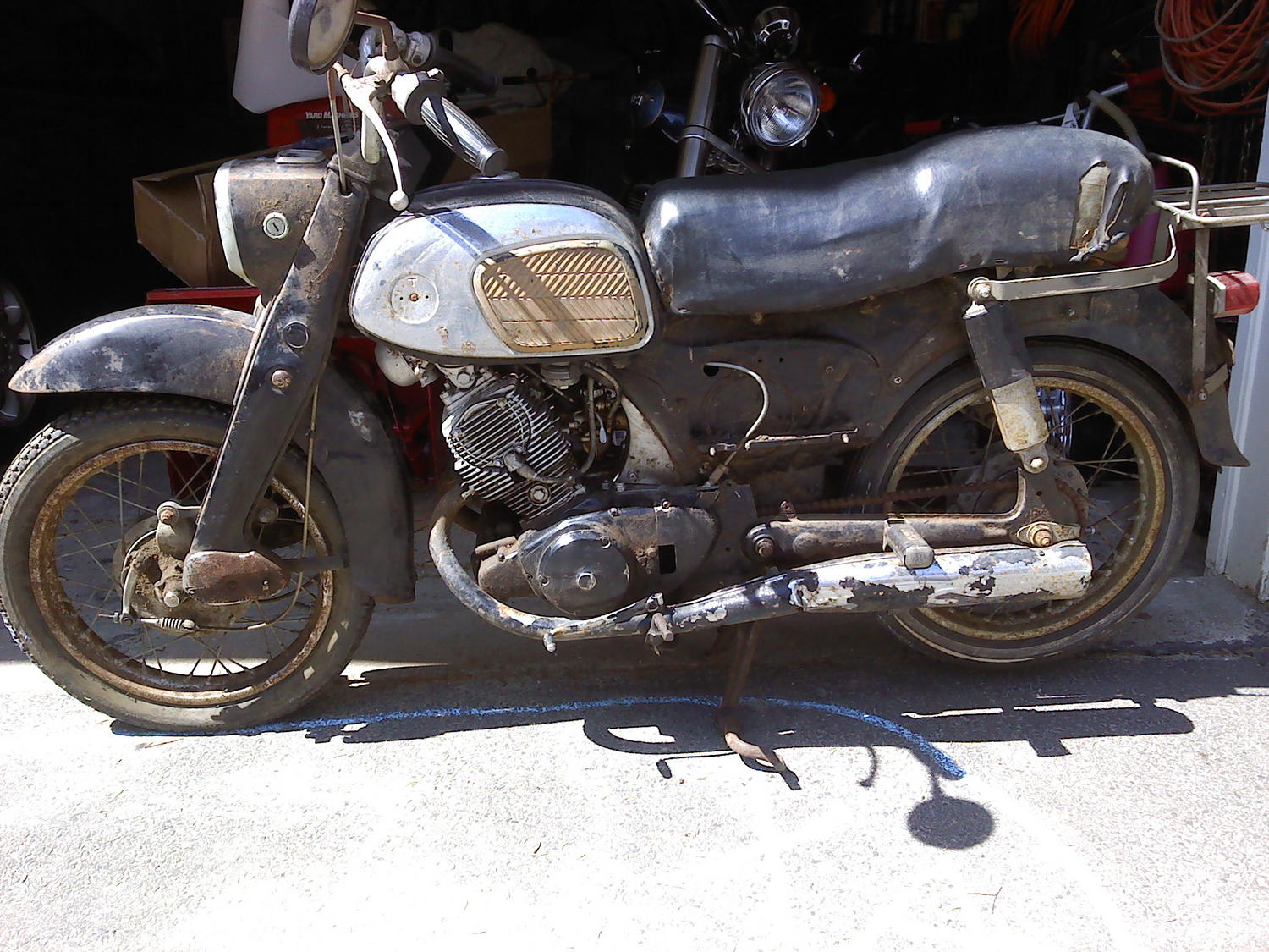

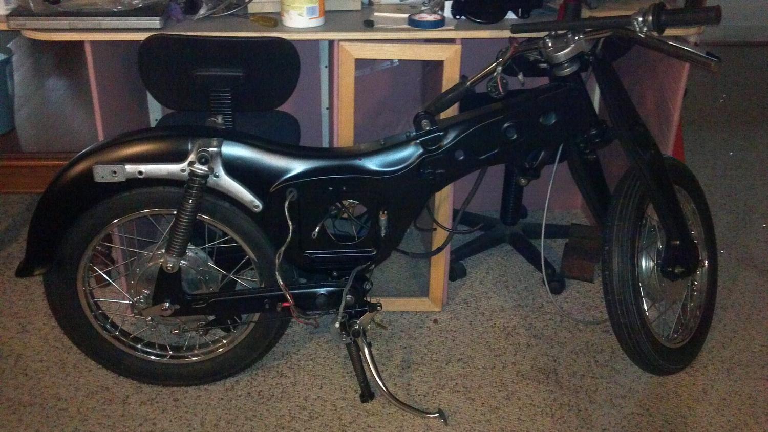

Also- what DOES mount to those two holes? Here's a pic of how it looked when I got it and as it is as of this evening... More pics to come.
Thanks, Dave

There should be a "D" shaped hole on the left side of the backbone, just underneath the tank between two one inch (approx) holes. The bolt through the rectifier installs in that hole. If you pull the rectifier wires forward you should see that they just about reach to the hole in question. The rectifier needs to be well grounded to this spot or where ever you place it so prep accordingly.
