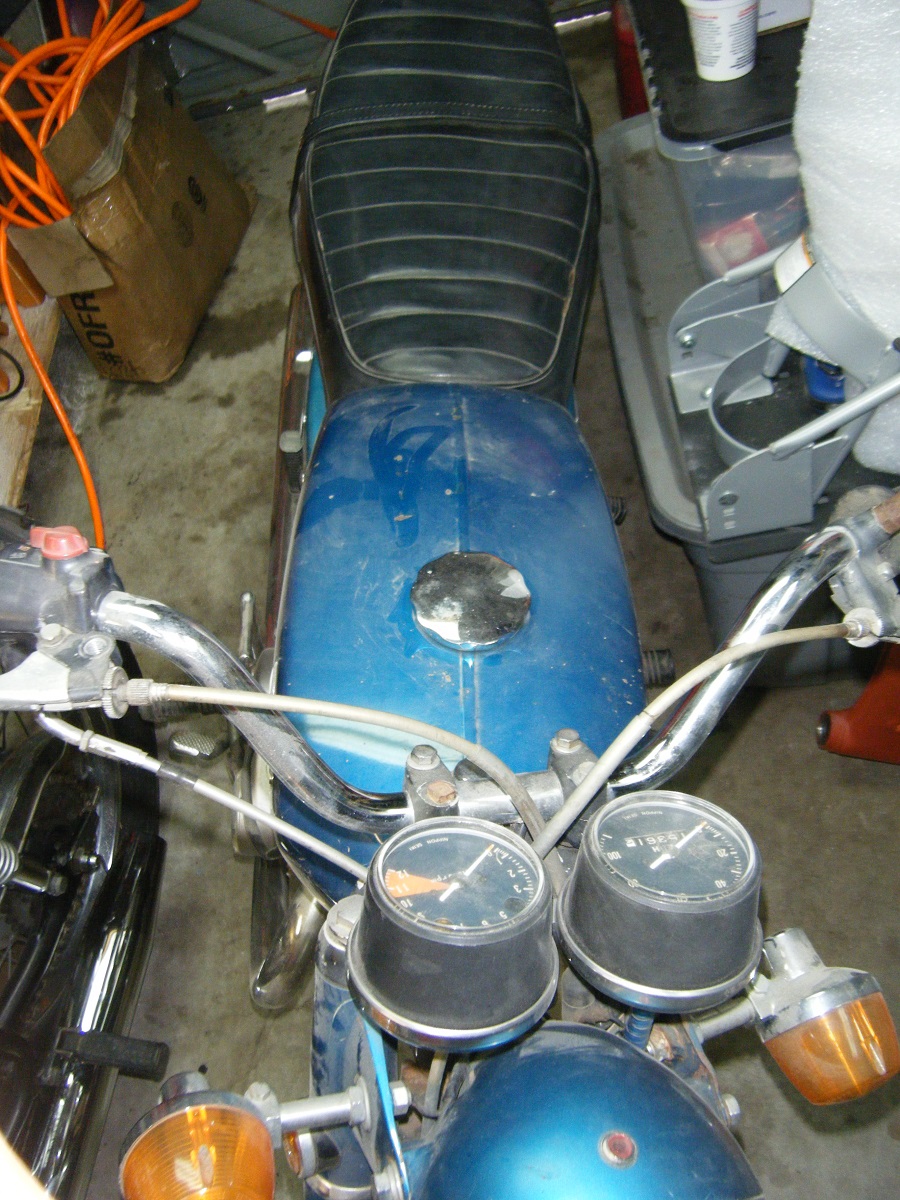

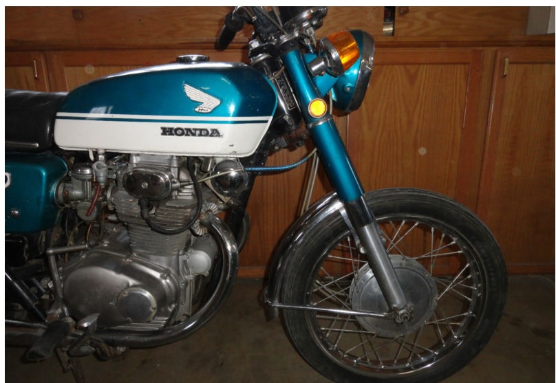

Hard to say until it gets here. This bike is way too complete to butcher so I'll preserve this one for sure. If the patina and paint are good then it will get my usual mechanical treatment and pretty much be left as is. At most the painted parts may get redone.
The bike fits my formula, 60's Honda, decent cosmetic shape, complete, and purchased right. Part of my mission is to save bikes from breakers when I can and get decent bikes in to the hands of others to enjoy the vintage bike experience. The interesting thing about this bike is that it is from the the North (Mn) and like others have suggested seems to be well taken care of and "put away" for winter months. There is very little corrosion as compared to the bikes I've been saving in the south. Additionally it has miles on it, about 15 k, so was a well used bike and should be mechanically fair to real good. Like most bikes I get involved with I can't keep it forever but will enjoy it until the next owner comes along. Could that be you Kev?

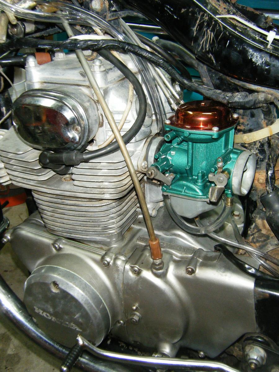

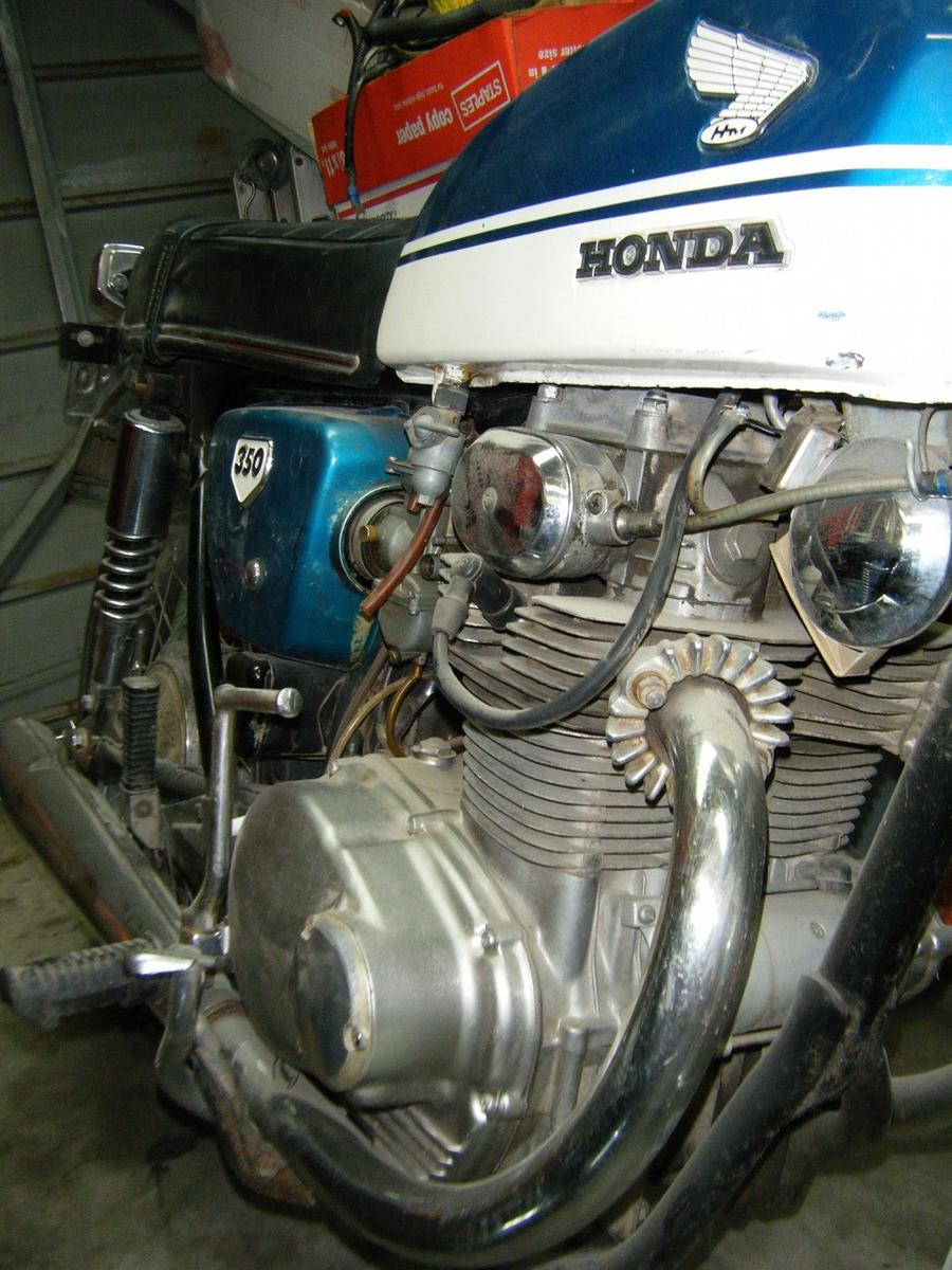

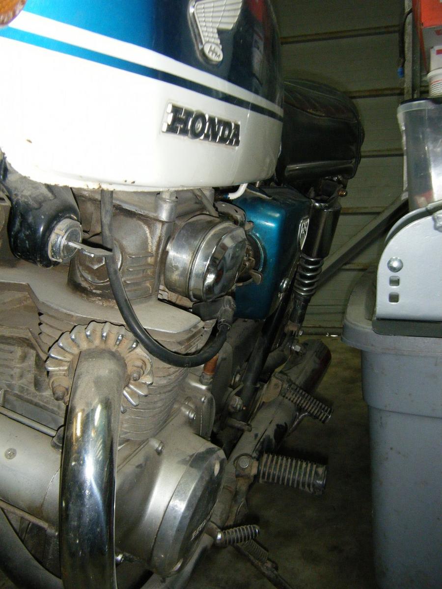

Update- the bike fired up after the usual tinkering and replacing a few basic parts. Just fired it on starting fluid to see if she would fire. Like the true Survivor I thought this bike was, it fired on both barrels and sound good, if even for a second or two. Tomorrow I'll fill the carbs- borrowed from the "$500 Cafe Project" and get her on a bottle (tank is soaking now). Tomorrow I'll post video of her first good run in at least 10 years. The PO had said all along there was only spark in one cylinder (turns out right side coil was bad/replaced with on hand parts). Bike was last registered in 1987, so maybe it hasn't run in 25 or 26 years. I'll report back with more tomorrow.

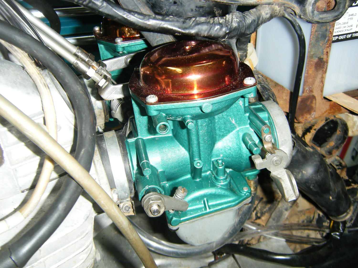

While not evident I ran my carbs from the other bike to expedite things. I fiddled with the look of these carbs (not for this bike) by painting the bodies with Hammerite paint and Duplicolor metal finish paint in copper for the lids. While an experiment at the time they look better than I'd hoped for.

I was surprised at how well it ran on my initial adjustments. I reset the float on the left carb and that has ceased overflowing and re-gasketed the left side cover. On the by, the carbs used are not the ones intended for this bike. These are from the "$500 Cafe Project". Since the engine on that bike is blacked out I wanted something different for the carbs. The bodies are painted in a Hammerite Green and the lids with Duplicolor Copper Plate Ck100. I wanted to experiment with the copper stuff and was only moderately happy. It's very hard to get a consistent coat. The Hammerite on the other hand was baked in place and easy to apply. Overall I'm not happy with the 'look' so these won't stay on any bike. One of the original carbs had a jammed throttle plate that led to a shearing of the throttle shaft on the idle adjustment side. I am waiting on the carb fairy to bring one from eBayland and stock carbs will return. Interesting that the book calls for 115 mains (jets) and my kits had 105s. I guess we'll see once rolling.

YES! That HAmmerite is my favorite. It's the strongest single stage paint there is and looks custom. My friend painted the whole lower section of his old Chevy dually with it and it looked so good. That same teal/grean color of your carb on white is smooth. He bought the Hammerite in a quart size can and rolled it on. Strong stuff.
