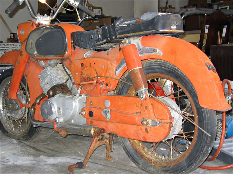

If I didn't have a spare Honda Benly 150 I would have been up a creek. The one you see here had a completely worn out adjuster. In the previous owners frustration he welded some other big nut to the home-made adjuster and tried to make it work. It was pathetic and I didn't know how bad it really was until I removed it. I had no idea how it was SUPPOSED to be until I looked at my spare motorcycle.
This baby sure saved my butt!
Here you can see that this bike is all original, unmolested! Thank goodness it found me. I plan on restoring the chaingaurd and installing it later on. For now I spent all my energy on perfecting the engine rebuild and I'll get it in perfect running shape. It will be ridden around town for show and tell and later on someday I will have time to really get down to business on the frame and wheels. For now they look fine, they are greased and will work like new.
