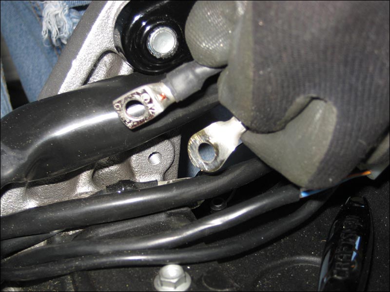

Since this is a pretty hot topic on the forums I thought I would post my own list of things to help the electrical system of the Mille stay fresh and in good operating condition. The very first thing that everyone should do is resurface the grounds to the electrical system on their bike. This is the most simple thing to do and the ground is most often a problem in any electrical system on any auto or bike simply because NO ONE EVER TAKES IT INTO CONSIDERATION. In the human body everyone knows of veins and arteries but on machines everyone just pays attention to the positive side of the circuit. The ground is most important as current can only flow through the positive end as fast as it can return through the negative!
And just because the connection looks clean doesn't mean it's optimized. You REALLY want to brush the surface to get it nice and shiny. Cleaning the contacts this way is the only way to assure a really good connection to the mating surfaces. I used a flat file which surely shined them up. Then if you live along the ocean you can assemble the pieces and spray them with battery terminal corrosion preventative spray coating. If you look at the most race cars and car stereos you will see how seriously the engineers take the ground lead. You should too.
There is a ground that is connected to the engine as well but I didn't get a picture of it. Maybe sometime if I can remember.

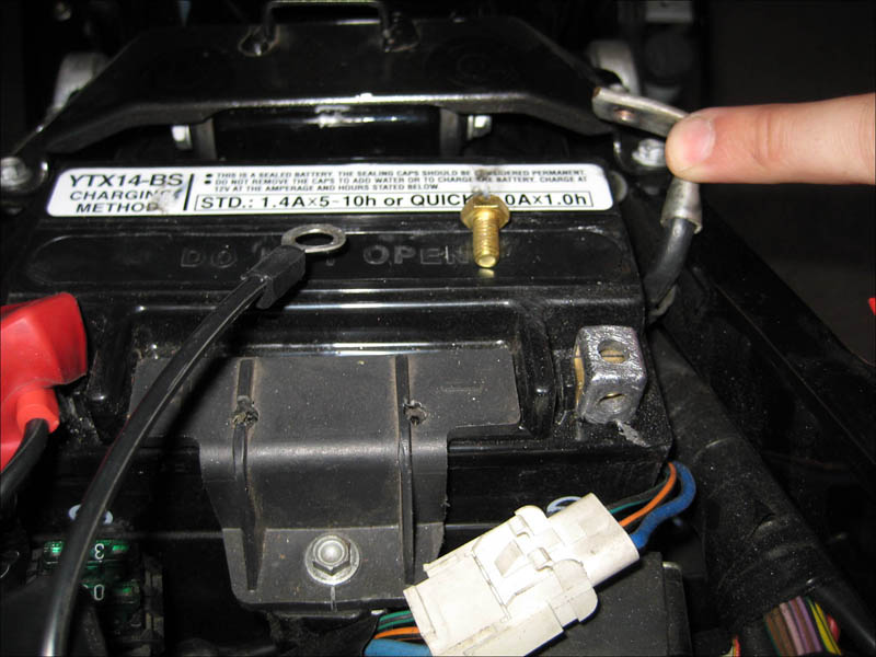

I cleaned the terminals extra good on the top and the bottom then bolted them back to the battery... same thing. Well the dirty terminals can cause a loss in amps and also be a hindrance to the system as it tried to charge the battery while riding.
I went ahead and cleaned my terminals as they were kinda dirty... almost looked like WD40 residue on em or something. Then I put it on the Battery Tender and it's taking a long time to charge today... somethings up. I think my turn signal integrator is toaste and causing a drain on the system. I did also find a small exposed nip in the positive cable that could easily arch and cause problems so I wrapped it up tight. I'll take before and after readings tomorrow when I ride. Something is up and it isn't the HID light!

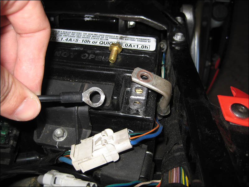

Clean Clean Clean those battery terminals and connections! Make sure and get underneath just like I'm pointing out in this pic.
And scrub the Battery Tender connector as well. Make sure things are real good and tight. I forgot to put a dab of blue threadlock on them today. I need to remember that when I get back from my ride and check the voltage tomorrow. :P

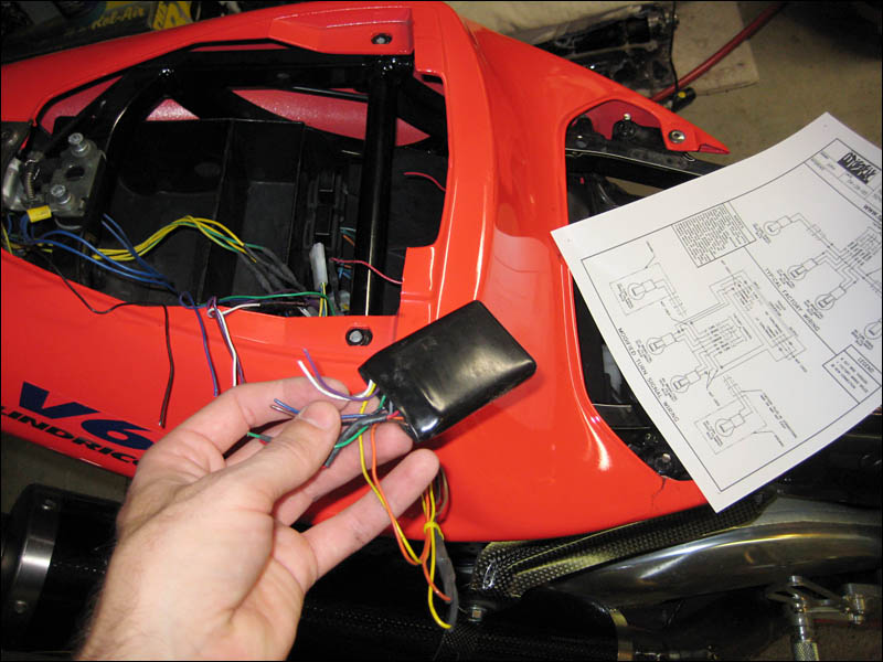

If you see one of these in the back of your bike just toss it. It's a POS integrator for the turn signals and mine never worked. Why go through the hassle of hooking something up that is an overpriced piece of crap? I didn't install it though! It came with my rear tail light assembly. What a waste of time. It's gone and the rear lights are back to normal.
So as of now I have a Yuasa battery that is 3 months old. I haven't installed a Yamaha relay for the starter yet. My bike seems to be holding a charge well now that I removed the dumb black box that was supposed to be a tail light signal integrator but never worked. I also found a very tiny open sliver in the wire that was near the positive connector on the battery cable. I don't think it was arcing or anything to ground out but I made sure to wrap it well with electrical tape.
