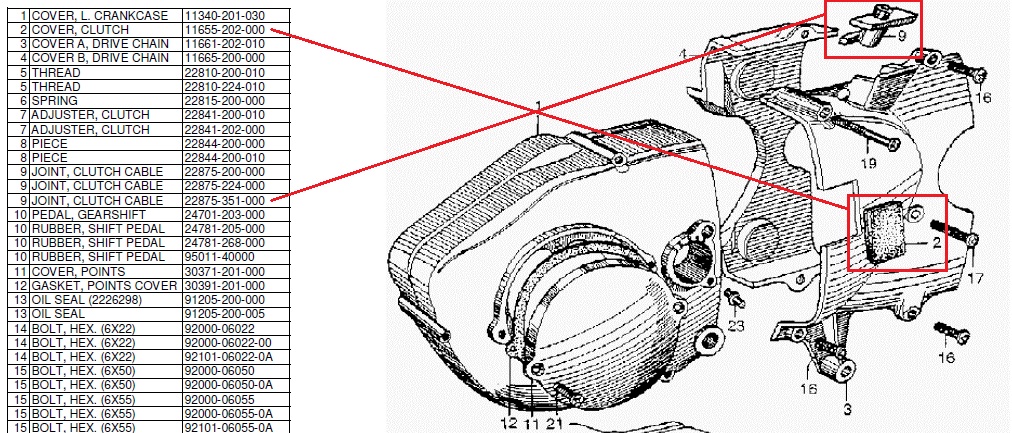

Well it has been a while since the my dream was dismantled for rebuilding. I'm in the process of putting it back together and have a couple of questions for the experts: The left side cover that mounts toward the rear of the engine has a cut out for the wiring harness which is obvious but what is the rectangular hole for on the side? Secondly, I would like to reassembe with all new hardware and was wondering if anyone had use button head allen bolts for this? Anyone have a source for the complete set of hardware?

The clutch cable has a square part that holds it in the side case.
If you have the parts book it's on page 61 item #11.

65Honda wrote:The left side cover that mounts toward the rear of the engine has a cut out for the wiring harness which is obvious but what is the rectangular hole for on the side?
Not sure what rectangular hole you're referring to, so let's work with visual aids.
#2 in the schematic is a rectangular port that provides access to where the clutch cable connects. This port was added at some point, and may not be on the earliest bikes.
#9 is an aluminum joint that supports the clutch cable.

Thanks ByTheLake and DanUhr. Both of you have been helpful. Items 2 & 9 were what I was refering to. I have to look around and see if I have those two peices (I was not the one who took it apart) Am I correct in assuming that # 9 is attached to the cable?
65Honda wrote:Am I correct in assuming that # 9 is attached to the cable?
Yes, the clutch cable routes through part #9.
