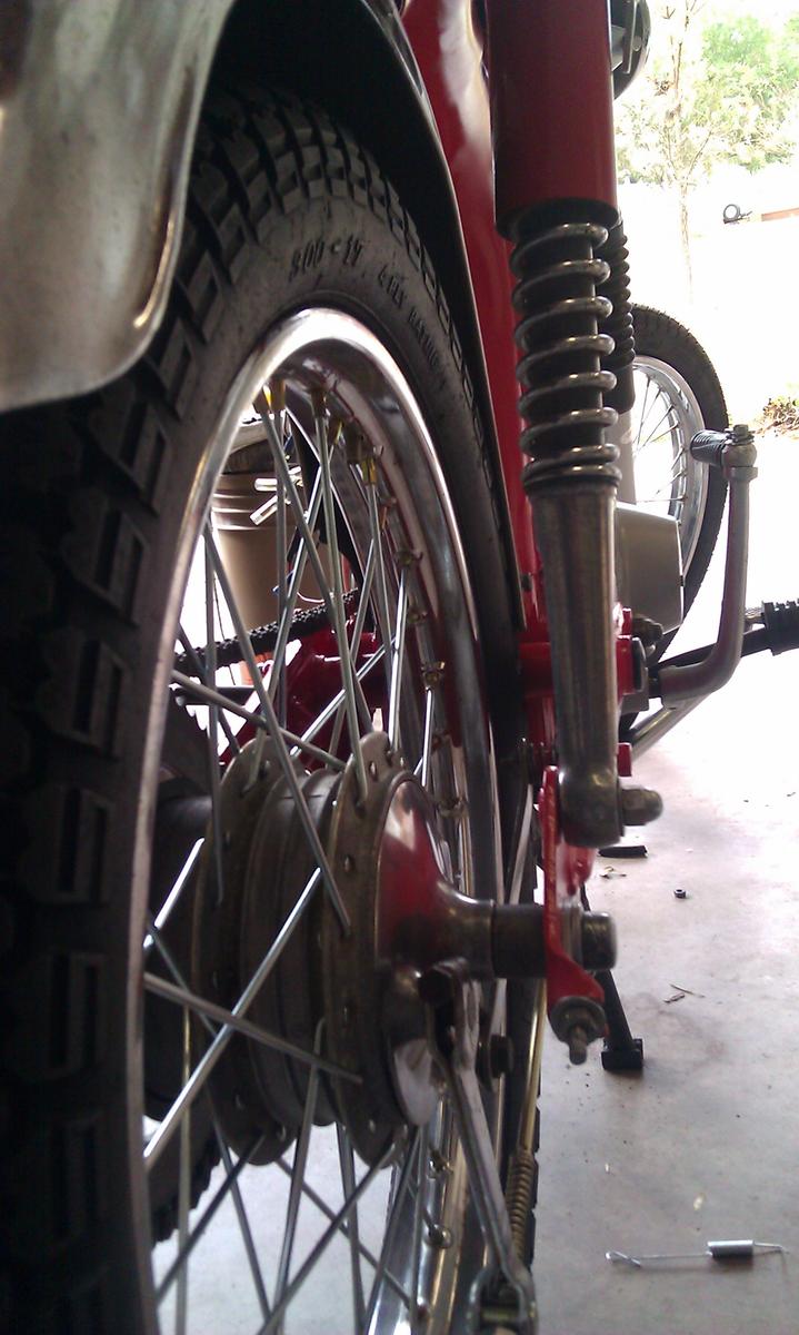

Almost finished! I tried to clean up the muffler, but it was just so dirty. I found a little muffler on ebay for 70cc-125cc motorcycles and got it. It looks like it matches up great. I will put it on tonight and try to get it running. I need all new turn signals, tail light and horn, but at least the headlight turned on! I ordered a spacer for the back weel, I have a washer on it now, but I dont see how there is enough room. My tire is rubbing aginst the right side of the fender, the spacer will only push it further that way.

I guess the swing arm will open up more if the spacer is installed.

what happened did you loose the spacer?? just so you know the front wheel only uses one spacer.. i would not try too ride it with that washer its not going to work out, the spacers hold the bearing into the hub, you may break the hub, or mess up your paint on the swing arm..

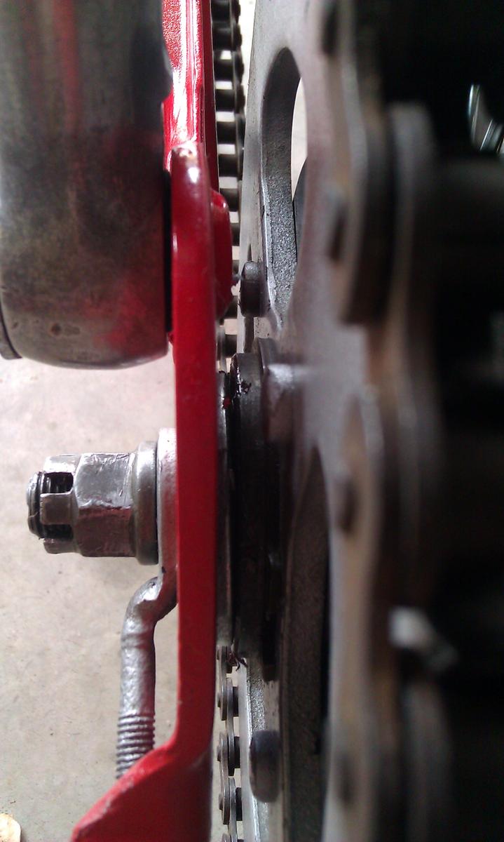

I dont think It had one on it when I got it, but i ordered the one in the picture. I have 1 on the right side, does that one look right? the one i ordered looks about a 1/2 inch wide.
will1972rupp1
Posts: 60
Joined: Thu Sep 22, 2011 9:31 am
Post by will1972rupp1 »
looks like it too me.

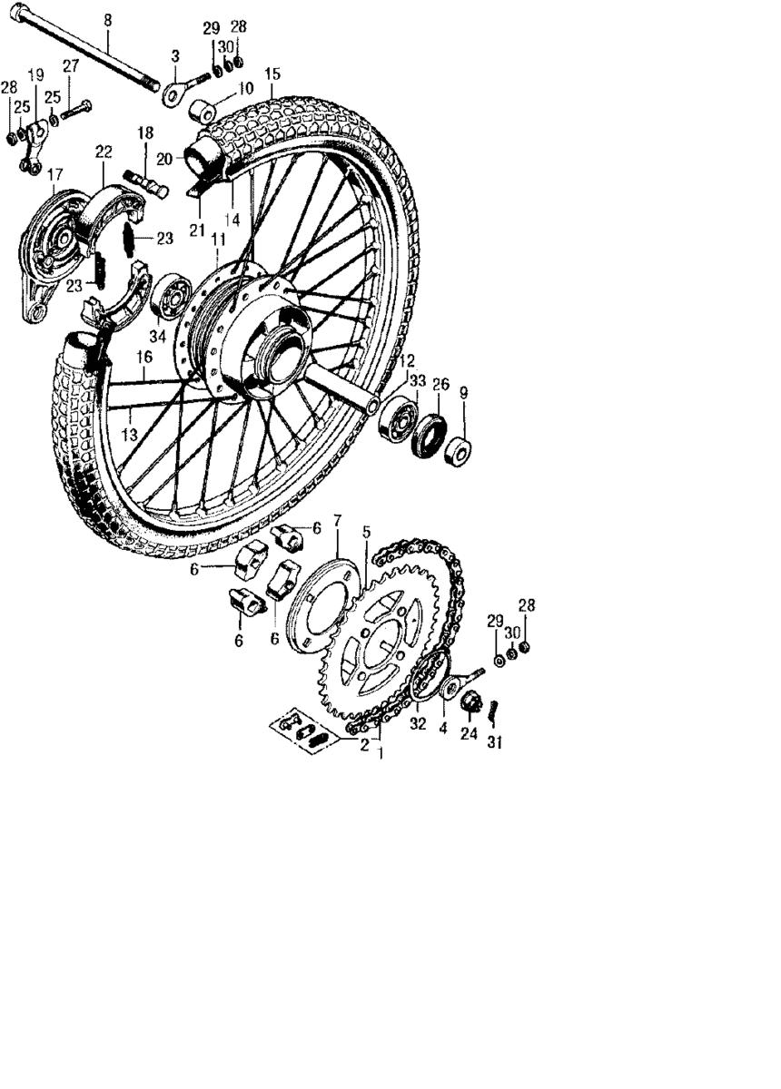

If you look at this closely, it appears that the collar #9 is on the inside of the hub, and there is no spacer or collar between the sproket and swing arm. I have all those i think. I just dont have one between the sproket and swingarm.

yes #9 slips in the seal agents the bearing.. that is the only one..

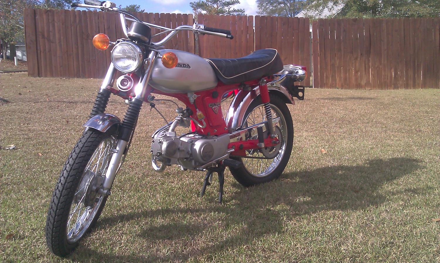

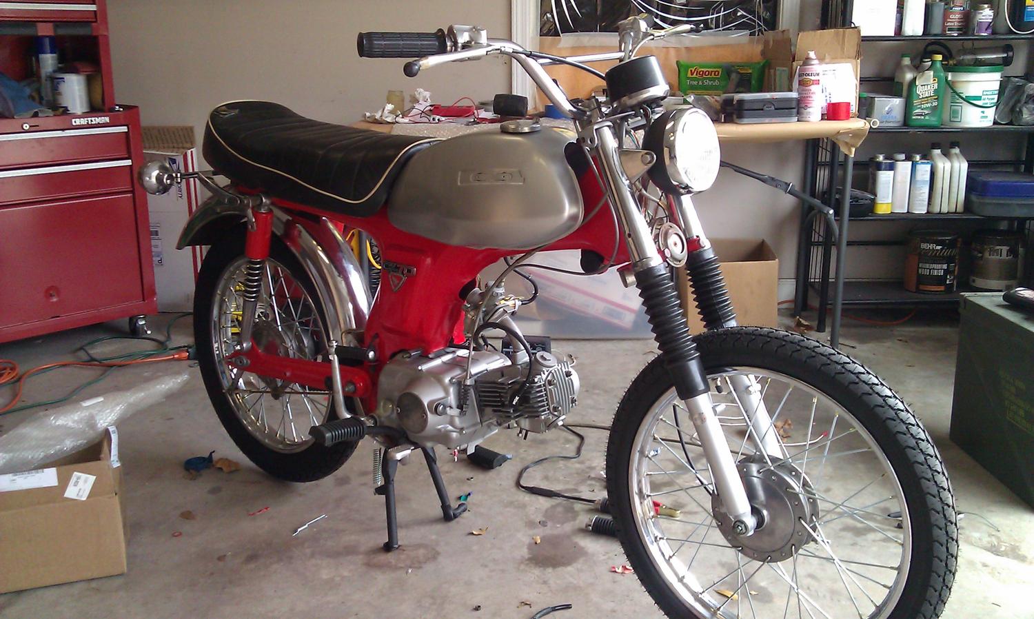

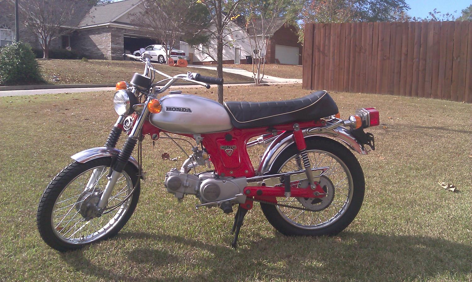

I accidentally posted pictures on your thread, anyway this is the final product. It took about 4 months but it rides nice and all the electrical works well. It should, it's new. I really appreciate all the help and advice becuase this was the first time i have attempted working on a motorcycle.
