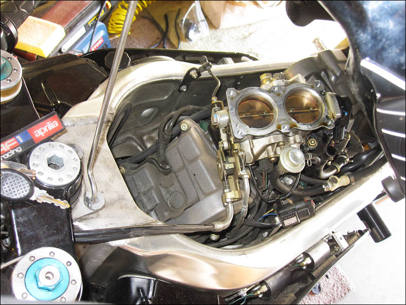

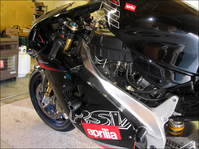

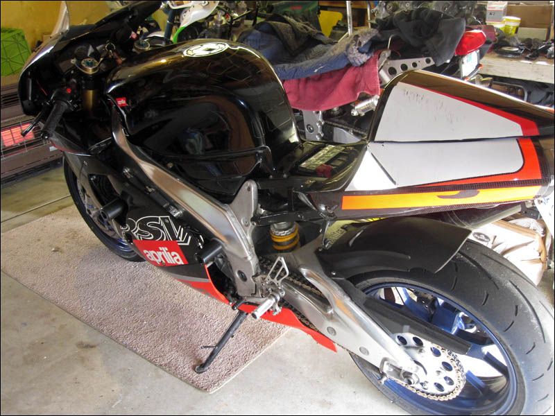

STEP 1: Simply remove the seat and the side panels from the bike. Easy enough and you're nearly halfway there already!

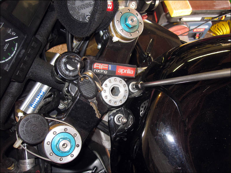

Next to remove your fuel tank, or at least prop it up, unscrew the mounting bolts and hope you have the little prop rod that is included with the bike originally.

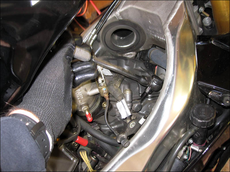

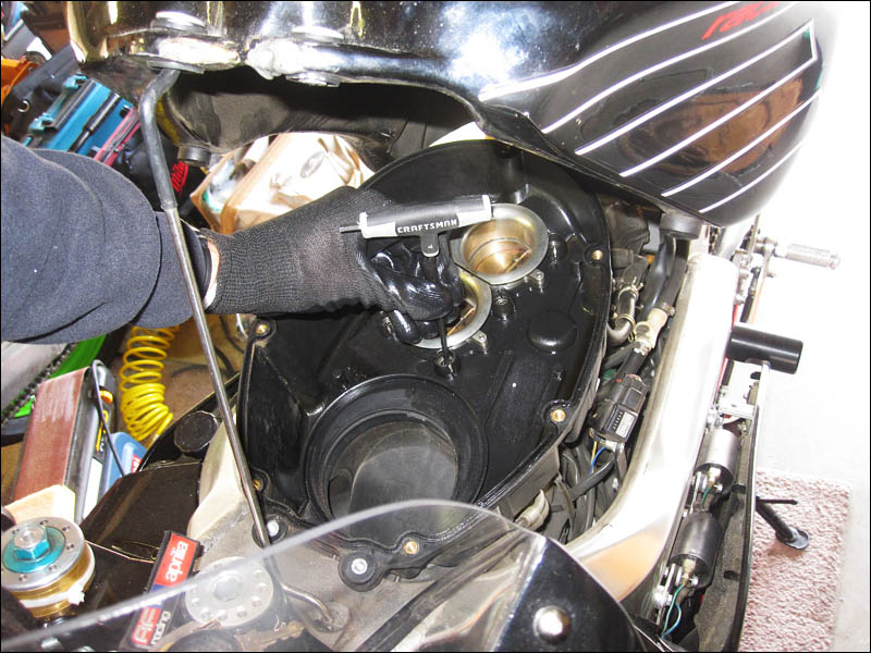

Now you need to remove a connector and a vent hose from under the box right here and then get to work inside removing 6 allen screws that will allow you to just pull the box right out.

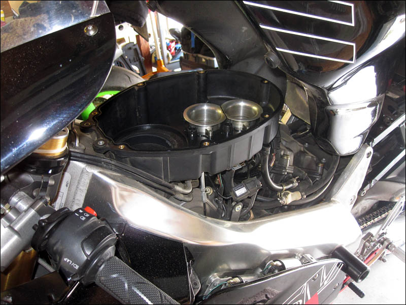

Here I am lifting the bottom half of the airbox out of the Aprilia chassis. Now you have exposed the top of the engine and you can easily access all of the spark plus in the little Rotax 990 engine.

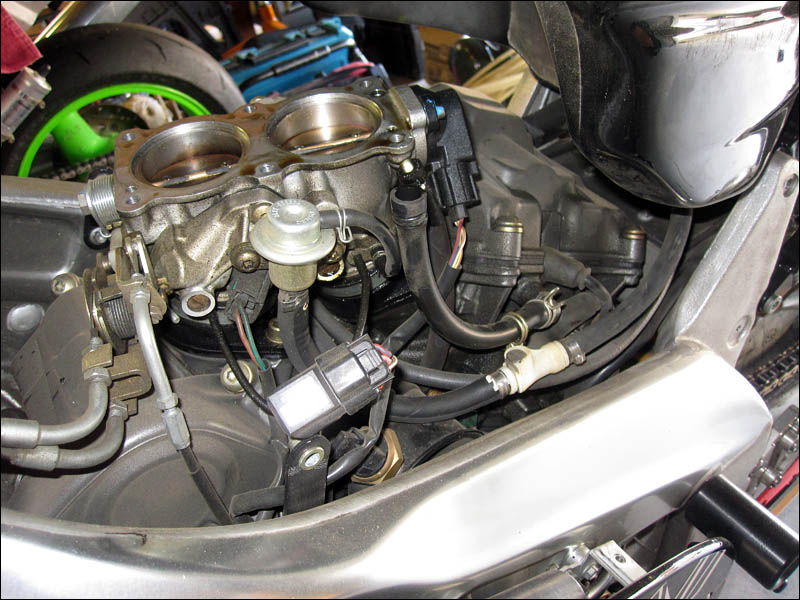

The front cylinder spark plugs are the most difficult to get to. Once you pop off the spark plug boots I highly recommend that you get some compressed air and do your best to blow out any rocks, sand or debris that might have gotten trapped down near the spark plugs before you remove them.
Here is a shot of me removing the right side plugs with a short extension for one and I used a swivel joint on the other as well. It was pretty easy and I wouldn't even try this without removing the air box.
And I saved the easier plugs for last. Here are the rear cylinder plug caps that you grab hold of and pop off to expose the plugs. Once again don't forget to try and blow out any dirt that might be in there before you take out the plugs.

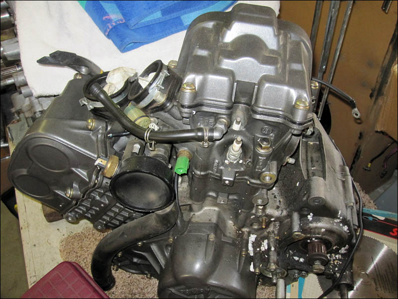

This is my spare parts engine on my bench here. It's handy to have a good idea of exactly what my engine looks like so I can see every nook and cranny around the plugs before I removed them. I actually just took the plugs from this engine to use. :) Thanks to RFM I was able to get on riding my Aprilia instead of having to go order some plugs and waiting for em to come in the mail.

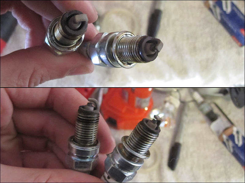

Here are the plugs I took out of my Aprilia engine. They LOOK ok and not that worn out but they just wouldn't work. The gap had grown to just over .035" and I'm sure the carbon that had gathered over the 15K miles just was too much for the plugs to operate. I'll be using my spare engine plugs for now but I'll be ordering a new set when I put in another order for motorcycle plugs.
