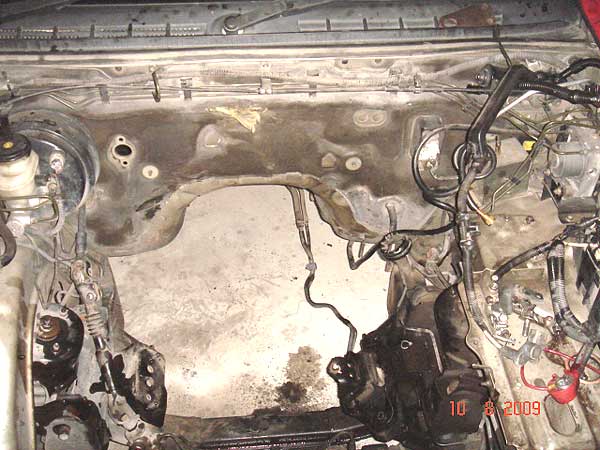

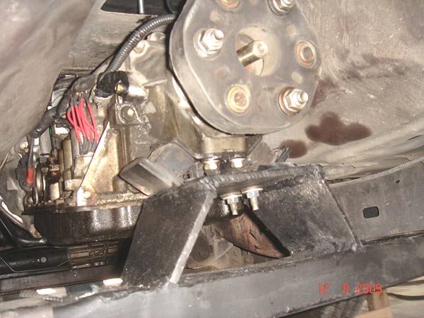

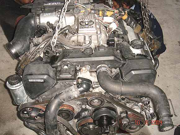

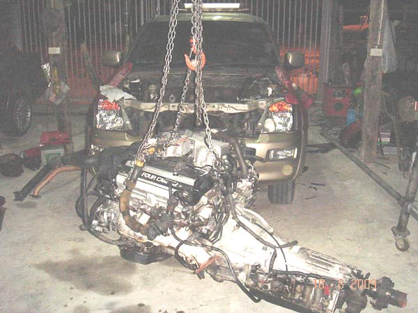

I use the car ISUZU D-MAX + 1UZ + GAS LPG + 2WD.
I would like advice / explanation about the 1UZ-FE.
1. The size of the intake appropriate to the size a few inches intake.

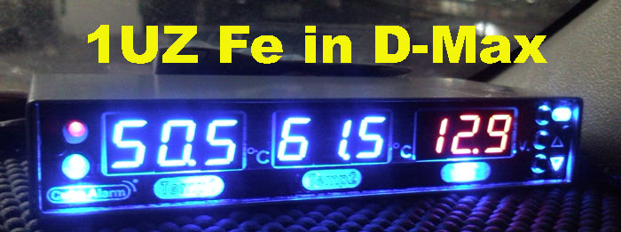

2. Typically, the heat of the engine about a few degrees.
3. Exhaust pipes should be separated or combined pipes.

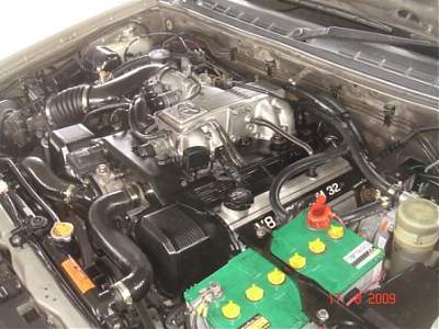

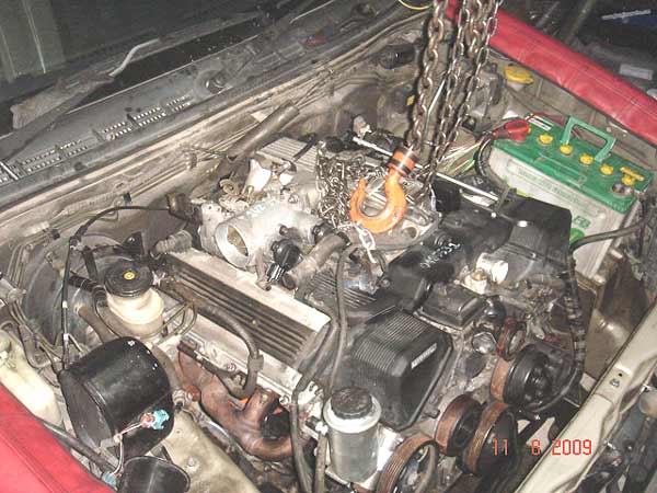

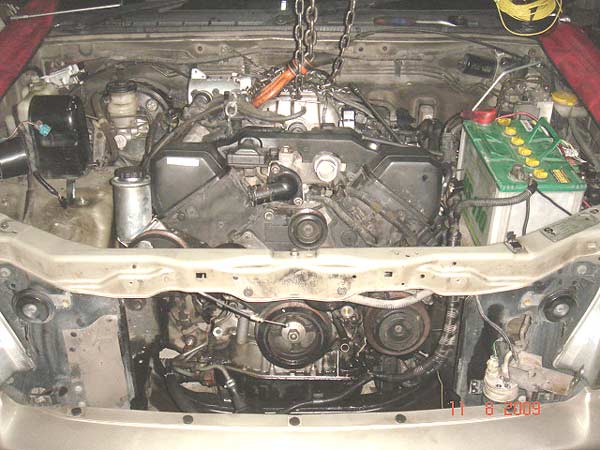

Heat really isn't an issue. Just hook it up and run it. As long as you hook up some decent size radiator you won't have a problem. I don't even run the fan on mine. I will use a switch when I go off-road and in the sand. Just use your Toyota radiator and you will not have a problem.

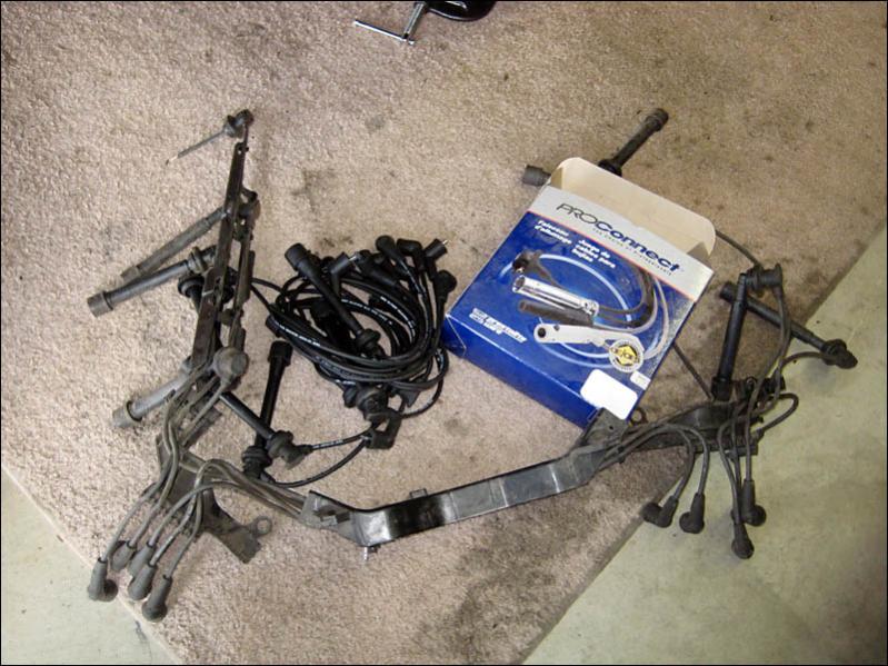

And use the spark plugs and spark plug wires that came with the engine.I returned the new spark plug wires to the store. I didn't use them. They were too short. The stock Lexus wires are just fine.
Just connect the intake and use it. You just need to connect the AFM - Air Flow Meter and make it fit. My intake is different since I run a custom computer of course.
