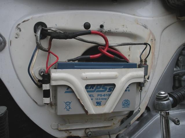

i use this one:
http://www.atbatt.com/product/3526/sla/ ... f2/battery
paid $26 for it locally at a battery specialty place. made some new connectors and it's super clean looking and theoretically has a better service life as it's meant to live through being discharged frequently. comes charged, no need to juice it.

it's a little less deep than the factory battery, so i just cut a piece of radiator hose to wedge it in there snug. you will have to splice the two power wires into one spade connector or use one of those spade splitter things- but splicing is cleaner. good opportunity to make a new ground cable as well. at first i had my doubts that the tiny little connector would flow well enough, but it works great.

Very nice installation, I am a union electrician and I appreciate clean work. You heat shrank all the connections and sized up the wire. When you tied the original wiring in to the new positive lead, did you ring and bolt that connection or use compression connectors?

hoghungry1 wrote:...did you ring and bolt that connection or use compression connectors?
after digging around my bin and coming up short, i just clipped some metal off an old hose clamp to make a crimp connector and then soldered it. i was out of heat shrink in that size so i used friction tape. i was a vw mechanic for a while- fixed lots of bogus wiring and did many engine swaps requiring extensive rewiring. i could wire a car from the ground up but am terrified of AC. i've had such crumby luck with other bike batteries i figured i'd give this a shot. so far so good.

Not sure it is a good idea to run a sealed battery in these bikes. Their electrical system lacks a voltage regulator, which means they can over charge the battery if run at max rpm with the high beams on. Over charging the battery builds up excessive heat and can cause the battery to boil over. With the stock battery this is inconvenient and shortens the life of the battery, but with a sealed battery it can be catastrophic.
