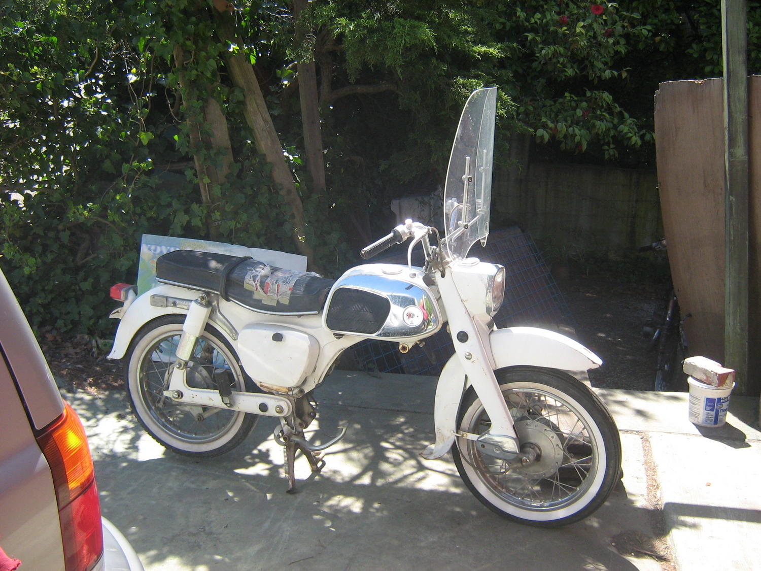

In the process of acquiring parts for the '60, I ended up purchasing a 1964 Benly (see attached before & after pics), because it came with a set of NOS early flat-side mufflers. Actually, it was the mufflers I wanted, the bike I had to take as well if I wanted to seal the deal. It came with a box of nice NOS parts and some used spares as well. Overall it was a good deal, but this '64 needed a motor, a complete exhaust system, a handful of missing parts, and a bunch of cleaning.
This '64 CA95 I've since nicknamed Whitey to help me easily identify my two white '64 Benly's. Whitey has been a distraction from the restoration of my '60, but the location of the engine for this bike also secured me some more spare parts and a NOS front fender, which I also needed for my '60. All in all, this '64 has been a fun project and I have learned a lot about restoring the Benly motorcycle.
Whitey sports an original not rebuilt '63 motor with used early exhaust pipes and mufflers sourced from 3 separate local swap meets. In addition to the above-mentioned missing drivetrain parts, I needed to locate a used horn, coil, side cover, air cleaner cover/tool tray, battery box, carburetor and lower chain guard.
I started the sympathetic restoration of this '64 by stripping off with lacquer thinner all of the PO-applied rattle can paint; bringing it down to the original Honda white paint. I then used chrome cleaner to remove any rust stains created by nicks or bare spots in the original white paint. I rebuilt the tail light, starter switch, horn and petcock, coated the tank with POR-15, and restored a sourced lower chain guard which I gave "patina" to match the rest of the bike.
I also installed a new battery, headlight, and drive chain, along with a set of new 3.25-16 Coker whitewalls to replace the original 1964 Inoue whitewalls. Of course, I also checked the brakes and repacked the wheel bearings. Lastly, the vintage white seat showed up on eBay and I couldn't resist adding it to complete all-white theme that could have been ordered from Honda "back in the day".
