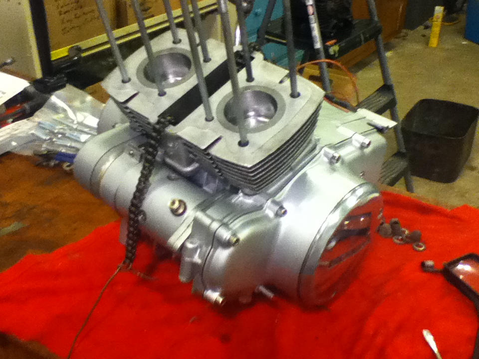

Post by Steverinomeiste »
Thank You Chip
I followed your instructions and all went smoothly. Thank You.
