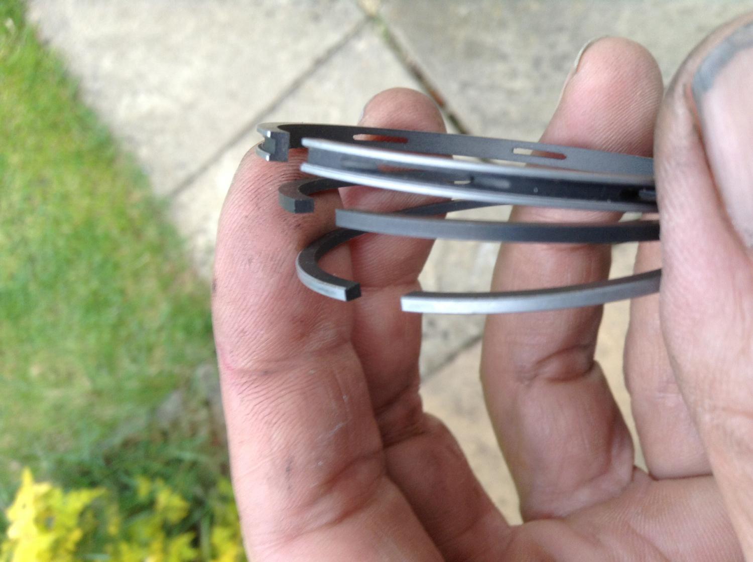

Nige1100s
Posts: 43
Joined: Sat Mar 20, 2010 2:45 am
Post by Nige1100s »
Thanks for the interest.
This is a spare set of rings, genuine honda the top and middle are the same but the oil control is a bit different. You will see that the shiny one is bevelled top and bottom and the middle rectangular and parkerised. The oil ring is shiny on the ring face where the set I used was parkerised. I followed the view that chrome rings always go in the top.
