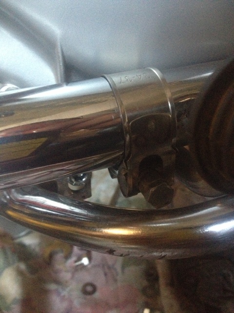

I have after market mufflers and just slotted the mufflers a wee bit and used a good quality exhaust clamp.....no packing or gasket used....and no leaks ;)
