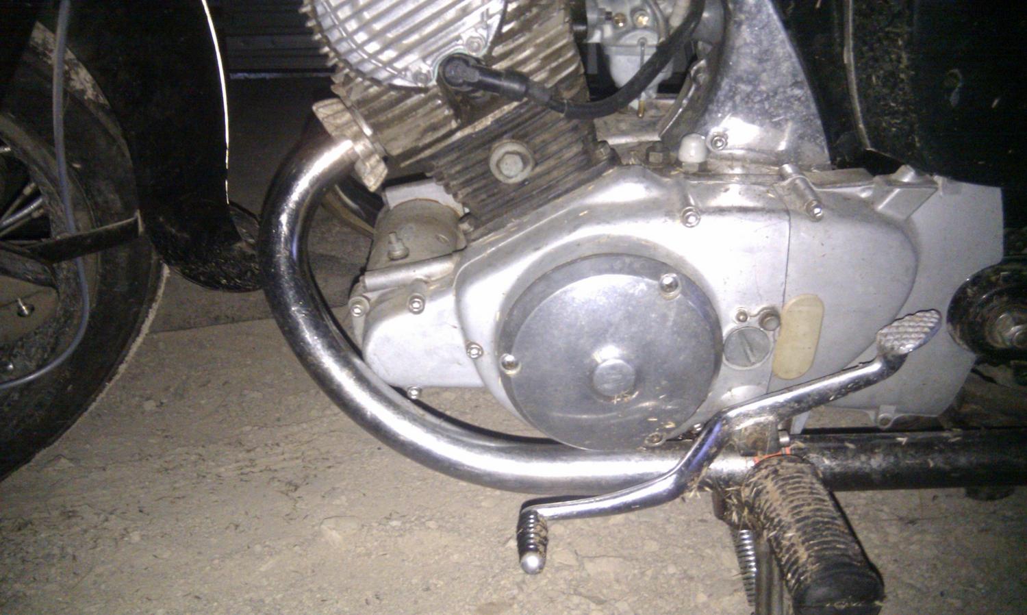

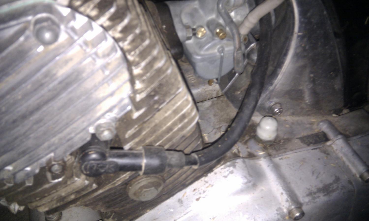

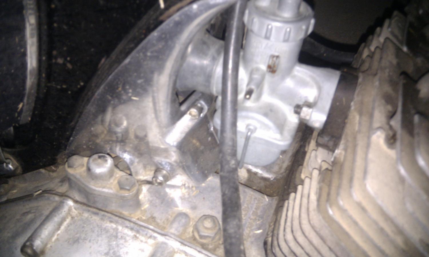

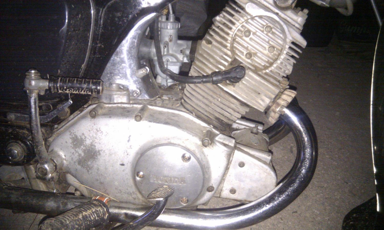

VegeKev
Post by VegeKev »
Hey Sam,
Sorry for the delay in responding...been away for the weekend and didn't have web access. :(
I've attached some photos, hopefully they will show what you need to see.
Excellent news to hear that I can play with the internals a bit :D
And Yes, very interested in the CB pistons....PM me and I'll get some $$$ transferred
Do the wrist pins (I call them gudgeon pins!) usually wear enough in 30k to require replacement?
Thanks heaps for the info, makes this sort of work far less stressful to have a knowledge resource like yours available ;)
Kev :)

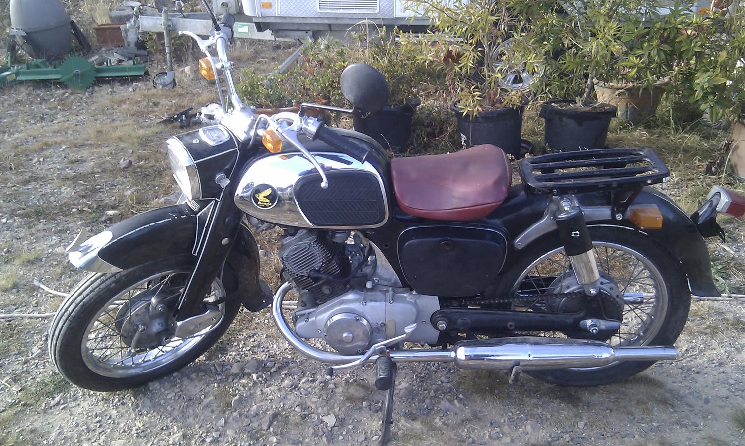

Sam Green
Post by Sam Green »
Hi Kev, the reason I asked for the pics was that models seem to vary a lot depending on what country they are destined for.
I had never heard of a C92 with a two bearing crank and just wanted to be sure of what you had.
Apart from the seat, rack and silencers, your C92 looks just like the UK spec bike which had a 3 bearing crank and from the pictures, I can assure you that your motor has a 3 bearing crank.

VegeKev
Post by VegeKev »
Hey Sam,
Thanks for the info...I'm not surprised I had it wrong... :o
I thought the earlier models had the 2 bearing crank...happy to have the extra support for the extra super fast ninja turtle CB internals :D The speedo is in Miles and the seat and rack are as I received her. The pipes are Thai ebay specials.
