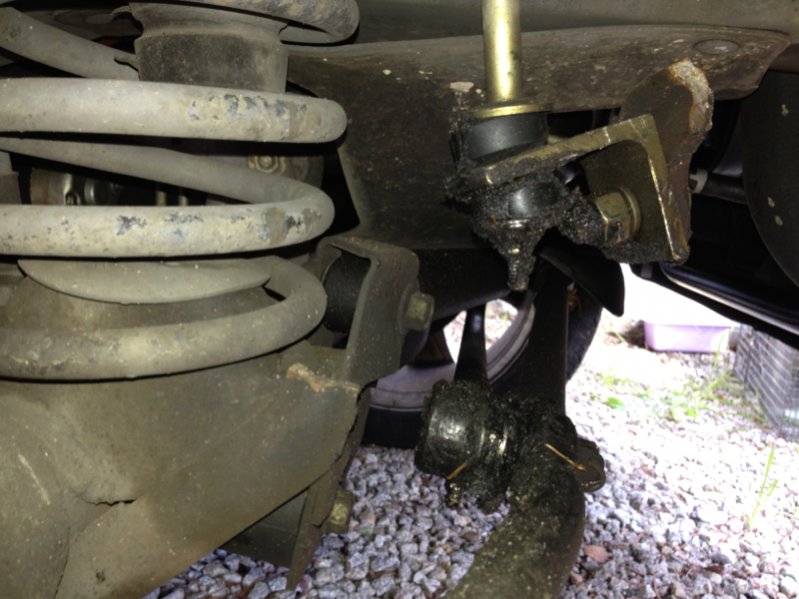

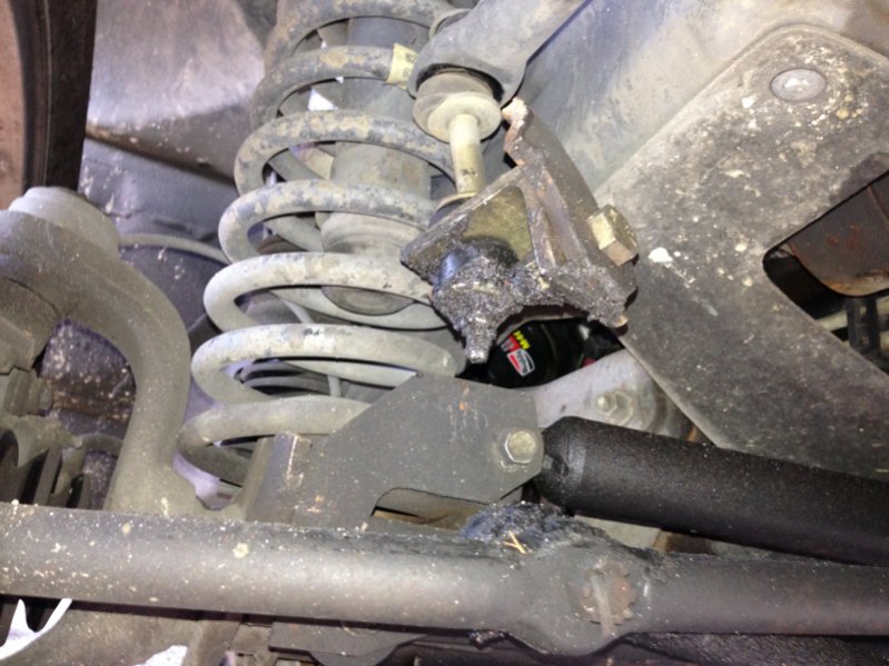

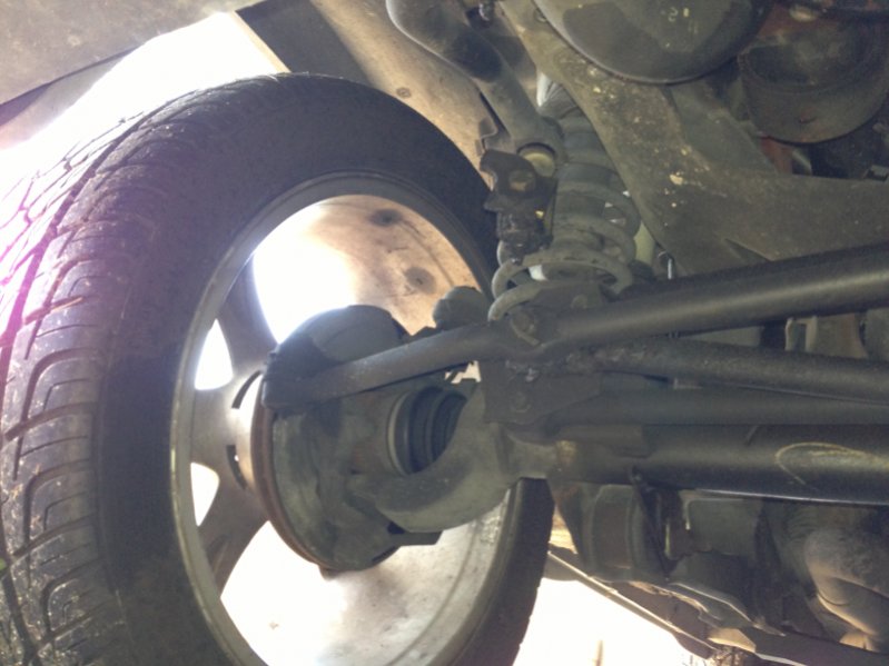

Must have snapped from the stress turning into this steep angle in my driveway every day.
digglah
Posts: 13
Joined: Thu Apr 01, 2004 11:21 am
Post by digglah »
Pretty sure having a stiffer addco swaybar just put too much torque on that flimsy little mount. That angle iron L-Bracket should probably be eliminated somehow, so it can just be attached with a straight-through bolt.

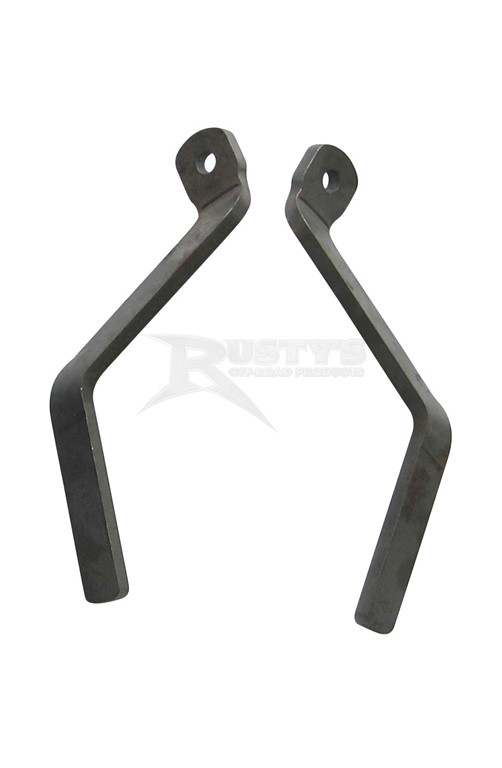

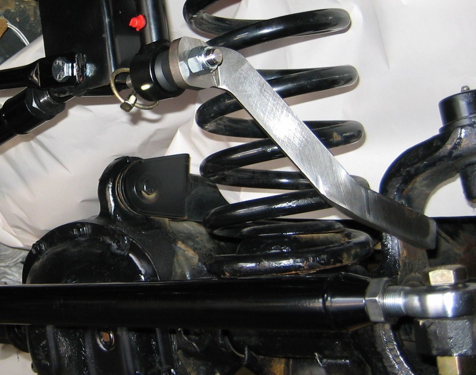

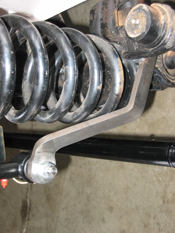

Some axle mounts like this would probably be the way to go:
http://www.rustysoffroad.com/rustys-swa ... -pair.html
