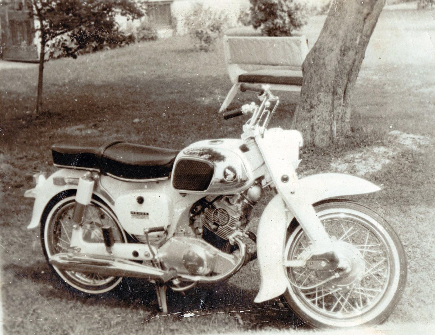

Can anyone tell me the exact year and model of this bike. I owned it in 1966 and 1967. I'm pretty sure it was slightly used when I bought it from a Honda dealer near Utica, NY.I think it was a 160cc. This is the only photo that I have of it. Wish I still had it.
Hi TMan. Without vin numbers nobody would know exactly the year. It IS a CA95 the 150cc Benly and not the 160cc Touring. You are in the right place for both and the bikes share many commonalities. They are plentiful with one member Spoke just selling a nicely redone bike similar to the photo. While wonderful little gems, they are not particularly rare and other than personal resources there is no real reason not to have one. I get the most joy building them, some others from riding. The best part are the looks you get from others though, always smiles......
And yes the bike in the pic is likely a 65 or 66. The title may be different than the actual year it was produced.
Larz is correct. You can get an idea of the year by looking at the engine number. ca95e-5xxxxxxx would be a 65 ca95e-4xxxxxx would be a 64
The frame number is at the rear of the toolbox cover near the bottom by the wheel.
