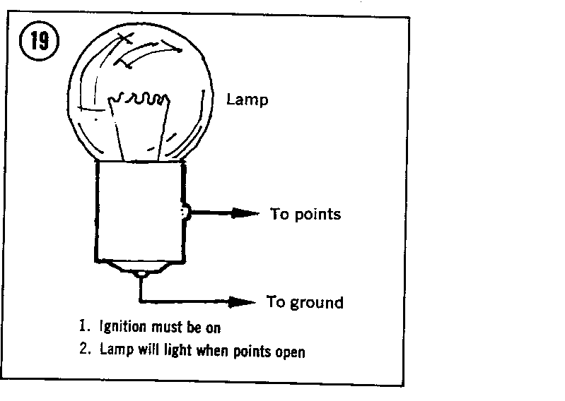

The manual also says to use a tester light to determine the exact instant the points close. I remember using a simple bulb in a socket to set the timing on my VW. Can I make one of these with a 6 volt bulb in a socket? And where do I connect them? One to ground and the other somewhere on the points I would assume.

You can set up the test light as you had with the VW (see diagram).
