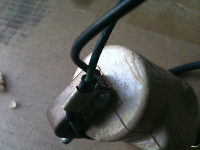

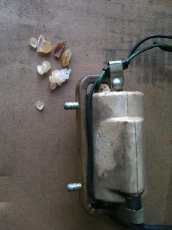

Fouling plugs, bad spark, yada yada yada...
Pulled the coil out and found that "waxy substance" you guys talk about all over the place.
Where do I buy a new one with the plug wires/caps wired in? Any suggestions?

Most folks think that you can't replace the wires. All you need to do is chip away the plastic resin like sealer around the spark plug wire at the base on the coil. Once the sealer is chipped away, just give a good pull and the wire comes out. Look inside and you will see the contact spike.
Replace with 7mm spark plug wire, I get mine from ebay or use wire made for snowmobiles. They are heat and chemical resistant and way better than the originals. Cut them to size and press the wire in to re-seat the contact spike. Then reseal with automotive sealant or as I do, mix fiberglass resin with a little polyester body filler (tiny amount) add a few drops of hardner and apply the mixture with a toothpick around the wire.
The caps can be found at www.hondaminitrail.com just click on the CT70 "oval" and search. They are nice NKG caps with rubber seals.
New wires and caps look very sweet on the bike.

The inside of the exhaust was VERY black when I bought it, I rebuilt the carb., bored the cylinders, tossed in all new pistons/rings, lapped the valves, sealed the head etc...
After all that I still never had really good spark/clean combustion after riding for just a mile or so (after running really great for that mile with new plugs). I'd limp it home, pull the the plugs to find them wet and very black, I'd clean them up or toss in new ones and it ran A+ for a mile or so again.
The found that the coil was TOASTED and plug caps corroded, so I'll swap that and go from there. I really can't believe it even ran with them in that condition.
