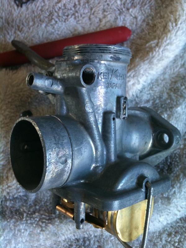

Yup the CA95 has a special carb with the power circuit. It's not the in the bowl, it's up at the top of the carb.
Its the two open threaded holes at the top in this pic.

I learn something new every day. On mine, the port that goes to the side is threaded and capped, but has a 130 jet in there.
I see the brass piece facing the rear, but I can't quite see the face of it.

Default Open Threaded Holes
Griff,
Are both these left open - nothing screwed into the orifices???

Here is a pic showing that two jets are screwed into the ports

Thanks for the great picture Spokes - and GOLD no less ;-)
Can you advise the jet sizes or numbers?

The jet in the "tube" is marked 180
The screw on the side has no hole, but behind it is a jet deeply screwed in marked 130
Sorry about the color...I was in the middle of polishing the carb. It should of appeared chrome like....
