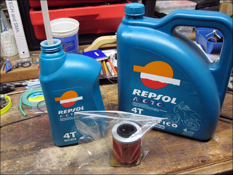

  1. Have your oil, oil filter and a new oil filter cover seal on hand.
  2. Get out your Allen wrench set (or at least the 5mm and 6mm) and some throw away rags.
  3. Grab a shallow pan and have a big flat piece of cardboard just in case.
  4. And a 10mm closed end wrench.

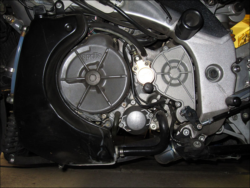

The Aprilia Mille has bodywork that completely covers the whole engine and bottom of the bike. The best thing to do it take the side panels and belly pan off the motorcycle and then go ride it around to warm the oil up. Make sure and put all the bolts and loose fittings that might come off in a Zip Lock bag so you don't lose them. More oil will drain out faster with warm oil than hot of course. It's much more comfortable to take the bodywork off of a cold Aprila than a hot one! So when you come back from a short ride on your naked Mille you can just pull up and drop the oil quickly.
No matter what I'm working on the first thing I do when changing the oil is CLEAN all the dirt or whatever from around the oil plug and the oil filter cover. The inside of the engine is the cleanest area on your whole bike so keep it that way. Dirt will mess up any sealing surface or bolt threads when you put things back together so grab some WD-40 and hose the surrounding areas off. You can also dilute some degreaser in a spray bottle and soak the grime and then brush it off and rinse with water. It only takes a couple minutes.

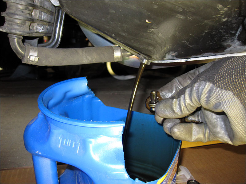

Now the easy part. Setup your oil catch pan on top of a flat piece of cardboard. Cardboard was invented to catch oil. It works great to catch splashes and it's much nicer to put your knees on compared to concrete. Take the 10mm closed end wrench and remove the oil reservoir plug.
The amount of oil that came out nearly filled this cut up coffee container 2 times. So keep the plug in hand to put back in if you don't have a large enough oil container to catch it in. I used this plastic coffee container to roughly measure how much oil came out. And it pours oil quite nicely into my oil recycling can.

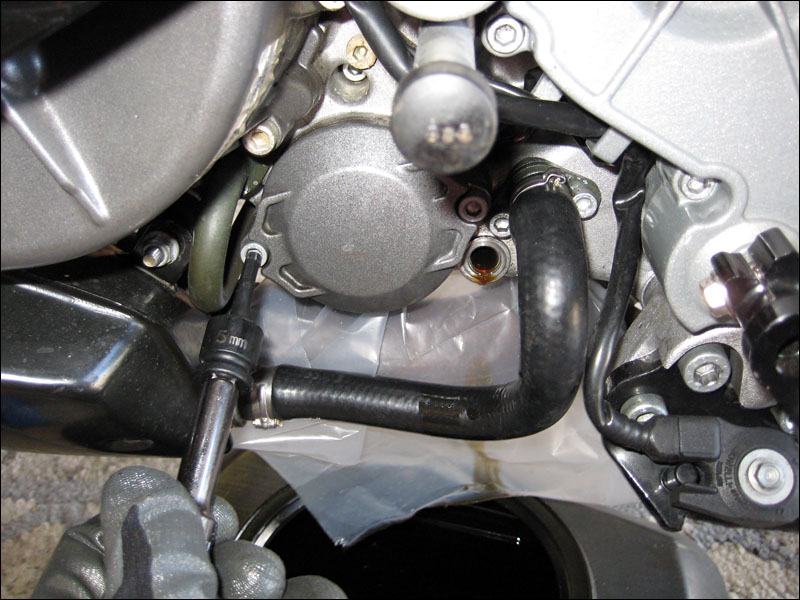

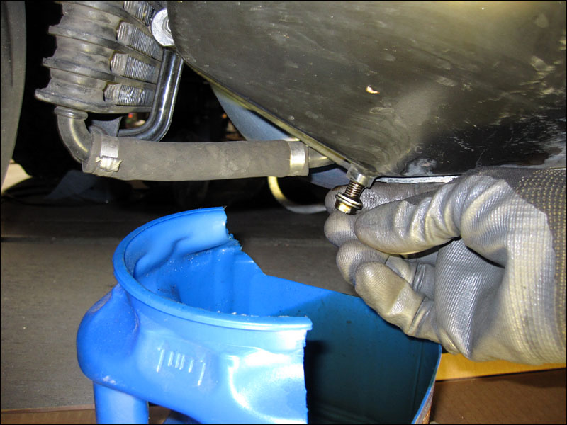

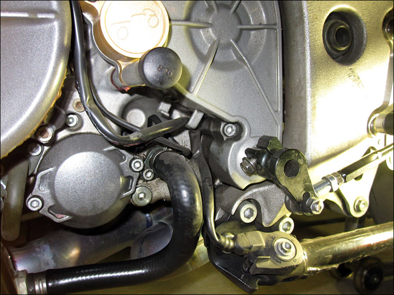

Once the oil slows to a drip put the plug back in and TIGHTEN IT. Do not put the oil plug in with your hand and continue on with your work as most everyone will forget to come back to tighten the plug! Never put a plug back in an engine without tightening it fully . Now slide your pan over to the oil filter cover and remove the bolts. The cover should pop loose pretty easily and a small amount of oil will come out. You will probably have to wiggle the filter loose with something to get the rubber seal inside to come loose and let the filter drop out.
6mm ready for the drain bolt:

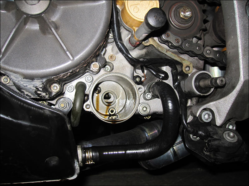

Here is what mine looked like... a little dirty from a little oil that was leaking from the oil filter cover ring that was reused the last couple of oil changes. Just order a couple new ones so you have them when you are ready to change your oil. They are a couple bucks but your engine costs much more.
The smaller 5mm for the filter cover allen bolts:

The first time I changed my oil when I got my Aprilia I didn't change out the filter cover seal. The previous mechanic probably used it a couple times because it should last a couple changes. I found that it was letting just a tiny amount of oil by at the end of the oils run. They are like 5 bucks so make sure and order one up so you don't have to worry about it. Replacing it is a no brainer. I also replaced the seal on my shifter shaft. It was leaking as well so I just popped in a new one and no more leaking, amazing.

I pre soaked my oil filter in a baggy to ensure that the oil starts circulating as fast as possible when it starts up. The oil doesn't just fall through the filter so fast either. I filled up the filter with oil and it soaked up quite a bit of it before letting some through. Just slap it in the Rotax engine and put the cover on quickly.
And here is a shot of my filter being soaked in a zip-lock. The ol Repsol Synthetic works awesome for me. Don't get caught up in the great oil debate. Just pick a type of oil and stick with it. Odds are your bike will be crashed or stolen WAY before you wear your engine out. I've never seen any street driven motorcycle engine fail from the engine oil giving up. But I HAVE seen engine seize up or get damaged from the owner letting them run low on oil.

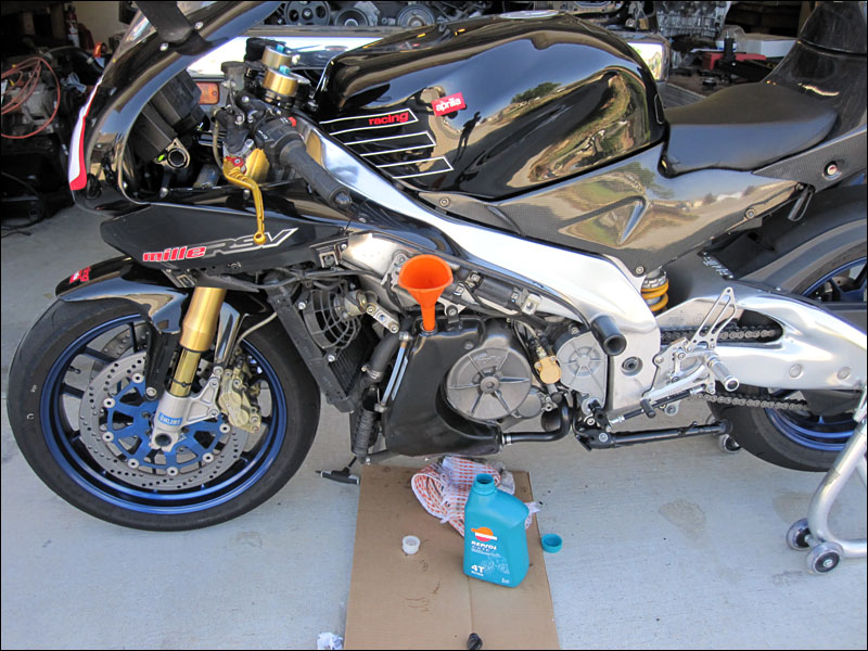

That's it, all done. Just wipe everything down with a rag and rinse it off with some WD-40 or something. Now, of course, comes filling up the engine properly. The oil level goes up when the engine warms and circulates the oil. So don't just fill up the oil to the top line in the sight tube and take off. This is what any normal motorcycle shop would do and that's why I would never take my bike to a shop - ESPECIALLY an Aprilia! Now there are some great shops like the guys at AF1 Racing but good shops are extremely rare!
Unread 10-02-2009, 07:26 AM

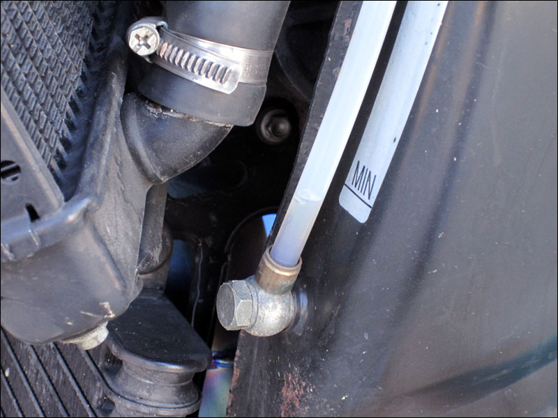

To fill the oil I typically fill the oil until I can see it just under the lower line in the sight tube. I know it will surely go up so as long as it's at that level I KNOW there is oil in the engine and I can ride it around to warm it up no problem. It's when there is NOT oil near the oil level indicators that you will damage the engine. It takes some real neglect to screw up an engine by running it low on oil so if you have half a brain you have nothing to worry about.
Unread 10-02-2009, 07:37 AM
Now people say you have to go warm up the engine and check the oil again. I have found this to not be enough! You need to really ride the bike for like 10 minutes and get the thing hot to get the proper level, in my experience. I filled the bike up after warming it up for a couple miles. Then I came back and put some more oil in it and then REALLY rode it. Well I checked my oil level again about 15 minutes down the road and it was over the top oil line by quite a bit! How annoying! I had to turn around and drain some of the oil out and give it another run.

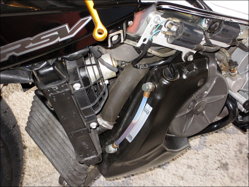

So I recommend just what I said above about filling the Aprilia's engine oil. It's easy to overfill and a pain in the butt to take oil out so take your time. I also recommend checking your oil overfill tube which comes off the throttle body on the other side of the bike. It involves just taking off your right side mid-cover and checking it to make sure it's not filled with oil. Of course, the oil comes up through the intake box and drains into this oil tube if it's overfilled or you lay it over or something.
Here is what I like to see, any higher and you'll be seeing oil in the throttle body overflow hose:
