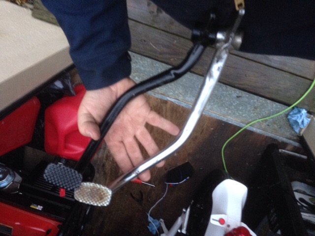

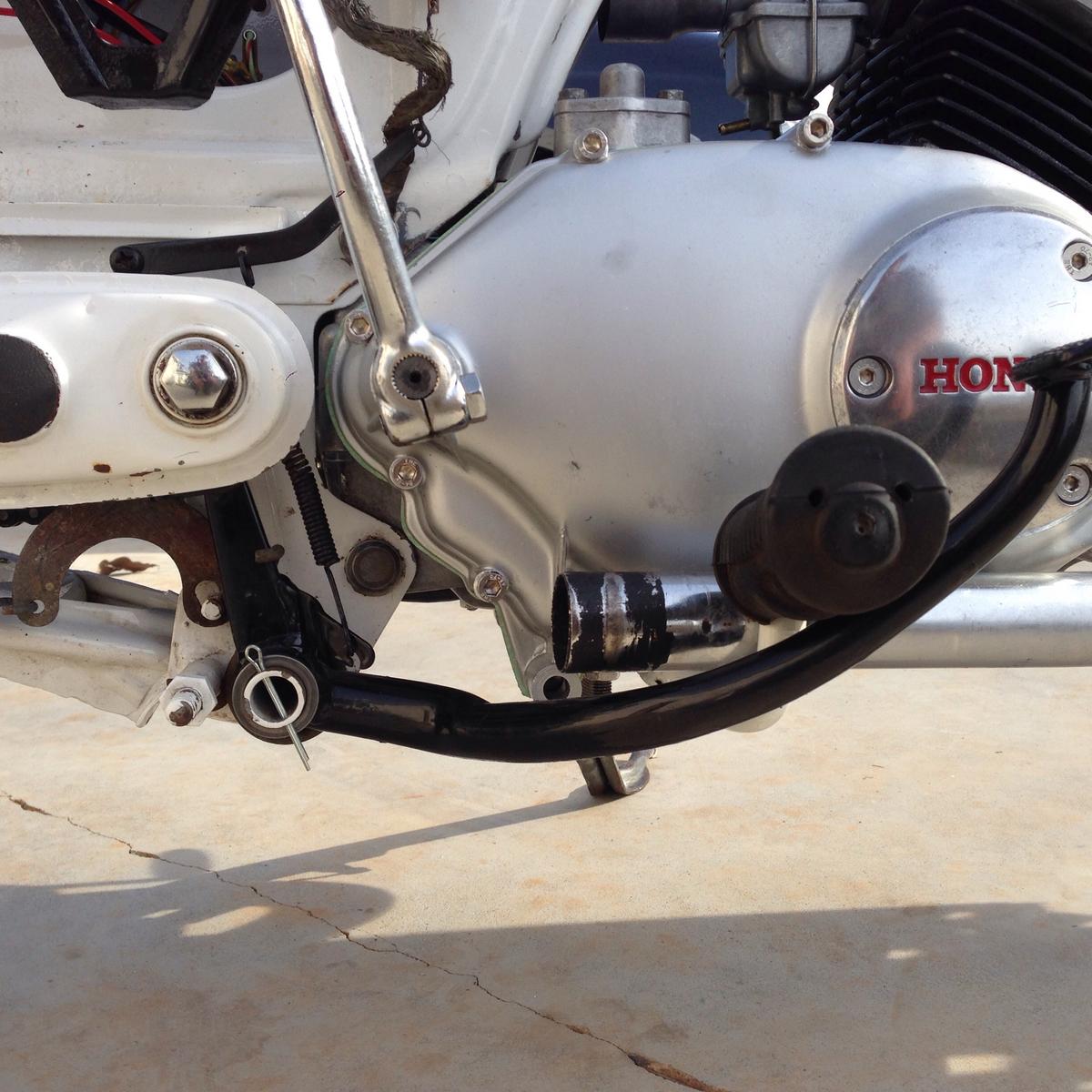

Chip, seems like you and Sam are the only ones putting input to the threads lol. I put new brake pads on the rear and now it works correctly. However I'm still battling with the pedal. I changed to another return spring I had, it didn't help. There's a crease in my pedal about a third of the way from the pivot. I think the PO may have inadvertently bent it in moving. It had some other dents and dings so this is what I'm thinking. I may stick it in a vice and try to bend it downward.
Also, the torque specs only say 5-6 ftlb on the exhaust flange nuts. I thought the flanges sat flush against the cylinder. Theres supposed to be a gap I suppose?

Great! If you will send the pedal, I don't need the rod necessarily to save on shipping. It may be the wrong pedal. Good to see I wasn't nuts trying to get that switch to work. I tried soldering the horn wire back on but I'm not very talented at that stuff. Thanks again so much for looking at it.

Well, for everyone's benefit I'll post an update here. I'm sure Chip will see it . Chip I put your reworked switch on today and it works great! I now have a horn and a high and low beam! The brake pedal was indeed the wrong one. Picture of the two below. The black one is mine, the chrome is correct. Maybe mine is from a 160? Not sure.

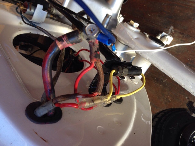

A couple more questions. Do I have the taillight wires routed correctly? The come out of the lower grommet, behind the battery, and into the opening. It looks like a pinch spot there behind the battery, maybe not. Both my wires are red (I assume they were replaced by the PO).
Just for my knowledge, what's the part number for the upper frame grommet that the positive battery wire goes through the frame? I can't find it in the parts diagram.
Where does the wiring harness bell clamp bolt to the inside of the frame? Or does it slide over something?
Is there a rearward rubber on the left muffler that the center stand bumps against? If so what's the part no? I've got one for the kickstand but the center stand is just a plate so it's hard to grip with boots on.
