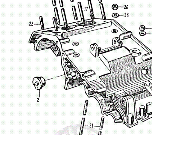

I had a leak around this area too and it ended up being a split in the sealing plug...no.2 in the attached....
Kev.

Is that the seal where the neutral rotor sits, Vegekev? I plan on this coming weekend to take a look at it (it's at my parents house currently), but from what I remember, one of those middle seals seemed potentially to have a leak (odd though since I replaced all those seals, but user error...ya never know), I want to think it was one of those clutch seals. You guys have provided me some good info though. I ordered a new packet of seals and new flywheel gasket to just re-do it all and make sure it is good I hope.

Nice! If I knew how to insert images, I took a pic of that sealing plug you mentioned. I pulled it out, and right where that groove is near the lip is a small cracked area.
When I look, it seems to make sense it leaks a little bit from the bottom of that sealing plug, drips down near the clutch seals (which made me suspect them leaking though I had replaced them), then drips down where the clutch shift shaft is and then down under the points where it drips onto the pavement.
I drove it a bunch this morning to warm it up, no leaking while running. Shut it off, it took a good 10 minutes or so before that leak started dripping onto the pavement.
I'm almost certain it is that sealing plug, so I have you Vegekev for saving the day and convincing me I don't actually suck at putting into seals and gaskets...cause I was wondering.

Chronic leak no more! Vegekev you're awesome thank you, I rode and rode for hours today and no oil leak from the left side cover. I'm pretty sure that sealing plug fixed it, just in time for winter!
