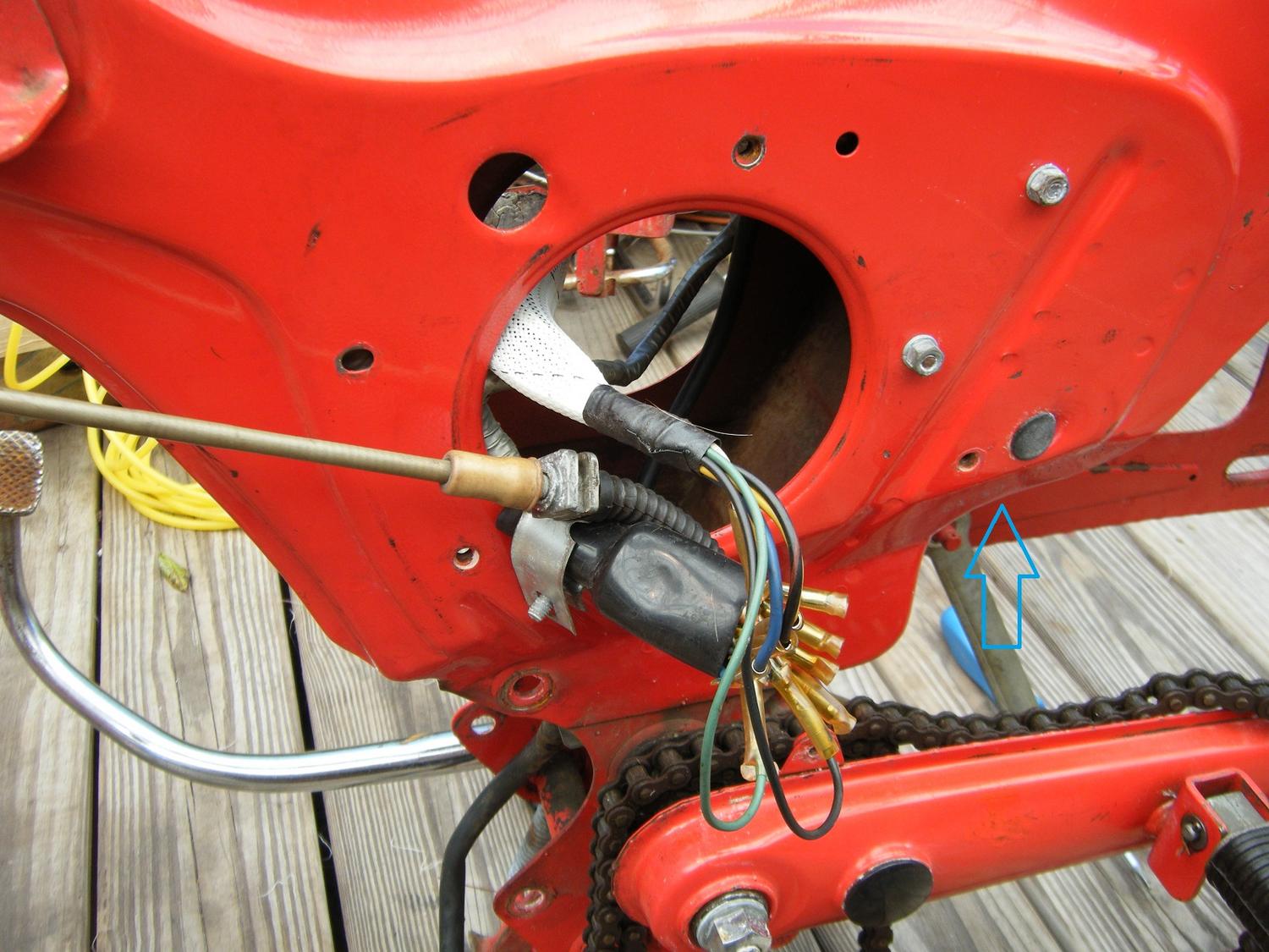

Unread 04-30-2013, 02:56 PM
A picture says a thousand words...
Hope this helps.
L

Unread 05-01-2013, 06:27 AM
mburgess00 mburgess00 is offline
Join Date: Apr 2013
Posts: 3
Thanks for the pic! Here's what mine looks like in that area...
Unread 05-01-2013, 03:55 PM
I'd have to say that isn't the best news...
Unread 05-01-2013, 05:03 PM
Yes, someone sanded off the serial number. Although there is some hope. Some states like MN use the engine number to register the bike. If you have a title and the title shows the frame number, then it could be an issue. You can try an experiment that worked for me on my current project, that was extremely rusty in that area and the number was impossible to read.
Wet sand the serial number area with 400 paper until smooth. Apply instant gun blueing (found at Wallmart) two or three coats until the metal is dark blue. Then polish the blue area with 0000 steel wool. Use a flashlight at an angle and look closely. You might just be able to catch a glimpse of the number.
Unread 05-02-2013, 07:47 AM
Here in CA I'm sure I could go to the DMV and get a title for it with a little work. I'm positive they just give you a form to write down your statement on what happened to the VIN and the history of the bike. Then they would probably send me to the Highway Patrol who does the official VIN inspections. I have seen them affix new VIN plates to frames and issue a new title to the owner. I would HEAVILY stress to anyone you talk to that the VIN was sanded off accidentally with a power sander along with the rest of the frame. They are VERY shallow when they are stamped and you could probably print out a picture of a comparable VIN stamp from one of our bikes to take in with you. They are easy to mess up when you are sanding. Because they are so shallow and the lettering is old school and hard to read they often make me go to the station to get it verified.
Unread 05-02-2013, 07:57 AM
In your case I would just go to your local DMV office and tell them you sanded off the numbers from the frame while getting it ready for paint. WOops! It happens. Then ask them where to go from there. You've had it in the family forever so it just fell out of the system. Tell them the history of it and they will likely ask you to write it down on a form and then visit the local law enforcement that handles the stolen VINs and VIN verifications and what not. It's a good idea to have the breakdown of what the VIN numbers and letters mean. I think it's in the manual somewhere. That way if they have any questions about the original VIN configuration you can provide that. They will likely give you a completely new updated VIN though. I just would have all my ducks in a row to make things go smoothly. It can be done on classic stuff like this.
