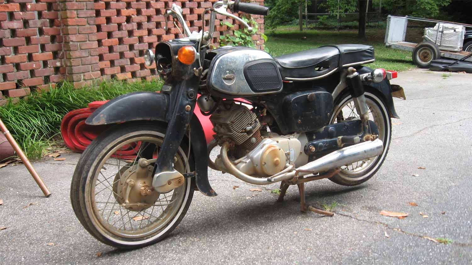

Here's a pic of the bike after it was picked up. It's complete except for headlight and rim and kick pedal. It's got 5514 miles on it with original tires, albeit dry rotted. The last inspection was New Jersey 1973, but came with a 1982 Jersey plate. Interestingly the title is a SC circa 1995, with the frame # as the ID. The engine # is CA95E5019272, frame #CA955019119, 153 apart. This fits with the 154 total apart I've read here. I suppose it's a late 1965- although titled as a 1967.
I believe the guy I bought it from took off the kick pedal because when I ordered one off of Ebay and installed it, it just spins with no contact, spins free. I was freaked that the gears were stripped and would have to split the cases. Looking through the posts here the clutch is stuck open, hopefully. This week I'll remove the RS engine cover and remove and clean the clutch and oil pump. RS case gaskets are about $15.00, I'll try to make my own. I'll for sure take pics and drawings as I took apart and cleaned the starter motor and scratched my head getting all the thrust washers back in the right place. Nightmare. Sorry for the long post, I'm windy...

Thanks for sharing the pic. I absolutely love seeing these pictures for the first time, assessing what has been done to the motorcycle in 46+ years. That frame number puts your Benly among the last 700 or so made. The CA95-5xxxxxx frame serials were sold and titled as 1965 and 1966 models. I'm not among the experts out here, but I'll weigh in on my assumptions based on your picture:
1) Probably not the original tires. The late Benlys shipped with wider white walls, so I'm assuming that at some point the tires were changed, which is likely, given the age. Still ancient tires I'm sure.
2) Are the tank chrome panels in good shape? If so, that's a big plus. Definitely the original tank badges, since only fragments remain. The aftermarket steel tank badges are inexpensive.
3) Looks like a complete chain guard ... another big plus.
4) Aftermarket turn signals were added, front and rear.
5) Front foot peg(s) have abandoned the bike. Inexpensive replacements are available.
6) Just a guess here, but it looks like some screws were added to the left side panel, perhaps to support a corroding tool tray? Not sure.
7) Carb covers are missing. Those can be a challenge to find at times, but I see one listed as new on eBay for $37.99 or best offer, plus $20 shipping from Thailand. Some folks go without.
8) Mirrors are missing, but replacements are inexpensive.
Overall, an excellent project bike, in better shape than what I started with. No rush, enjoy the project.

Kartgreen, I'm disassembling, checking, greasing and adjusting all mechanical things. Front to rear. The tank is heavily rusted inside and missing the bowl petcock, it's been rigged. I suspect whomever got the bike in SC in 1995 tried to get it running- probably did as the plugs are new looking and show evidence of being fired, but not much. They're NKG D8HA. I'll do the Works cleaning, maybe, and replace the petcock. I'll have something made to attach a petcock from Demon Cycles mentioned on this forum. Luckily I work at a aircraft manufacturer in Greensboro, N.C., the machine shop is next to our department and those are good guys. Part of the reason I bought an old Honda- I want the oldest bike in the parking lot! A guy has a nice original 1970 or so model Honda 350 I have to look at every time he rides it. Got to find out who owns it.
ByTheLake, You are my hero, that CA 95 you're restoring will be something fantastic, surely motorcycle magazines will feature. My assumption about the tires being original are because they're whitewalls and Ohtsu brand, also the mileage. My '73 Jawa currently has the original front tire, Barum brand, of course new tube and rimstrip. It had 3106 original miles when I got it, maybe 3500 by now as the speedo doesn't work now. Interestingly the side cover on the CA has factory holes with rubber inserts, for what reason escapes me. I'll upload a pic tomorrow. Sure wish the tools came with the machine. The turn signals were obviously added- surely by the dealer who drilled holes in the headlight cover and holes in the rear fender. They were run nicely thru channels at the rear underneath the fender on the other side of where the tail light wiring runs. The only reason I think dealer is the switch on the handle bars is Japanese looking JEC brand and the turn signals are made in Japan Stanley. I'll not have the signals again so if anyone here wants them, with the indicator relay we can talk trades...
