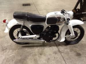

Up north of boston(title needed an explanation), I discovered this one.
tires were flat(one was original?). the seller said the "carb needed some adjustment" and overall a little tlc.
dragged it to my driveway, fired up after some kicks and the electric. then....nothing.
so new battery, new plugs, new needle and jet in the carb, new tires, and finally life. but only when jumped.
took off the case for the kick start, put it back, now that works after a couple kicks when its cold.(it just slipped with no compression before) but i didn't do anything except change the oil.... anyway, took it for a drive and now I'm getting picky.
so the right boot for the spark only fires when it is slightly ajar. this is an easy fix BUT.....
the carb overflow is leaking a fair amount of gas. it has been. apparently there is a small brass tube in the bowl. regulates overflow. well supposed to be. there is nothing in there. its not listed in the parts or manual or anywhere. but it should be there! where do i get one??? anyone have a pic or measurements so i can make one??? my friend says this is never going to be a reliable ride, but i totally disagree. under 5k miles, feels great, sounds...ok -missing that sewing machine sound. but overall i think i got a good bike.
and the electric start...
button is missing. well, broken. no big deal there for now. once i put the new points on, if its still not starting on that, could it be the ground cable? going to experiment a little tomorrow.
so for now, ANY help about ANYTHING on this bike is appreciated. thanks in advance, i will be back here way too much in the future.

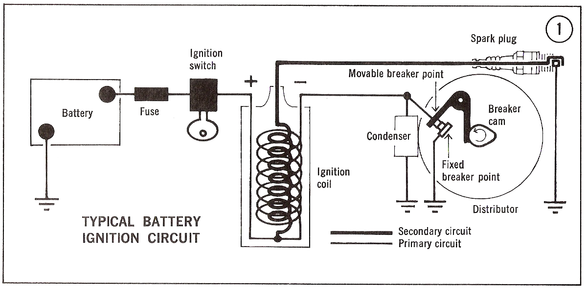

I hate to ask, but as a former technical support person I have to clarify some things in order to give better answers.-
Statements like- "but if i don't get any reading out of the coil" make me ask what "reading" are you specifically looking for, as opposed to "I measured the resistance of the primary coil and it was "x"".
Which tests have you actually done and are they done correctly? I only ask because I don't know your skills but I do know most folks have a little trouble with electricity. I've actually taught the subject to aircraft mechanics and can post a whole treatise on what to do and how to do it. I just don't like to push.
Basically you need to first understand what the coil is and how it does what it does. Its called a coil but is actually two coils called a transformer. If you think about it, it 'transforms' your 6 or 12 volts into 20,000 to 50,000 volts at the plug to make the spark. It does this through a process called 'inductance'. That's another lesson though.
The two coils consist of varnished wire coiled upon itself and wrapped many many times.The two coils, the primary coil and the secondary coil, must be electrically separated from each other in order for 'mutual inductance' to occur. Also the number of windings in each of the coils determines the amount or ratio of transformation of voltage (12vdc > 20kvdc). If the two coils are touching each other, or if the varnish wears from around a coil winding (due to Spokes' overheating reason) internally the coil can no longer set up the magnetic field (part of inductance) required to work. If this occurs the coil is "shorted". You'll find no magic, nothing special but varnished wire (and in older automotive coils some oil for cooling). This is why we test the coil by measuring the resistance of the length of wire used to make up the primary coil.
The Breaker points are simply the device that breaks or collapses the magnetic field that occurs in the primary coil and when that magnetic field collapses it 'induces' (thus induction) a stepped up voltage into the secondary coil which then continues on to the spark plug.
As Spokes points outs, leaving the key on and having the points closed just turns the coils into a heater and melts the insulating waxes and can get hot enough to melt the varnish on the internal coil wires eventually causing a shorted coil.
In general if the coil primary is good (measures 2-5 ohms of resistance) then proceed with further tests. This primary coil resistance test must be done with the coil assembly electrically isolated (unplugged from the rest of the circuit) but can be done while still on the bike or on the bench.
The attached diagram is from my Clymer's and the procedures they use are are not bad (though some manuals have bad data)- good to have on hand.
Sorry if this seems too academic, just trying to help.
Larz
