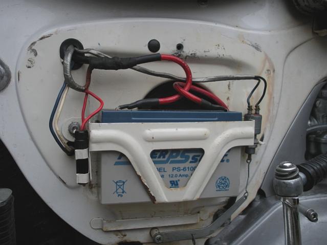

i've only used it for a couple months, but the specialists at the industrial battery shop that have extensive knowledge on the subject assured me these were far more durable and lasted longer than the original units. here it is, wired up:

Very nice installation, I am a union electrician and I appreciate clean work. You heat shrank all the connections and sized up the wire. When you tied the original wiring in to the new positive lead, did you ring and bolt that connection or use compression connectors?
Looks good.
Did you fellers realize there are only three battery manufacturers in the world and they just label them according to customers? Kinda scary thought aint it?
All this battery advertising is pure bullshit. Poor NASCAR sponsors....

after digging around my bin and coming up short, i just clipped some metal off an old hose clamp to make a crimp connector and then soldered it. i was out of heat shrink in that size so i used friction tape. i was a vw mechanic for a while- fixed lots of bogus wiring and did many engine swaps requiring extensive rewiring. i could wire a car from the ground up but am terrified of AC. i've had such crumby luck with other bike batteries i figured i'd give this a shot. so far so good.
