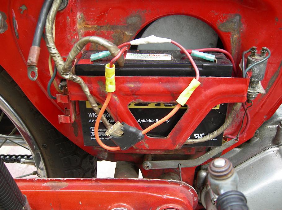

Ok, i'm totally lost. this is my first bike and i'm not sure but the battery in the bike does not seem to be the correct one and it looks to be a bit rigged...
There should be a picture here of what it looks like.

Oops forgot to mention that this is a 1963 Honda Benly CA95, 150cc.
The pos/neg wires seem to be permanently attached to the battery as you can see, and the black ground wire over to the left with the loop on the end isn't attached at all...

So the black battery is the one that is in there and you have the clear yellow top battery to replace this with? The black battery is a Sealed Lead Acid type (SLA) that is for common uses and not automotive specific. These are used in all sorts of applications like lighting systems and gate openers with solar panels attached to them at the end of long driveways, power back up systems... etc etc. The voltage is correct but the amps (known as cold cranking amps in automotive terminology) which is the actual power discharged from the battery is the only thing that might separate this battery from a traditional motorcycle battery. The connectors are just blade type which have a small contact area that is easily corroded because it's not being used indoors in a nice environment like where most SLA batteries end up. So with the cheap blade connectors having such a small contact area that setup won't stand the test of time nearly as well as a regular nut and bolt battery connector.
But the SLA batteries are very attractive and price and they can work as long as they provide enough amperage. I can't tell from the picture. On the other hand you wouln't use a traditional auto or motorcycle battery inside a house like you would the SLA. They leak a little and are high amperage which means they unload lots of energy quickly, need higher quality connectors and can spark and heat up if used for more than a short period of time. SLA slowly release energy, less heat and less of a chance for sparks and such.
Ok just some basic Honda electronic facts and suggestions - I'm just going to go through this to hopefully make it simple for anyone to understand. I'm not trying to insult anyones intelligence - just going to give some advise so most everyone reading can benefit I hope. :-I
The connectors in the picture were put on the smaller wires which were then adapter to the butt connectors so they would attach to the large wires. This is just not optimal as there should be large wires to the larger eye shaped connectors that should be bolted to the larger battery terminals of an automotive/motorcycle type battery. This way the larger wires can carry the larger burst of energy (from the traditional moto battery) required to turn the starter. The connections from the old Honda taped wire to the newer red wire causes resistance... as well as the butt connector and then the connection to the blade type connector. All these connection inhibit the flow of current from the already low amperage battery. Amperage is current of course.
Anyhow, the blade connectors pull right off the little tabs that are on the top of the battery. Just grab the wires and yank them off while wiggling them left and right. Then you want to get a BLACK wire for the ground on the right of the battery. Honda and many other cars and old bikes use a large naked braided steel cable to connect the battery to the frame. This is because the whole frame is the ground so it doesn't matter if the negative cable is protected or not. It just has to be larger than what you have in the picture and the bolt that secures it to the frame should be clean and also the part that the cable connector touches on the frame should be free of paint and dirt of course.

Honda and most old bikes also used a cylindrical glass fuse that was held in a small round black tube. This would go on the positive battery wire and be placed in the clip that use see on the left side of the battery holder. These can break and finding those types of fuses takes a little more effort. Someone probably used a common blade type of fuse because its easier to find and might look better to some. I think thats a 25 amp fuse judging from the picture which is way too high. This won't protect the curcuit well because there are electrical components that can be damaged with less current than that. The correct fuse is 5 or 6 amps which is very low. Then why do I make a big deal of using larger battery wires and ground cable? Well the amps is so low but the connectors in the picture and the smaller wire just diminishes the energy which is already low to begin with.
Also pull that black cable with the eye connector on it on the left side of the picture. See if it just falls out or if it's connected to anything. That looks more like the positive cable that should be attached to the battery.
The black SLA battery might work but because it's possibly designed for low amp output that means it will only accept a low amp charge which means the battery won't charge up nearly as fast as a standard moto/auto battery. So when you fire up the bike and discharge the battery doing so... that when you ride to the store or gas station and shut it off - the SLA battery might not have accepted the charge that it was provided from the engine charging circuit. But a standard battery gives off power quickly to start the engine and then accepts a charge quickly so that it stays charged.
I just buy the regular batteries and use the regular cables or make new ones based on what Honda originally designed. Even the cheap Chinese scooters don't use blade type connectors and small gauge wire like that for the batteries. And those are the cheapest machines out there on the roads. You can use that fuse holder with a lower amp rated fuse without a problem. But we'll show you how to get some regular terminals on there so that you can use a proper regular battery.
