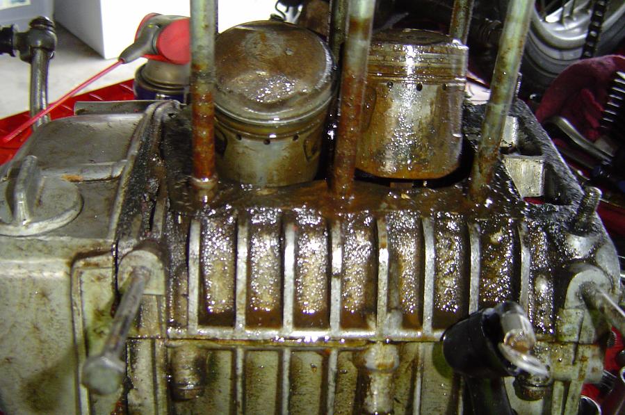

well i got the pistons out and the only numbers on them i can see are on the sides ...A951360 im assuming its a part number. this if it works is from lastnights drunking moment. as you can see i spilt oil everywhere ..opps

Have you messed around with the engine rebuild lately? I hope you cleaned it up a little at least! haha
