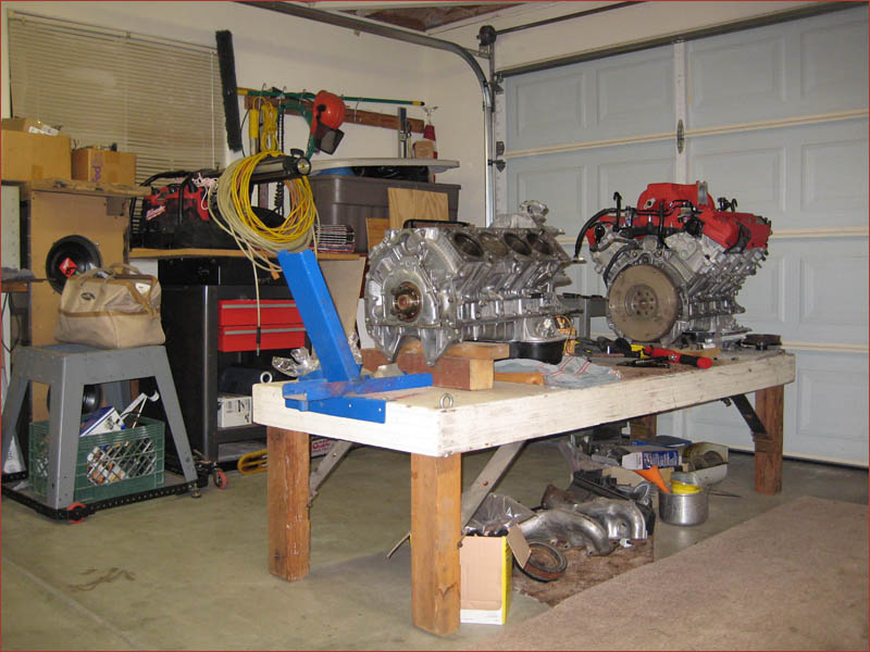

Alrighty, I took a couple short videos of me beating on the 2.7L engine for just a little while longer tonight. Then I backed er into the garage and dropped the oil so it could drip all night long. Then in the morning I'll have the transmission out in no time so I can start making the adapter template. Then it will just be a matter of time until I get my headers in the mail and the steel adapter is milled out.

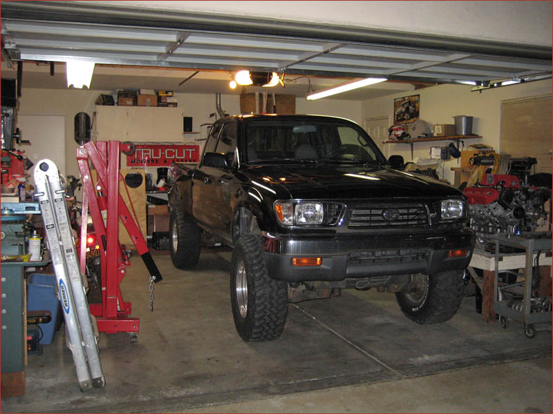

Unread 02-12-2009, 11:01 PM
Good day, I made some progress indeed.

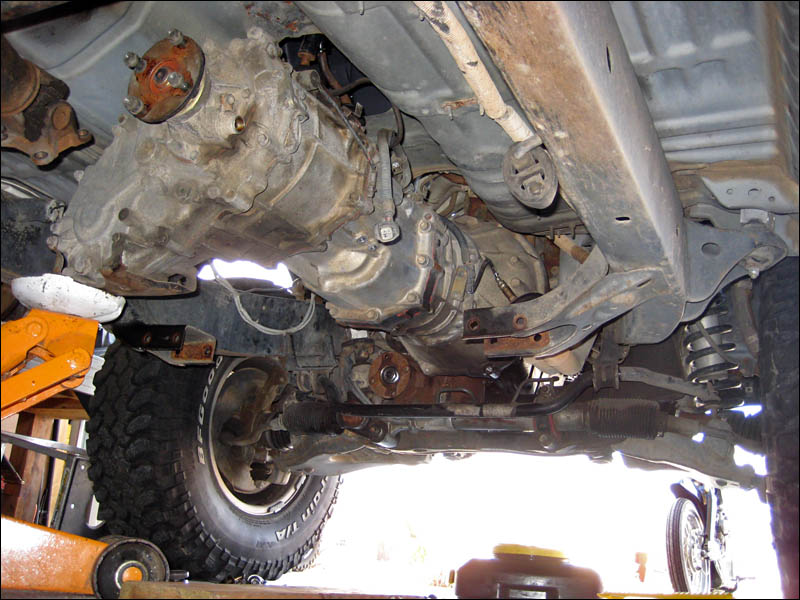

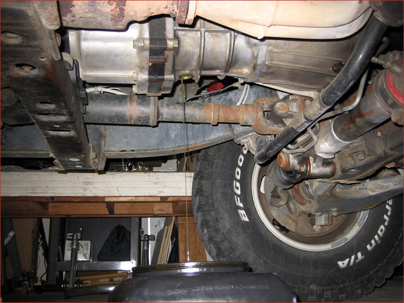

I LOVE my small bodylift. It's the only way you can clear larger tires on a Tacoma. Plus it gives you all sorts of room to work underneath the truck. Check this out. With the tires, suspension and body lift I don't even have to jack up the truck to drop the tranny/transfer case. I also ripped off all of those lame heat shields a long time ago so it takes an hour to remove the whole thing now.

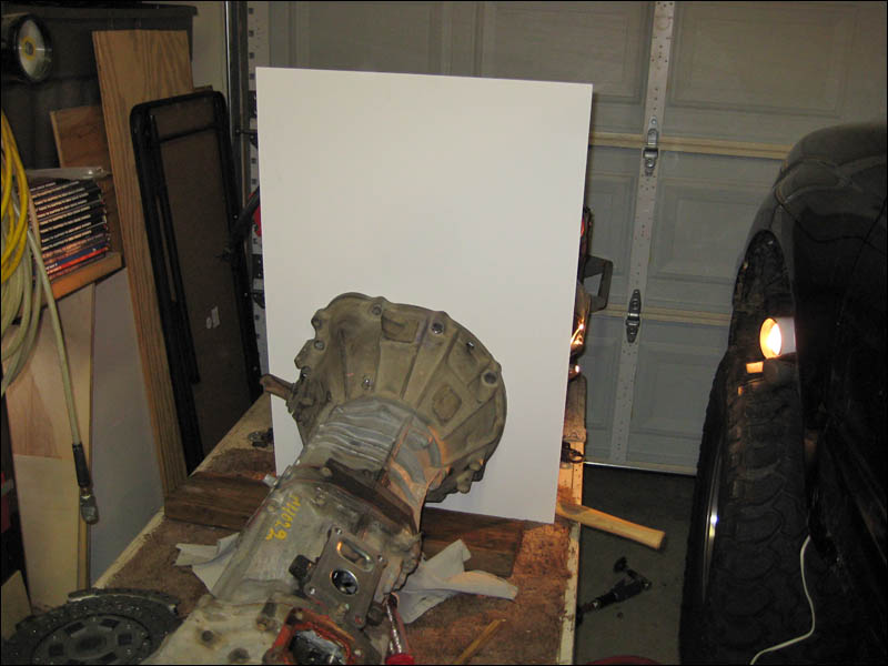

And here we go! I'll just bolt them together and I'll be in business.
Don't get all upset I'm just kidding. Here begins the tedious task of creating the adapter template. Then I'll be knocking on my neighbors door (multi-national precision engineering company) and he'll make sure that the tolerances are spot on when the adapter is water jetted and machined.

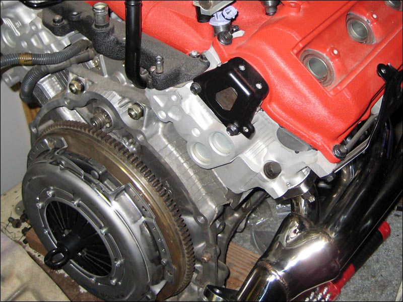

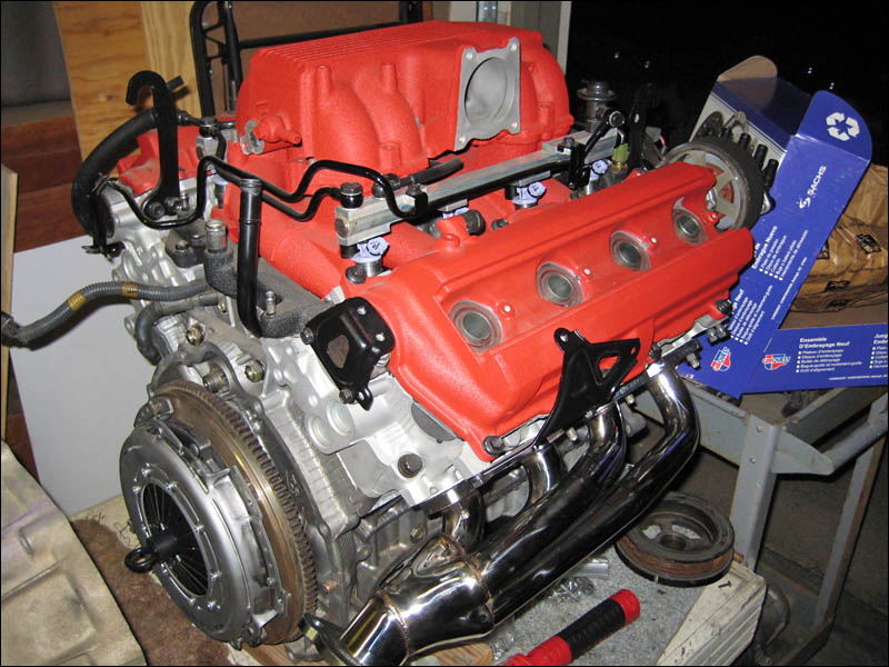

Unread 02-13-2009, 04:10 PM

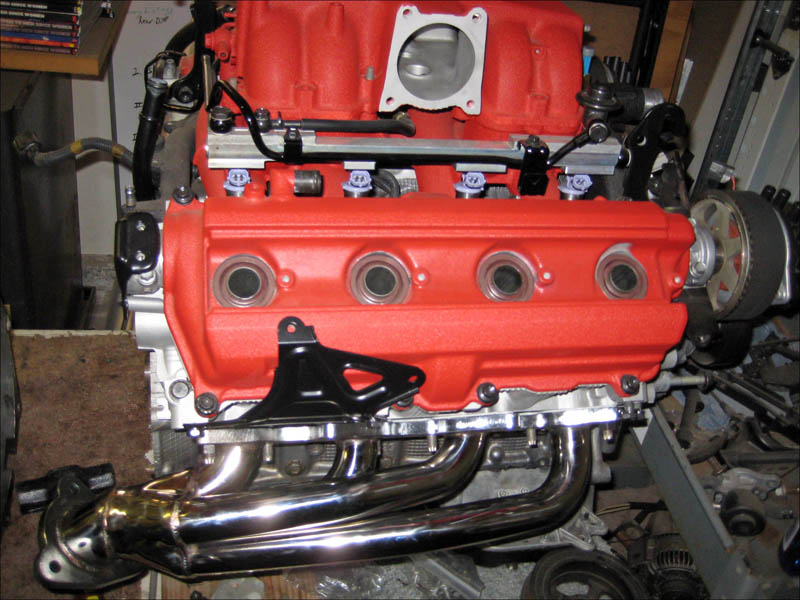

I don't know how I got so lucky but I got some new headers in the mail today! Wow I think they will bolt on and just work like they are. I have some detailed pictures I'll post later on but for now here is the new hotness:
Thick ol' flanges on these things too! New bolts and gaskets to boot.

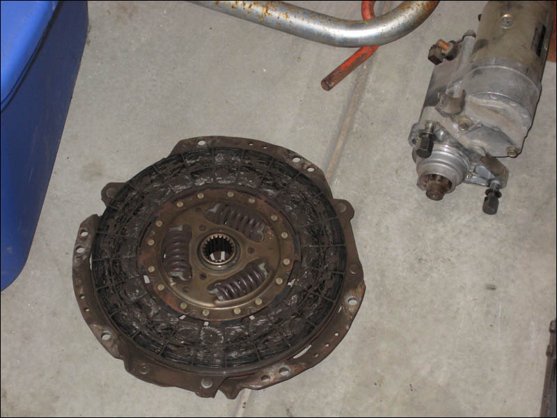

Unread 02-14-2009, 11:22 PM

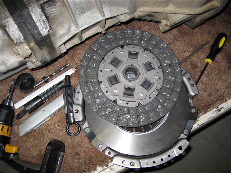

Ok I promised myself I would make progress every single day on this build until it was done. Today I picked up the correct clutch and it's good to go. It's quite different than the 3RZ clutch. The clutch that I put on the 3RZ is an aftermarket and I STRONGLY suggest that anyone replacing their clutch on their 3RZ use a TOYOTA clutch ONLY. I have a friend that hated his big "name brand" heavy duty clutch and this one that I got with the flywheel had some chatter in it from the start... mainly when colder but it still just never worked as well as the ones I got from Toyota.
Old worn out 3RZ Clutch Disc
Old worn out 3RZ engine! Ok well not totally worn out but showing it's age. Still kicked butt.
Unread 02-14-2009, 11:25 PM
Fresh new clutch, check out the rubber isolators... interesting.
Just placing the clutch and flywheel on for reference

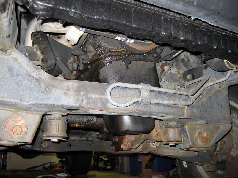

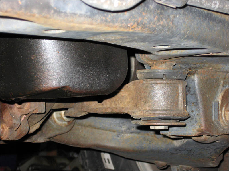

Here's a good reason to yank the 3RZ engine out. The main pulley seal is just drooling a bit of oil from time to time. And the main oil pan gasket is surely leaking. Not more than a drip or two here and there but the oil really attracts the dirt. Not looking too good. But like I said the engine still runs just great and it's not like I had to keep checking the oil. It doesn't use any oil at all. Toyota builds some really great engines.
I would say that my front diff bushings all need to be swapped out. Now would be a great time to do this while the engine is out.

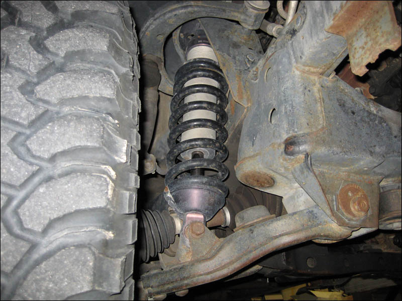

Unread 02-14-2009, 11:34 PM
The rebuildable Donahoe Racing shocks are the best money you can spend. They shafts are so thick and the shock body is so long that when I want to lengthen them all I have to do is send them back and they will put a longer shaft in them! How cool is that? The spring rate makes for a very tight ride but when you hit a jump or some woops they will take them over and over again without breaking a sweat. Best shocks you can buy for the front of your Tacoma. These are the exact same ones they ran on the Donahoe Racing 7S class winning tacoma.
Like I said I think the shocks would feel a bit more compliant with the heavier V6 engine which they were designed and tested to accommodate. That said I am SURE that they will be PERFECT and provide a better ride for the Lexus V8. I can't wait to see how they will feel with the added weight. I am pretty confident it will ride smoother on the street.
Unread 02-14-2009, 11:39 PM
A very smart engine builder built a dry sump 1UZ with all sorts of racing goodies on it to test out in an open wheel race car that was going to be the basis for a spec-class racing series. He said the stock cams were good for 6,200 rpm before they stopped making horsepower. They will pull a bit higher revs but it's pointless. When I put together a binder of pertinent 1UZ information together to hand to my engine builder I made sure to put one of the best looking 1UZ pictures on the front of it. Good for inspiration.

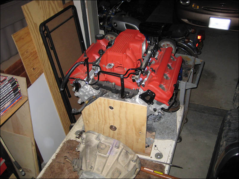

Unread 02-17-2009, 12:20 AM

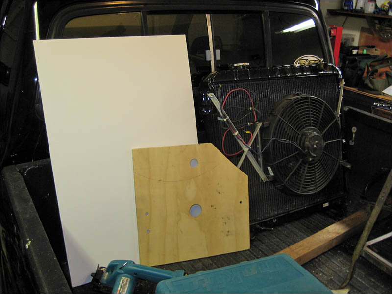

Ok have a look at my new W59 transmission adapter!
So it's not actually THE adapter but it's the template material. It's 3/16" foam board stuff. Now I just need to begin reverse engineering the castings on both sides of the "adapter".
