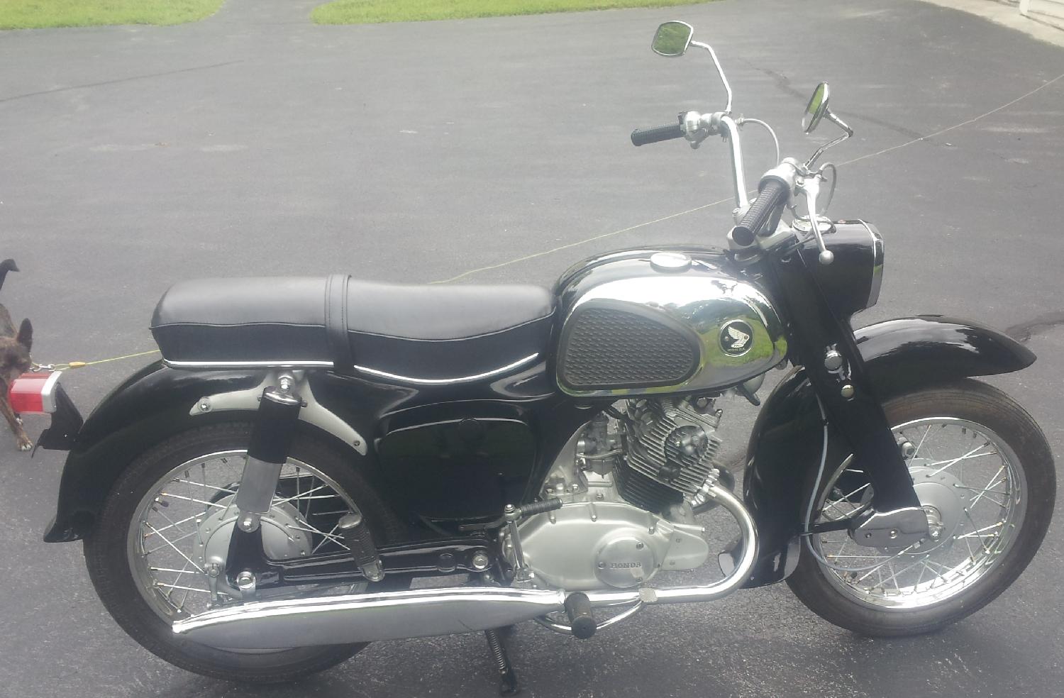

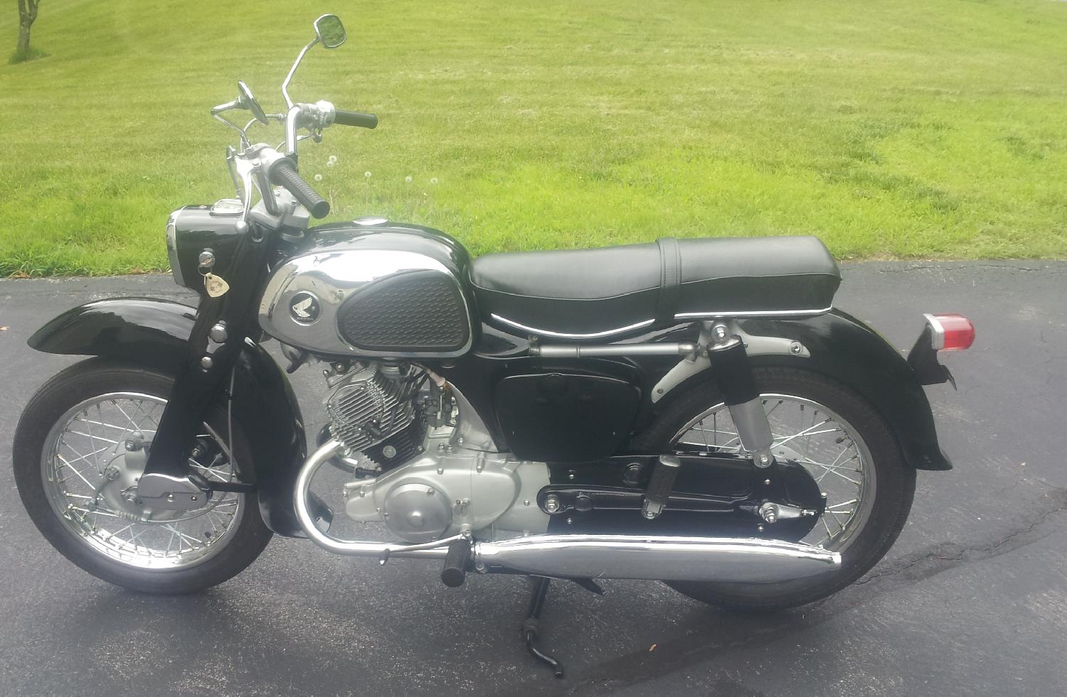

Finally finished my Early 63. Started in 2 kicks! Took it out for a few laps around the neighborhood. What a blast!
However, a couple of problems.
Original petcock leaking at the bottom of bowl. The nut part was butchered up pretty good so I had filed it to clean it up. Must have gone too far. No problem however as my friend will seal it with aluminum weld. He already has it. I will get it back tomorrow.
The other problem is probably minor. (I hope) The engine idles great and revs great. But, when I rev the engine then close the throttle, the engine revs (surges) for a split second, then drops back to idle. This surge is driving me crazy. I checked to see if there was an air leak, but that diesn't seem to be the problem. I changed the gasket, the insulator block along with the O-ring on the carb and checked to see if the flange on the carb was warped but it is not.
Any ideas?
Attached are some pics. The seat cover was changed to the correct one after I took these pics.
