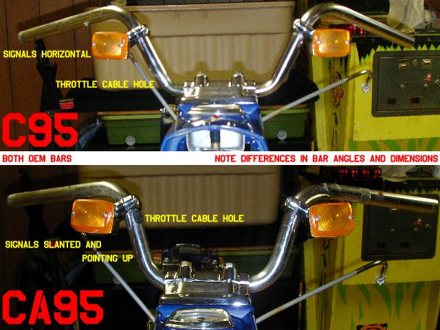

My original C95 handlebars are bent and welded thanks to my youthful inexperience (and a patch of black ice). They're usable, but I'd like to upgrade to new(-ish).
I've got an original set from a CA95, but those bars are different. They don't have the holes for the signal lights, and the throttle cable hole is in a completely different location. Those problems are seemingly small ones since it would be a simple task to drill two holes for the signal lights. But I did a "test mounting" of the signal lights before doing that, and discovered that the slight angle difference of the two bars makes the signal lights sit at a slight angle, which I know would bug the hell out of me.
So, back to eBay to source handlebars. I haven't seen original C95 bars come up lately, and notice the reproductions from Thailand come in the two different flavours, so one would be wise to double check this before ordering.

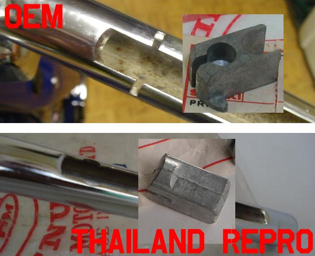

I also note the reproductions use a slightly different throttle cable holder with a wide notch mounting system instead of the narrow notches that my OEM has. Again, no problem since this can be sourced out of Thailand as well.

The bars on your CA95 are bars from a Honda 90 Trail bike, 64 or 65 (IMO). I have purchased the trail 90 bars in the past. The newer bars have the oval cable stop insert, which may be an improvement over the slotted type.
I have seen the Thai bars and they look the same angle, but I did not actually measure them.

If I did not have a couple of original bars waiting to be chromed, I would buy the Thai bars and the oval slotted stop.

Honda 90 bars. Humh, that explains a lot. They came off a CA95 being parted out, but I guess they themselves were transplants from some long ago story.
