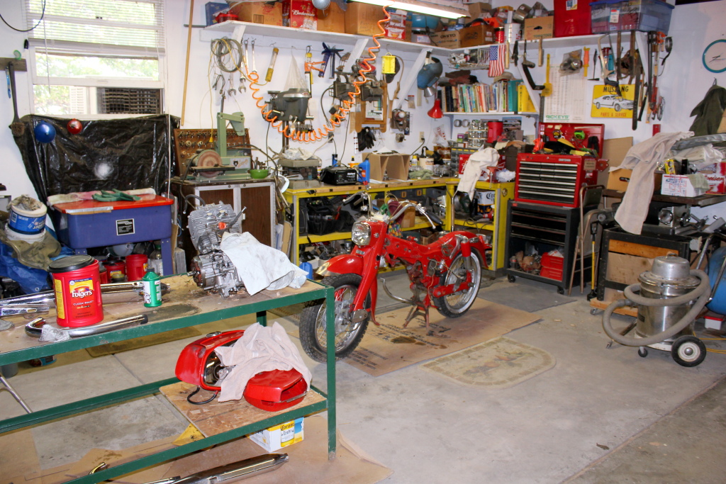

Rebuild restore update. 8/8/12
There has been progress. So far it’s going good. No major rust or mice nest.

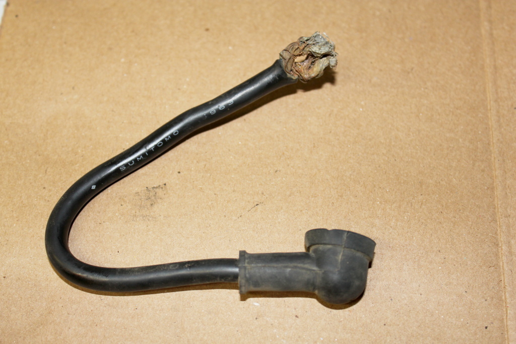

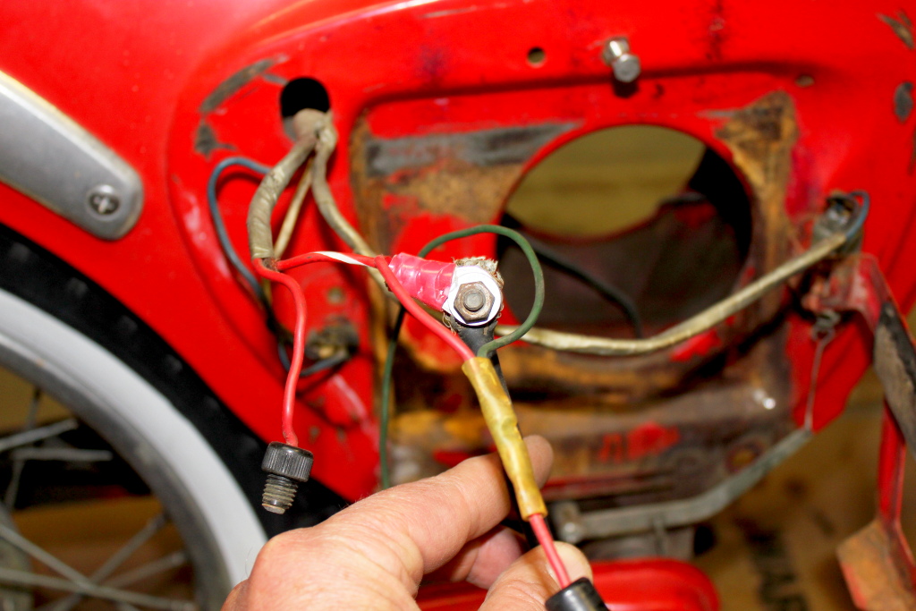

Some small wiring issues. I think I’m back to original state now. I love finding the date on the wires. I just think that’s really cool. I have no idea why it was done. Maybe there was a midyear change? I’ll keep as much of the old wire as I can.

Yep you gotta get into these bikes deep every time to correct fixes that were done by previous owners. That's just how the world works. Every one just patches things up. Jay Leno can tell you the same and tell you the story behind every single auto and bike he's owned. Thanks for the pictures and story. That wiring looks haggard haha. But it works and that's why it is what it is. I love the wiring on these bikes... so simple! I want to do the rectifier upgrade on my blue 150 sometime soon.
Time for a bike stand! You can get those things for like $150 now I think. With a hydraulic pump that lifts the steel platform up a couple of feet. I think they just take up too much room when we aren't using them but heck - I would have a project on mine all the time anyway. I have a sturdy old fashioned wooden stand myself. I collapse it and lean it against the wall a lot of the time. I'll start a forum thread for bike stands and shop stuff soon I think.
