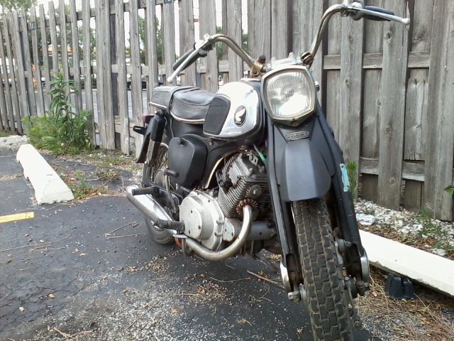

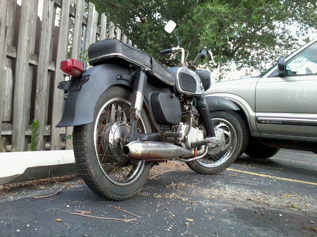

I just got my first ca160 about a week ago!! It runs but needs to be restored.... I will post some pics as I start the process of getting her street ready (safe)...

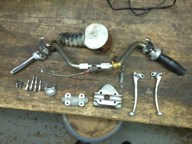

started on the handle bars, cables were cut, rewired and cleaned up the aluminum...

Welcome aboard, there's a post Spokes made a little further down on parts sourcing, the pipe pictured doesn't look in too bad of shape...they are super hard to source as far as originals go. Flat black doesn't really fit these I don't know what the PO was thinking, these bikes are designed to shine.

Thanks Everyone!!! Yes I am going to start looking at the harnes first... I am thinking of just ordering a new one since they are somewhat cheap. I already rewired the handle bars which were a mess... The wiring seems to be all there in the rest of the bike but we will see.

the handle bars.... rewire, clean polish

Actually you have a CA160....not a CA95
The CA160 is the same frame but has a more robust engine. So when your buying a wire harness and engine parts, make sure it's for a CA160. I actually like the CA160 best IMO
Unread 06-28-2012, 04:09 PM
Yep, CA160 for sure, and the Honda winged tank badges are flying in reverse, so they need to be swapped to the opposite sides of the tank.
Nice bike with plenty of potential.
