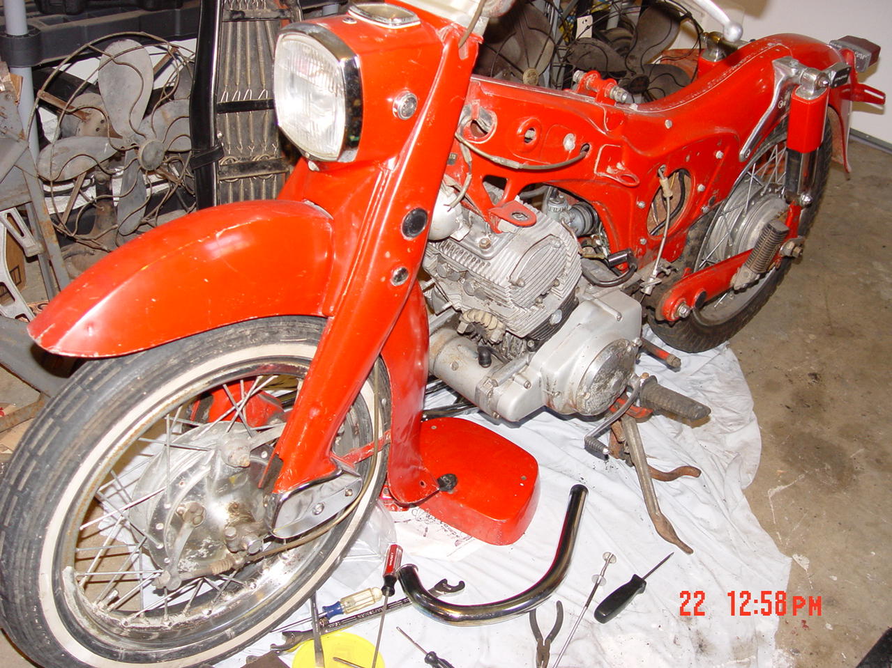

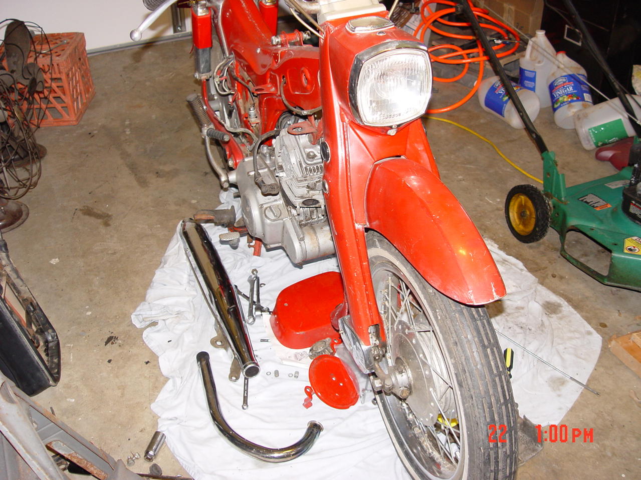

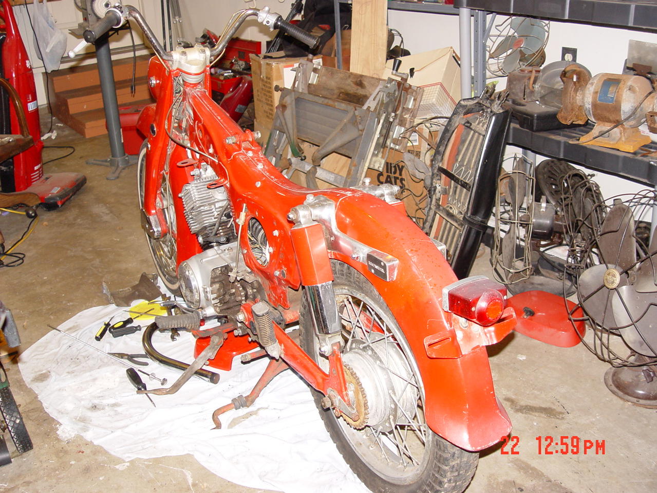

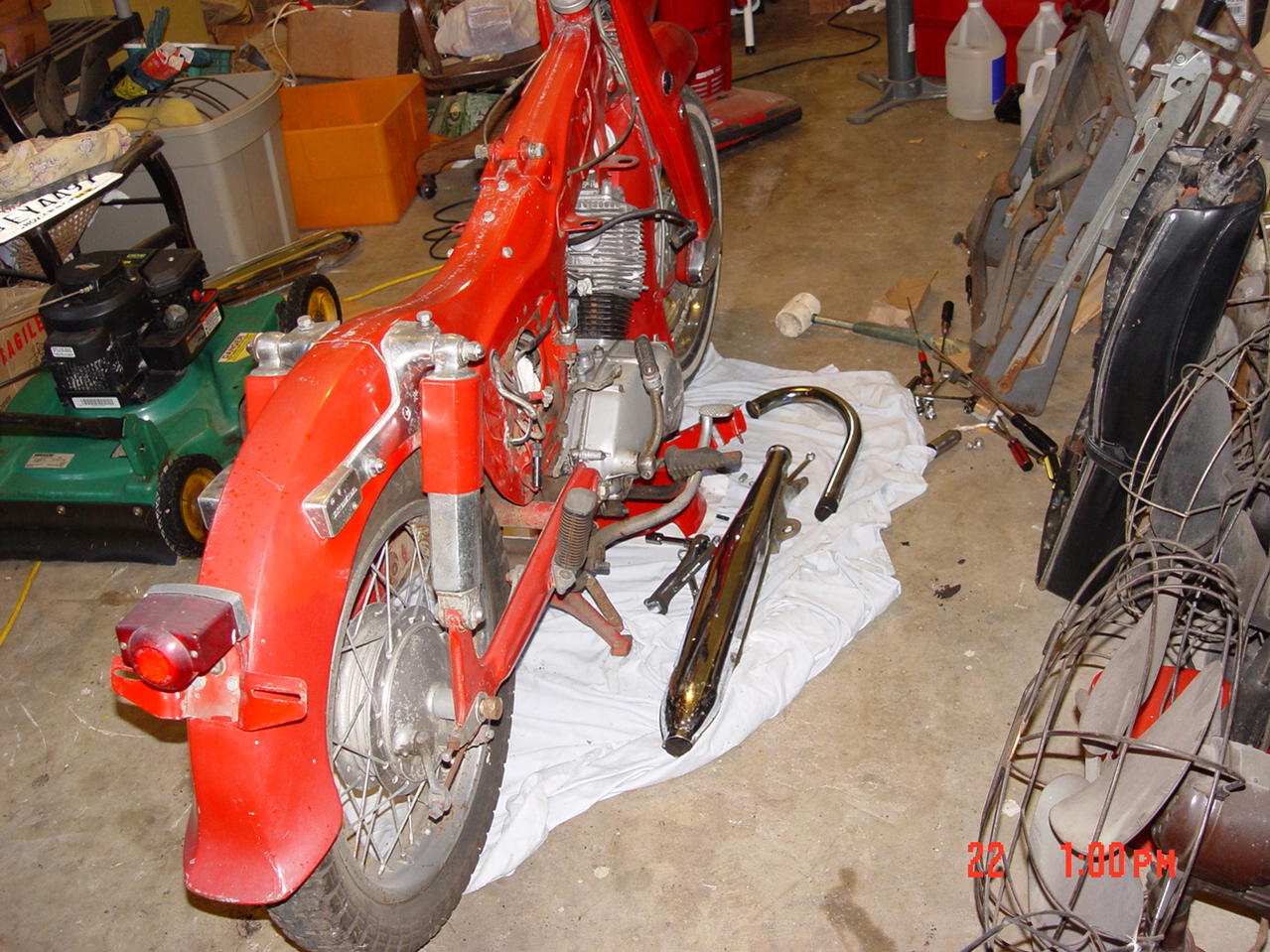

Four photo's of my Benly, need help posting.
I have four photo's of my CA95 that I took this a.m. before I removed the rear wheel, as per "By The Lakes" very accurate instructions. Thanks to his and everyone else' help.
Is there someplace on this site or anyone reading this who can instruct me on taking the four images off of my "thumb drive" from a computer remote from my home and posting them on this site? Thanks, Dick Evins |
#10
Four photo's of my Benly.
I hope these get posted. If not then I will have to say that I'm at my wits end in trying to post the pictures.
#11
Your wit can relax, the pictures look good. Nice bike.
