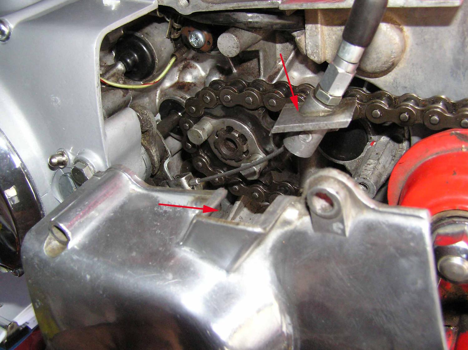

ok i need more help, not sure how to address this
i connected the clutch cable and tried to put on the case cover but no can do. the Clutch Cable Joint doesn't match up to the case? not sure what or where to adjust the cable to fit?

Default
If I understand what you're trying to say the cable flange (RH arrow) just sits on top of the cutout on the case (LH arrow). If it doesn't you'll have to give some slack at the lever adjuster and/or finagle the cable where it comes out of the hole in the frame. If that doesn't work at all the cable may be too short. I used a clutch cable from a "High Bar Kit" on eBay for my clutch and throttle cables but the front brake cable was too long so I used a regular cable for the brake.

Default
Tks for your reply
This cable is the same one I had when I removed the engine for a rebuild
It doesn't move high enough to fit the case?
Should I remove or adjust it from the handelbar hand lever?
Can i loosen the clutch adjuster bolt and turn the adjuster with a screw driver? Not sure how it would effect the cable?

Default
Lou, it slides in from the back then goes on as one unit. It won't go in if you mount the cover first.

Default
Tks but when I try that it seems the cable is to short about 1/2" - 1"
I can't get the cover far enough past the side cover to put in place?
So I thought there might be some sort of adjustment I could make that would give me some more length.
am I supposed to connect the clutch cable before putting the case on? I see there's a peep hole on the case is that for visual inspection only?

Default
Make sure both ends of the cable adjusters are full backed fully off and both ends of the outer cable sit in the adjusters and are not hung up.
In your picture the outer cable looks bigger than the adjuster that it should fit into. Just because it came with the bike, it dosen't mean it's the correct cable.

Default
wnbasac~ You can loosen the bolt for the clutch adjuster and use something (I use a round spark plug gap guage) to turn the adjuster in the appropriate direction to give slack as you asked. That should do it.
