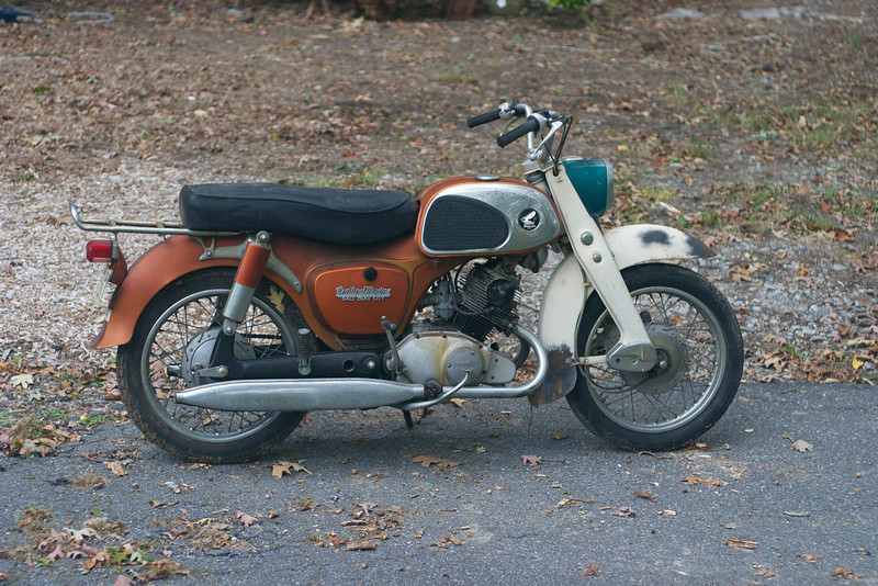

I bought her from a nice fellow last week. She is from utah, last registered in 1976, and appears to of been stored inside most of her life. Yesterday I worked on cleaning all the rust out of the gastank. That will probably(hopefully) be the biggest issue I face with this project. The petcock internals are pretty eroded too. I removed the carburetor expecting a mess, but was shocked to find it in immaculate condition. After searching all over for a battery i finally found one online and ordered it. I need an air filter, but I really dont want to pay the hefty fee for the ones on ebay. If one of you guys have an extra and wana sell for cheap, I would definitely be interested in buying it from you! Hopefully O can salvage the tank, because a good orignal one costs about what I paid for the bike. ($450)

anyways, here is a picture.

The bike looks good ... an "early" CA95 from what I can see, with the shorter rear fender braces. I really like the original dealer emblem on the side panel ... that adds some authentic history to the bike. The gas tank emblem has been messed with, as the Honda wings are flying backwards.
Red body ... black rear swing arm ... blue headlight cover and white forks ... this covers all 4 colors that were available. :-)
The chain guard appears to be missing, which is a fairly common situation. Some folks simply leave this detail off the bike. I bought a used one on eBay yesterday for my project, so they do surface on occasion, if you're interested in doing a complete restoration.
Overall it looks like a good foundation for a project. Best of luck, and welcome to the forum.
