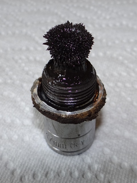

I started by draining out all the engine oil. There was exactly one half cottage cheese container of oil in the engine, which is the universal measurement for “not enough oil”. It had the consistency of melted mozzarella cheese, another bad sign.

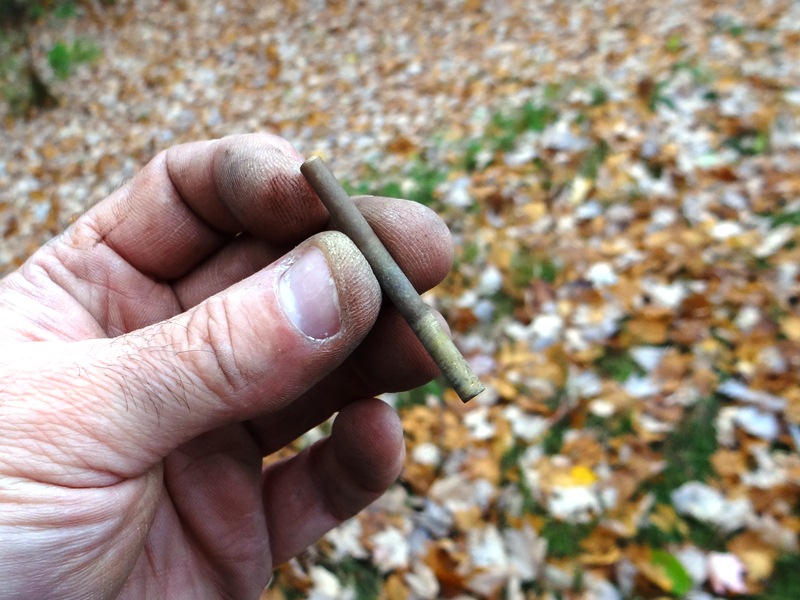

I found the fuel inlet tube rolling around in the fuel tank. That hints that the petcock gasket is no longer pliable, so I've ordered a new one.

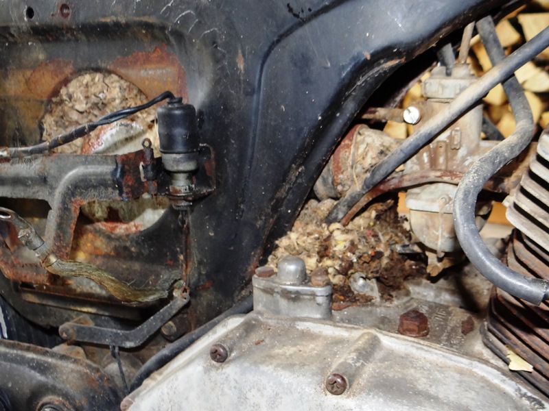

Below, I found a mouse nest inside the frame, behind the carburetor ... where much of the wiring resides. Oh oh.

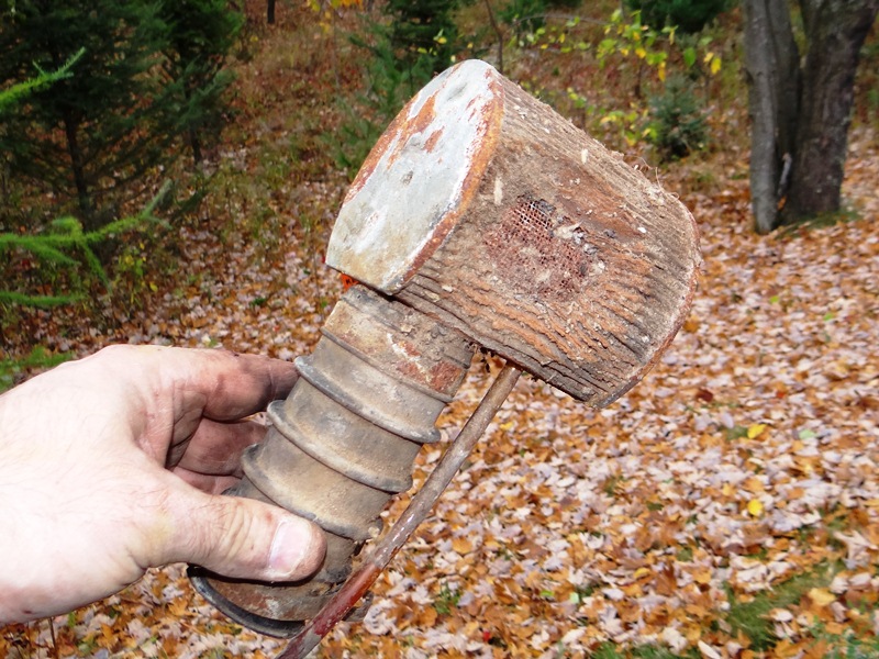

It appears that the mice enjoyed the air cleaner, which oddly looks like a piece of firewood at this point.

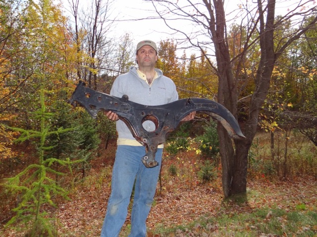

Below, my Benly is now a rolling chassis.

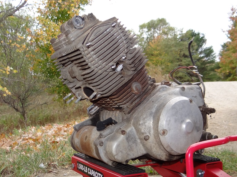

The engine is free.

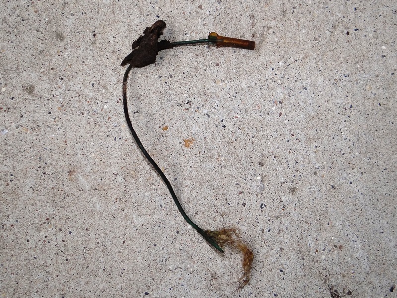

Below, the mice did some wiring work, so I'll carefully inspect the harness when it's off the bike to decide whether to fix or replace completely. Replacement harnesses are cheap.

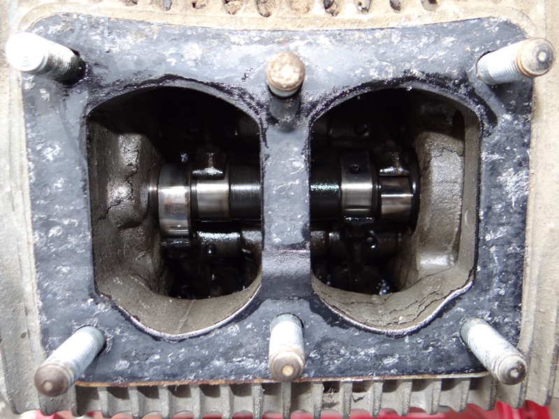

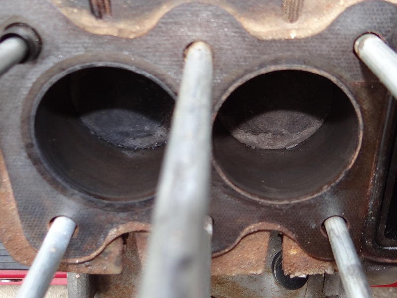

Below is my first glance inside the engine ... the camshaft and cams looked good. Not a score or scuff anywhere.

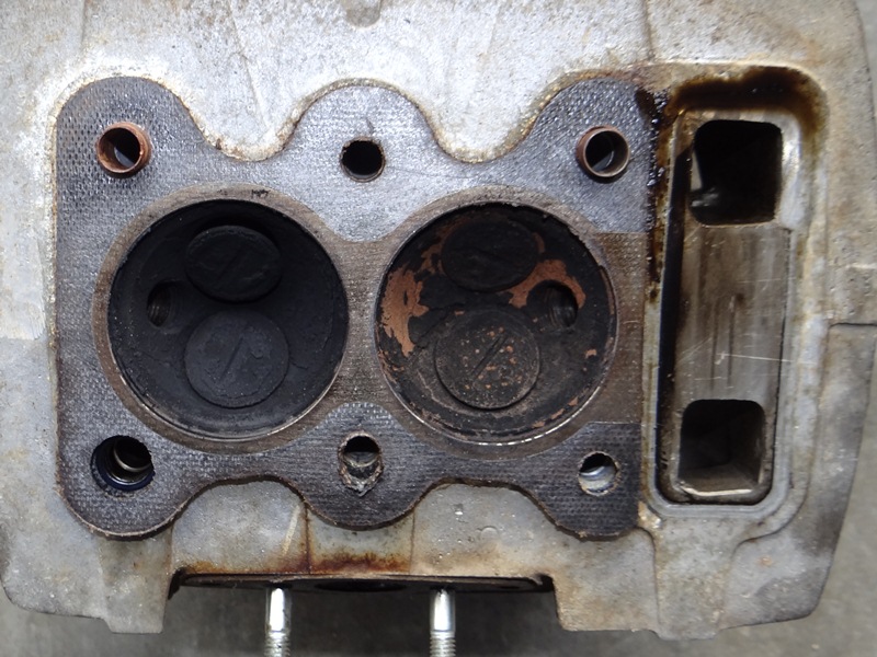

Below, the head has some carbon build-up, which will be cleaned when I pull the valves.
The picture below doesn't show the cylinder condition very well, but the cylinders looked great. Perfectly smooth, no scoring to be seen anywhere. I'll take some micrometer measurements later to understand what I have.

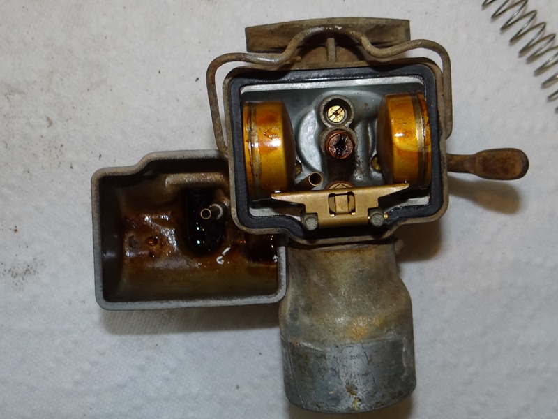

The carburetor has some gasoline residue/varnish, but no oxidation, so I'm happy.

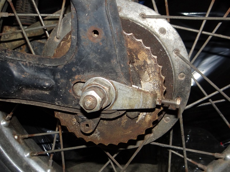

Have you ever seen a rear sprocket this worn? I realize it's aluminum, but I'm assuming that the previous owners had some religious issue preventing them from lubricating and adjusting the chain.

Welcome aboard! Holy smokes!! Look at that sprocket. That engine must have some porting done to make all that power. You are a very lucky man that the valves were shut in the head to keep the cylinders shut tight and rust free. It's in great shape!

After seeing that sprocket, I would take a long look at the wheel and output shaft bearings. How could anyone let it get that bad.

Excellent point ... the poor condition of the rear sprocket suggests a poor maintenance routine. Every bearing, race and bushing will be inspected. Anything that needs replacement will get replaced.

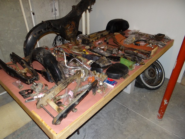

I completed the tear-down of the 1965 Honda Benly Touring today, reducing the motorcycle to a rusty steel frame. I power washed all the body parts, eating away at the decades-old mud and crud under the fenders and inside the frame cavity. I was pleased to find the wiring harness to be mostly complete, minus the two wires that fell victim to mouse teeth. I’ll repair and re-solder those connections later.

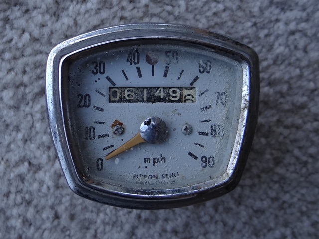

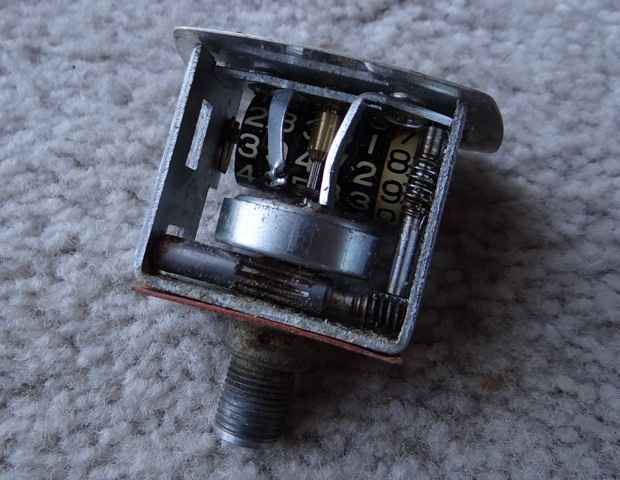

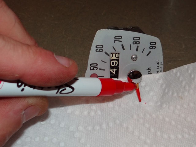

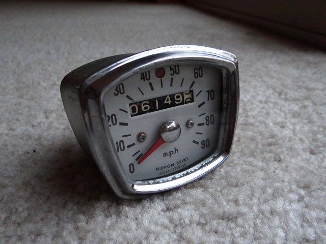

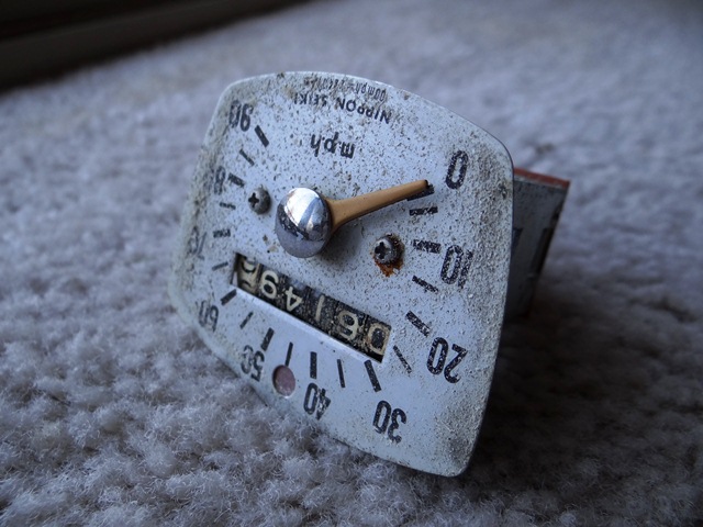

The speedometer appeared to be in pretty rough shape. There was lots of aluminum oxide corrosion on the face plate, so I feared that I’d need to get a reproduction plate decal. I disassembled the speedometer and found the worm drive mechanism to be frozen. Perhaps that’s why the original speedometer cable was broken, and it certainly would have broke any new cable. After some lubrication, I was able to get the gears to move freely. Fortunately, the paint on the face plate was not pitted, and the corrosion cleaned off rather easily. Over the decades, the speedometer needle had faded to a pale orange, so I used a red Sharpie Paint Marker to give the needle back its color. I’m pleased with the results.
The project will slow down a bit now as I turn my attention to rebuilding the engine and transmission. Over the Winter months, I’ll gather a few parts each week until I have what I need. In the Spring, the frame and most black parts will be sand blasted, primed and painted.
Below is the ancient selenium rectifier. Since selenium degrades over time, I always replace these with new silicon rectifiers for an efficiency boost and added reliability.
The project table is fully loaded, and all small parts are labelled in zip-lock bags.
Speedometer before cleaning and lubrication
The worm drive was frozen until I cleaned and lubricated the mechanism.
Aluminum oxide accumulation on the face plate.
A Sharpie Oil-based Paint marker restores the red color to the needle.
Not perfect, but much nicer now, and the mechanism works.

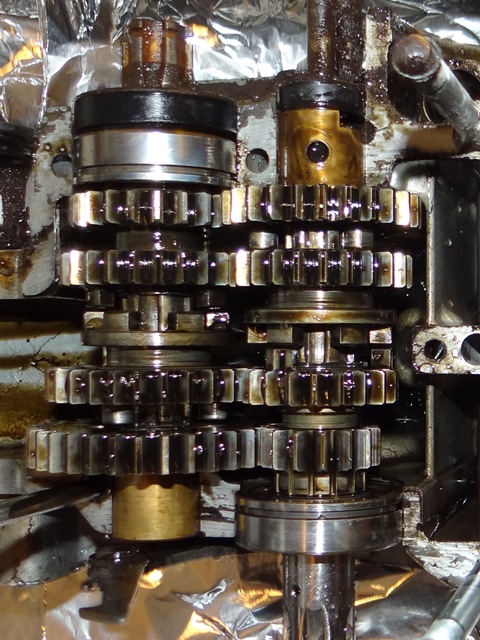

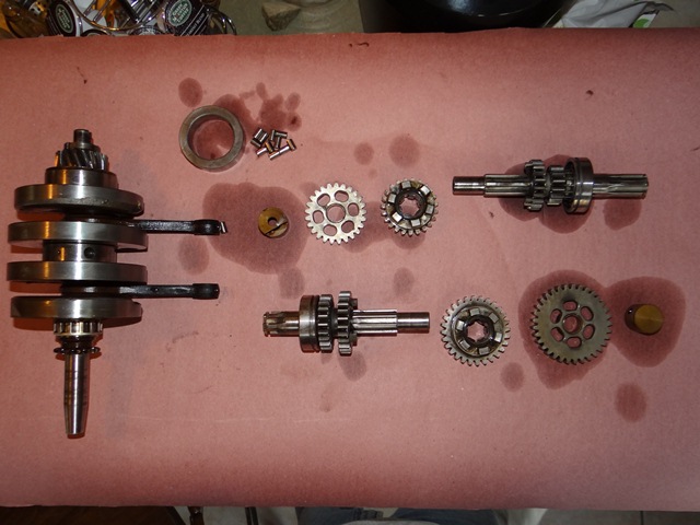

After some delays yesterday, I finally split the engine case on the '65 Benly today. I was pleased with what I saw. The engine crankshaft bearings looked great, as did the transmission gears and roller bearings. The shaft splines looked perfect. The transmission dog clutches were completely square, not rounded from use or abuse, so I expect this motorcycle to shift and hold each gear nicely.
I did have a bit of a scare when I pulled the oil drain plug. I had drained oil through the side of the engine earlier when I couldn't get this plug to come off. After heating the lower engine case with a torch, I was finally able to get the plug out, and the magnetic tip was covered with oily-metallic residue. I worried that this might hint at some engine damage, but when I wiped away the metallic mess, it felt smooth to my fingers. I couldn't feel any particles at all. Therefore, I'm assuming that this was an accumulation of minuscule pieces of iron from the cylinders, perhaps just normal wear. I'll take some measurements of the cylinders and pistons later to confirm that.
So, the engine and transmission look great. I'll coat the parts with WD-40 before storing them in zip lock bags until I reassemble the engine in the Spring. It's too cold here in Northern Michigan to do any painting this year.

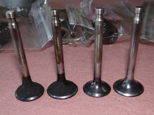

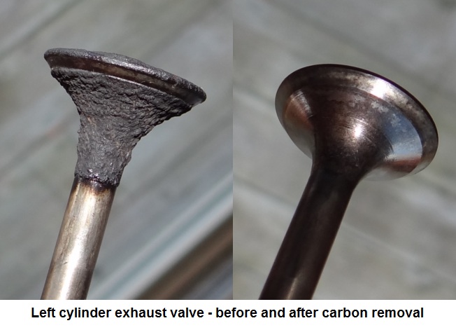

Yesterday I disassembled the CA95 engine head, and was very pleased with what I saw. The camshaft and rocker arms looked perfect. The valves cleaned up quite nicely, with no visible wear. I haven't cleaned up the head yet, so I haven't inspected the valve seats.
Below, the right cylinder valves after cleaning, compared with the left cylinder valves that had not yet been cleaned.
