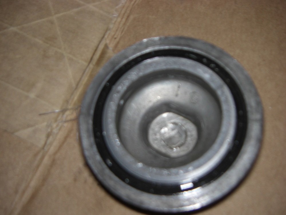

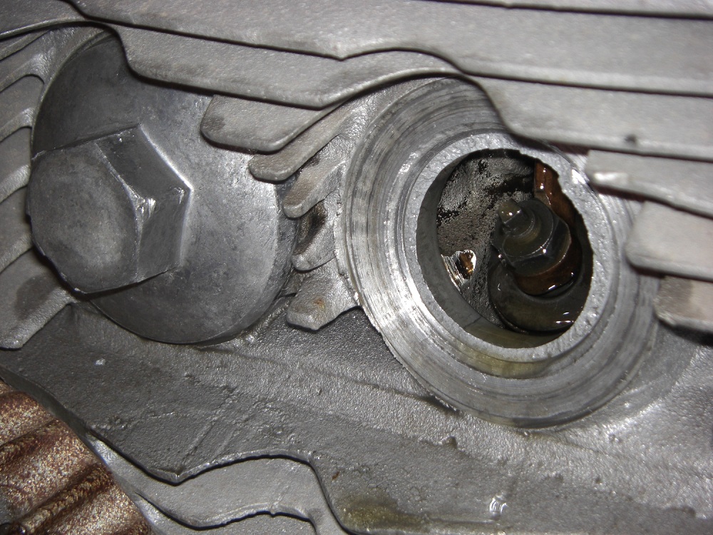

Here's the situation. I adjusted the valve tappets, triple checked, and was reinstalling the covers. Although it's been years since I broke off a bolt, screw, anything, but apparently I haven't learned my lesson. I didn't think I was over-tightening, but was apparently wrong.
So the question is, how screwed am I? Not like you can just throw on an extractor and pull it out. Should I just jb weld it on? If so, will I ever be able to get it off again without really torquing on it and possibly breaking off a cooling fin?
I've cut out little slices of carrier arm bushings on my old school lexus and pried them out. Off course, bushings are not threaded on the outside. Is this possible? What are the implications for metal fragments getting in on top of the valve(I suppose I could just make sure that side is closed and just shop vac it later)? And lastly, if this is the solution, what would I cut it with? I used a sawz all for the bushings, but am afraid the blade would beat up the valves.
I can't wait to ride again. It's getting hot here in Phoenix, so any opinions would be appreciated.

I would fit the nearest size socket and JB Weld it in. Be carefull not to get any epoxy on the threads. Let the JB cure and attach a rachet and remove it. Just a thought.
ps I have some extra tappet covers if you need a replacement. PM me with an address if so.

taped the outside of the engine and covered the inside (over and around the valves) with wax paper. JB welded and success! Barely had to torque it. that's why i love this forum!!!!

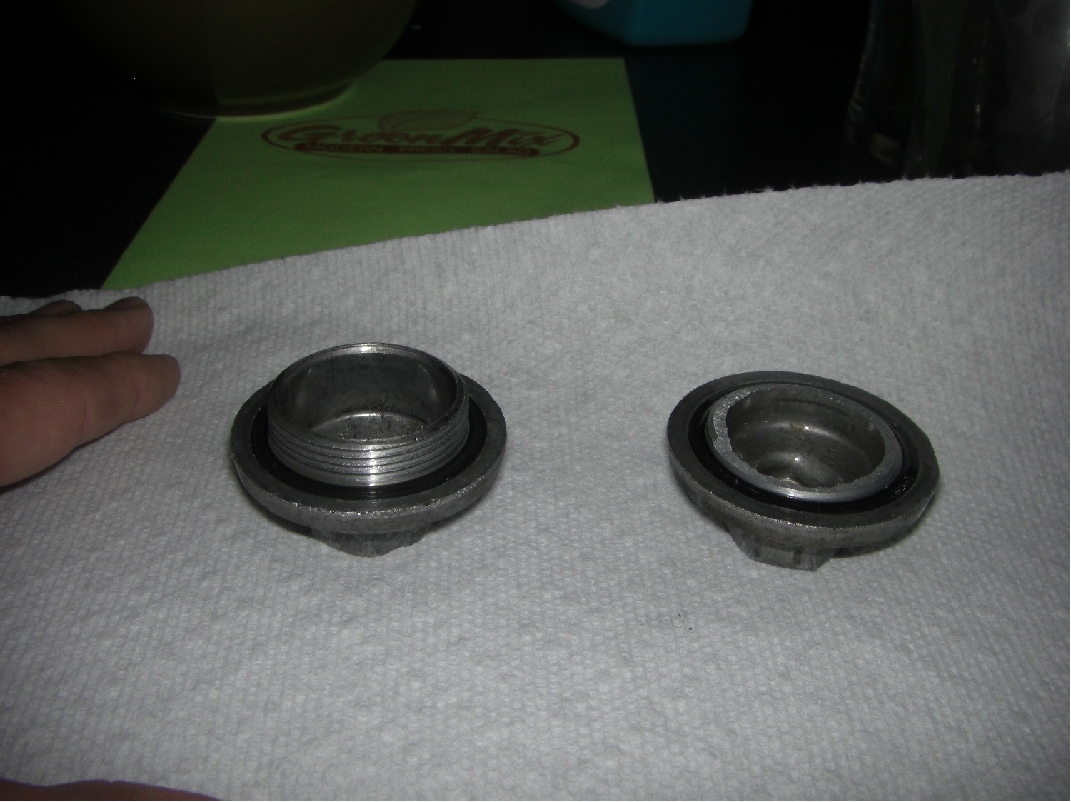

Originally Posted by djbrett View Post
here's some pictures, if I did it right:
1. The last picture is blurry. Do you have a better one?
2. It's Ok to just call me stupid, but I can't look at your paragraph and your bottom two photo's and relate the two. What am I missing? In other words, what was the problem, how do the photo's illustrate it and what was the repair. (I am not a master mechanic like some here and am just trying to understand).
3. Does the first two photo's relate to the problem or just illustrative of your nice looking bike? It is a very nice looking bike by the way.

here's a picture of a good valve cover and the one I snapped off. The one has threads, the other cover's threads are in the bike on the right hand side

Thanks for the clarification. Now I get it.
