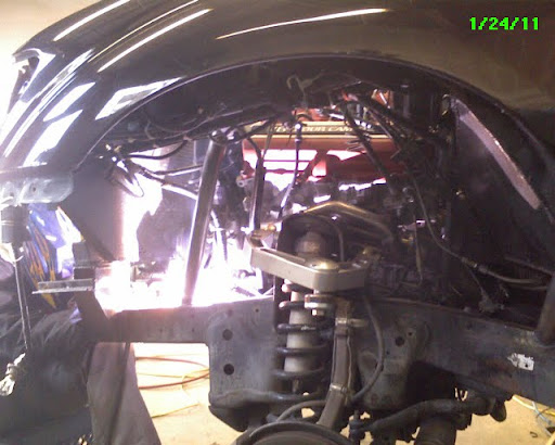

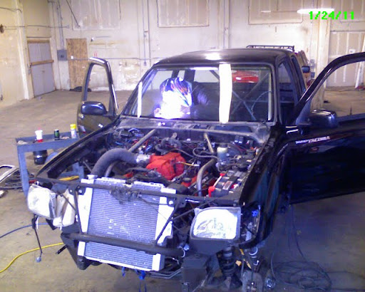

Unread 01-25-2011, 02:36 AM
All I had was my cell phone to take some crummy pictures today. At least you can see a little of the progress.
More tubing being added to the front of the Tacoma frame.

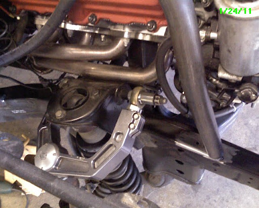

Unread 01-25-2011, 02:40 AM
And along the driver side also. It took some time to think of the correct points at which to bend the tubing in order to be able to bend both sides accordingly. A bend on the passenger side might not be the proper bend when made in the same place to mirror over on the drivers side.
And this is all the shots from today. We added even more tubing going from the frame from the rear of the engine compartment to the upper supports you see here where the shocks will mount in the future.
Unread 01-29-2011, 09:20 PM
Nearly done with the engine crossbrace over the Lexus engine. Mr. Dirt Designs doing the business.
I can't wait to test the truck out when it's all buttoned up. I spent an hr or so welding the body to the frame but there's still a lot more to do.
