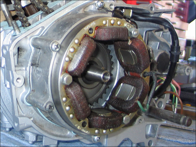

In Smithers first picture you can see the plates I am talking about. You have to take the coil off first. This might be a little awkward, but once you take the retaining bolts off, you should be able to just work it off by hand, or with a little help from a hammer. Once you get a crack between it and the case you can get a screwdriver behind it. The tricky part is that the magnet will grab the coil as you wiggle it.

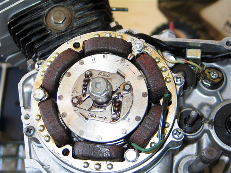

The next Picture is of my magnetos edge. I think I can see those layers rob was talking about in this picture. I suppose I will just unbolt everything holding the magneto in place and then try and work a flat head screw driver in there to make room for my hooks. I cant imagine how a hammer would do anything to help me in the beginning seeing how there is nothing to hammer that would push the magneto out. http://www.fourwheelforum.com/attachmen ... 1250094885

You will need to take the coil off before the extractor will help you much. Take the bolts off that hold the coil on. There should be a few. One is a nut on a stud which I can see in your picture. Then tap the ring just a few times with a hamer, preferably a rubber mallet if you have one, around it until it works a little loose. Then you should be able to get a screwdriver down in there, probably close to where the wire goes in, maybe even by squishing the rubber grommet a bit and working it around. That coil comes off first though.
Once the coil is off, you will see the 3 plates and you can get the extractor on there.
The part with the screws in it won't come off. There are basically 3 parts. The coil (the reddish packs of wires) and the ring being held in by the bolts, the magnet itself (the small circular part in the middle that turns if you crank the engine) and the cover that is held in by the phillips screws.
Let me know if this isn't clear enough. This is a hard process. It should look like http://www.fourwheelperformance.com/hon ... agneto.jpg if you are ready for the puller.
When you are ready for the puller, break the center bolt loose and take the point(s) off since they can easily be broken. Then thread the bolt back in a ways but don't tighten it. You want enough threads to not damage it, but if it isn't loose the puller won't have room to come off.

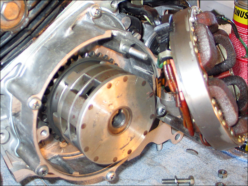

Oh yeah totally, take that coil off and move it to the side like this:
Maybe a piece of wire will help hold it out of the way while you are cranking on the puller. I remember one I took off. I cranked the puller down a LOT and had to seriously slam it with a big hammer to get it to POP. And it freakin exploded apart. But it came apart! Sometimes you just get an impossible one every now and then.
Yeah screw the main bolt just snug and then loosen it a couple turns. That way when you hit the puller the magneto will be able to come loose for a tenth of an inch or however far you backed off the main bolt.
Here is what the magneto looks like removed... and the starter clutch is right behind it. Don't lose any of the little parts that are enclosed in the starter clutch. Hopefully they are in good shape and you don't lose any!! They are hard to get. There is a spring behind each roller so they WILL try and come out. And there is a key that the magneto slides onto. It is crescent shape. MAKE SURE you locate this as soon as the magneto comes off. Life will be miserable for you if you lose any of this! Buy a box of Zip Lock bags. Those things are the best to keep things in order.
Here is what you will see behind the magneto. Make sure and grab that key so you don't lose it! And notice the shape of the crank end is in a cone shape. This means that the force of the main bolt will make the magneto clamp down on the cone shape crank... and hold it super tight. So they are hard to pop loose. And that crescent shape key makes it very difficult to put back on. But once you have done it your next one will go 3x faster! That's the only good news I can give you, sorry.
