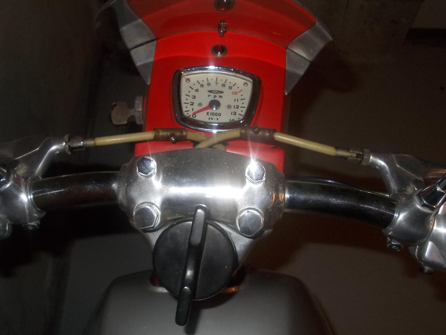

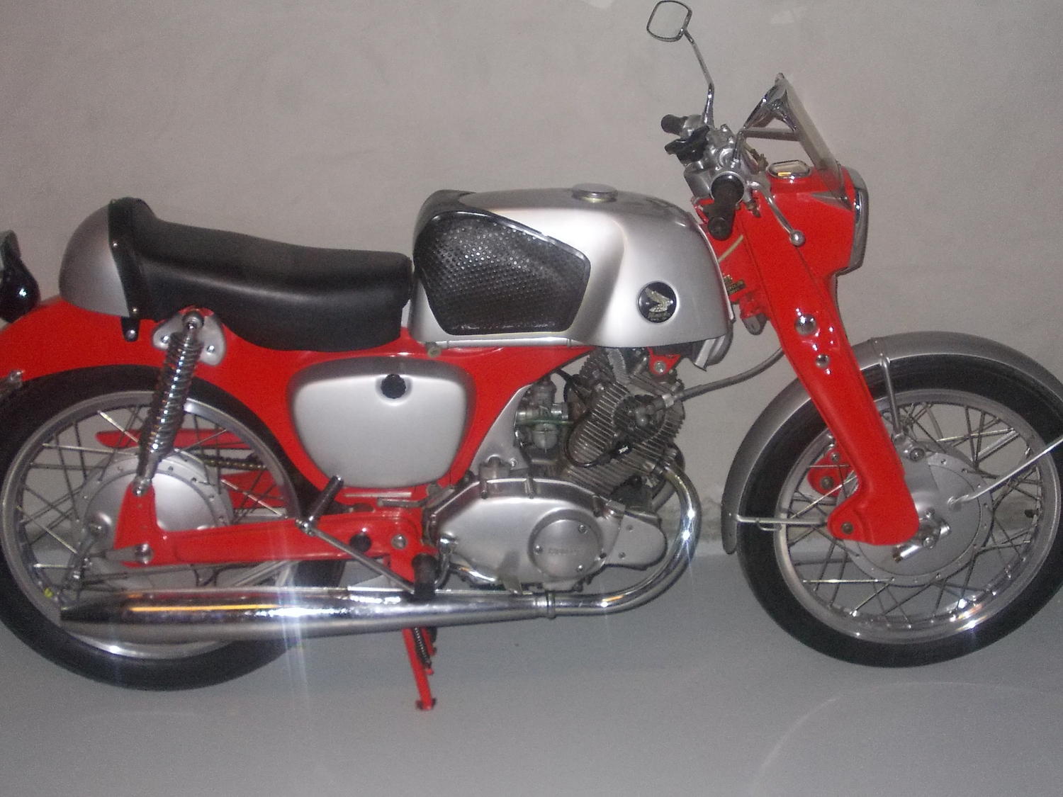

Wow, what a beautiful motorbike. I am sure that Sam Green will be able to answer your questions, since he has one of those models and has raced just about every combination of parts.
Thanks for sharing the pictures, they are just beautiful. The CB92 is just not seen in my area.
Truly Jeff a nice example-BTL hit it when he said we just don't see these.

WOW , that's just plain Cool !
