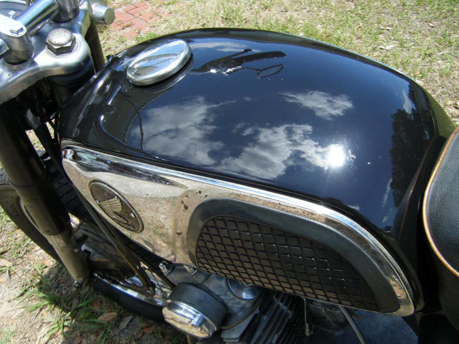

You can choose any good white, even from Eastwood. I've chosen to paint my next CA95 with the Duplicolor single stage mixed in the can lacquer system. Silver base coat, self mixed cream trim color (from Y & W) and the Candy Orange with the gloss clear. That bike is "Tangerine Dream". I hope it turns out.
Once the decks are clear this spring it should go together.
The tank in the pic is just gloss Rustoleum. I thought it flowed out nicely for a spray can.
