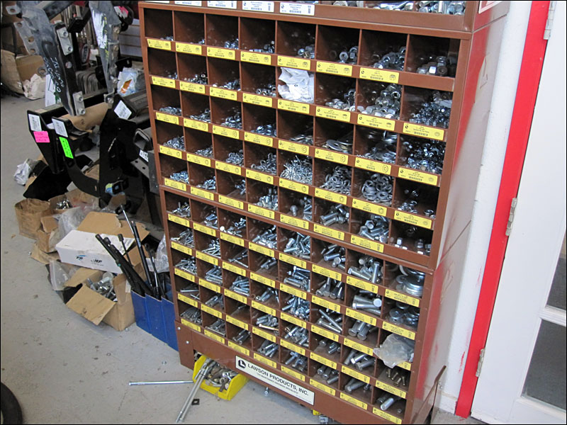

And now that it's time to bolt on the left and right supports to the firewall and front end I had to raid the bolts bin! Standard high grade bolts for that stuff so there is no possibility that they get used somewhere else on the truck. One thing that is annoying on this truck is that there are 10 different types of the same thread bolt all over. So you can't tell which style of bolt goes where. It's really a PITA cause they are just slightly different - not very distinguishable.

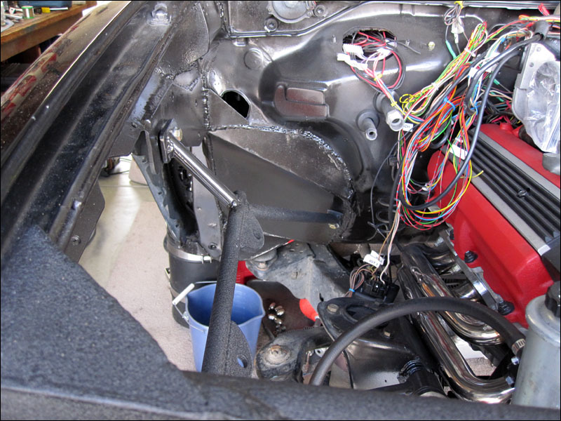

Anyhow nice shiny new bolts for the front:

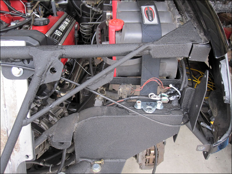

Here is a look at how I strapped down the battery. Since the base is so strong and holds the battery well I just opted to throw a limiting strap over the top of it that I picked up from Poly Performance in San Luis Obispo.
I actually made sure to make the studs for the front support long enough so that I could bolt anything else to them when the time came to secure the wiring and other things. It's nice to see it all come together. The nuts and washers are kinda temporary for now. I have a bracket in mind that I want to make when I have time and after I'm driving this truck around.
