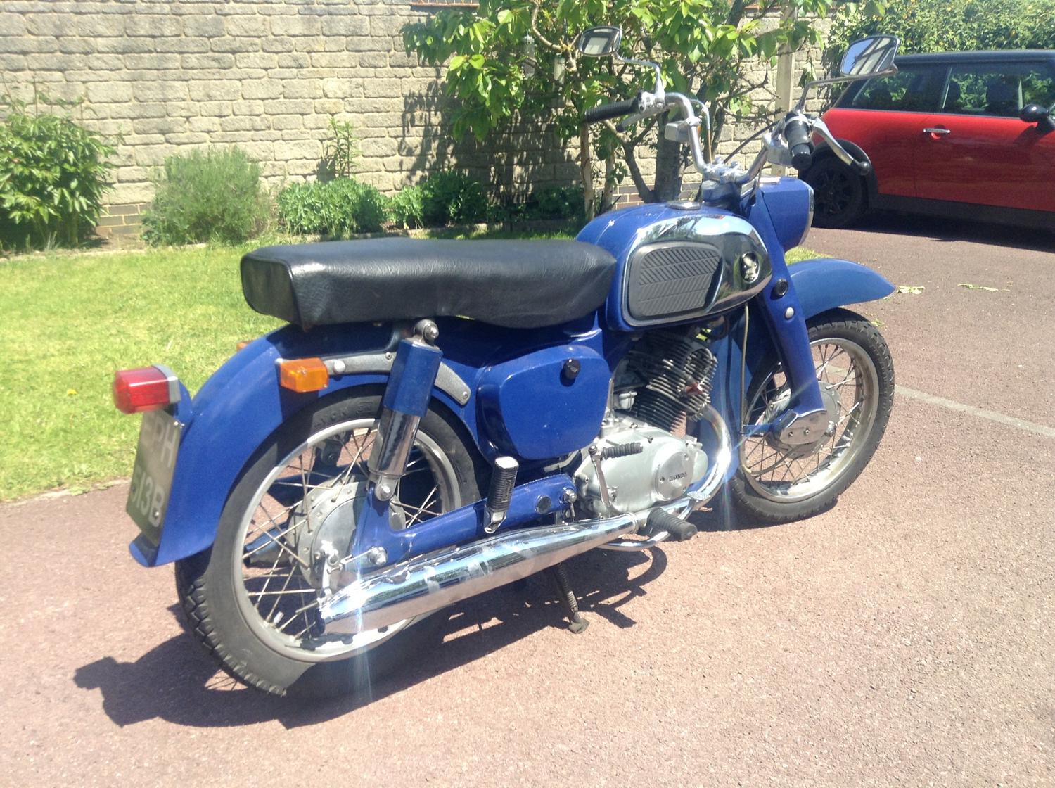

I have had this bike 30 years and run it on and off for 20 years, The clutch has always been weak, but I have never found any new plates on eBay. Doing a bit of a search through the parts books I found that the same plates were fitted in the CB200 and are still widely available. I got an EBC ck1134 kit the plates are thinner but come in a set of five which makes up the same pack thickness.
It's made a huge difference it used to slip if I hit I big bump on full throttle and couldn't cope two up but I never thought it might be slipping all the time. I don't really believe the speedo but 55 used to be the maximum on the flat, with the new clutch and no other changes it was showing 65 and keeping up with the traffic.

Interesting to see the bike in blue and it looks great. I have a C95 in this colour and the original seat upholstry although well faded was clearly blue also. Seems to have been a common colour for the C95's in England, Australia and New Zealand but not so much the U.S CA95's?

Hi guys thanks for the comments
This is just a home made cover I made about 20 years ago. I have heard about blue seats but never seen one. Is it all blue or is it two tone? I have a red seat from a spare bike I bought, that has a red top with white sides and a chrome trim around the lover edge

The seat is all blue including the strap that goes over it. I think when I restore the bike I will go with two-tone cream sides and blue top to break it up. The blue is nice but everything including the seat is a bit much.

I agree Foamy I think all blue would be a bit too much, cream sides would also hide a less than perfect colour match.
