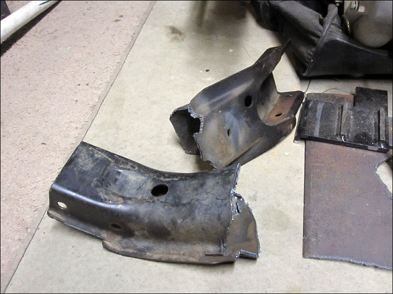

Step 2: Cut off mounting brackets from the inner frame with plasma cutter, grinders with cutting wheels and then grinding then flap discs.

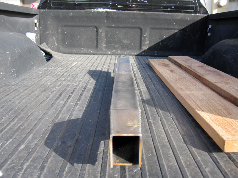

Now that the frame is prepped for new crossmember installation we gotta weld the crossmember together.

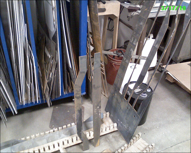

Steel plate fresh from the waterjet. Gotta love CAD!
Weld it all together and we're good to go.

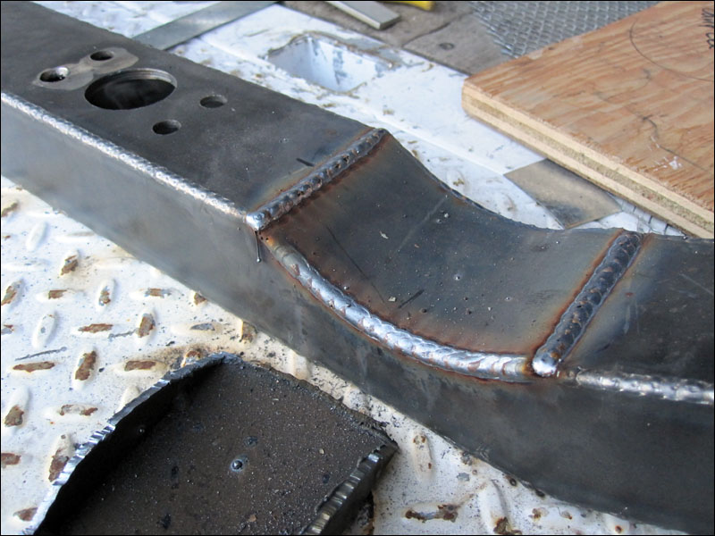

Unread 04-04-2010, 08:54 PM
Now for a little of this and a little of that. Steel work is a lot of fun. I can't wait to put a roll cage in my truck!

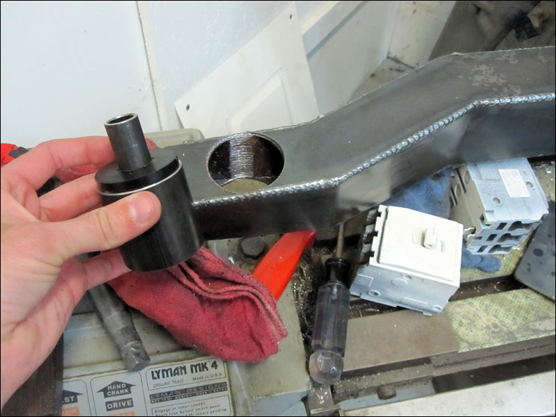

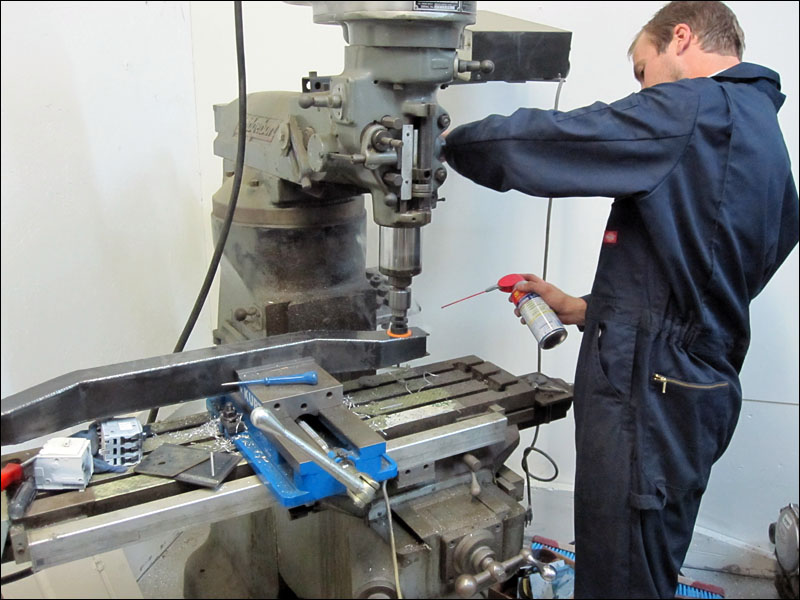

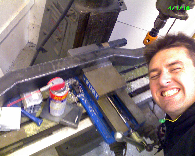

Sizing the holes for the new poly bushings:
Unread 04-04-2010, 08:58 PM

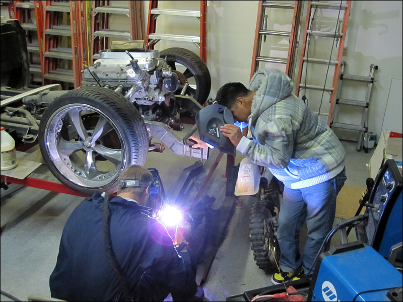

My buddy Josh making the magic happen. I couldn't wrestle the TIG away from him if I tried.

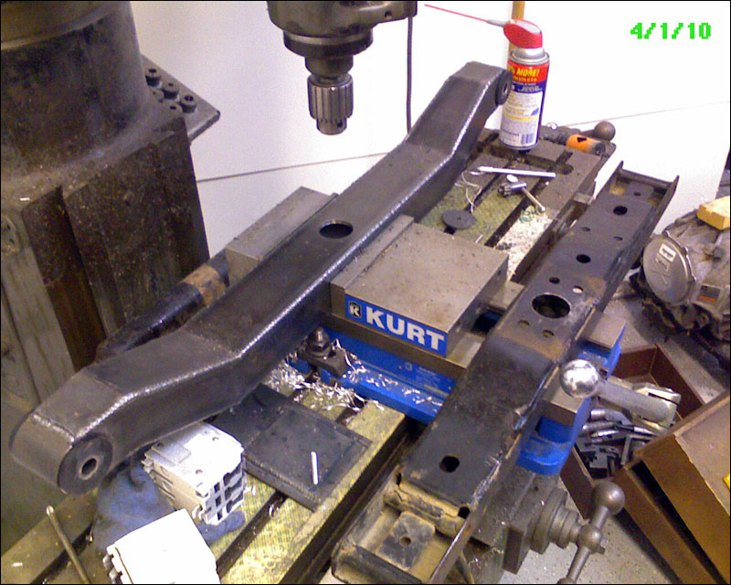

Now time for some holes. Both the old and new cross members for comparison:

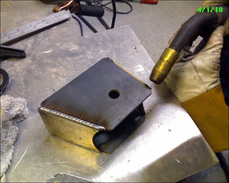

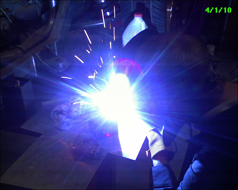

And welding together the mounts that then will be welded to the frame.
Looking good. The adrenaline is pumping as the time is reaching midnight.

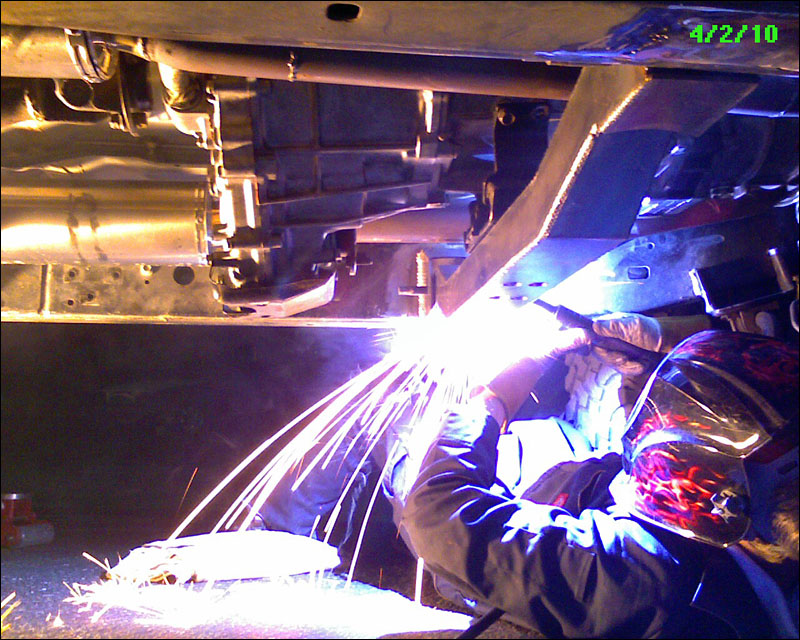

Unread 04-04-2010, 09:03 PM

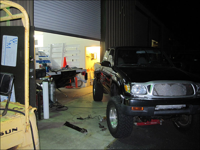

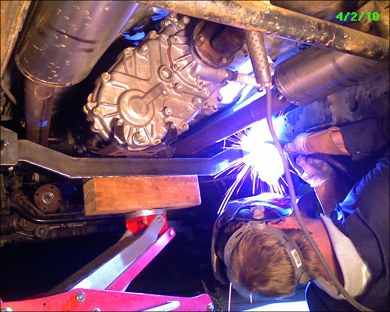

4/2/2010 Now it's just past midnight and now we're getting somewhere. Welding the mounts onto the frame after a few minutes of measuring.

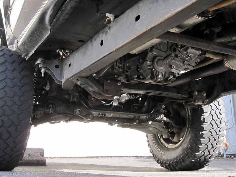

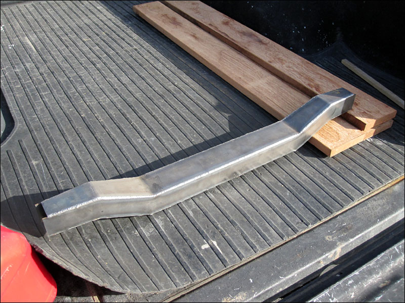

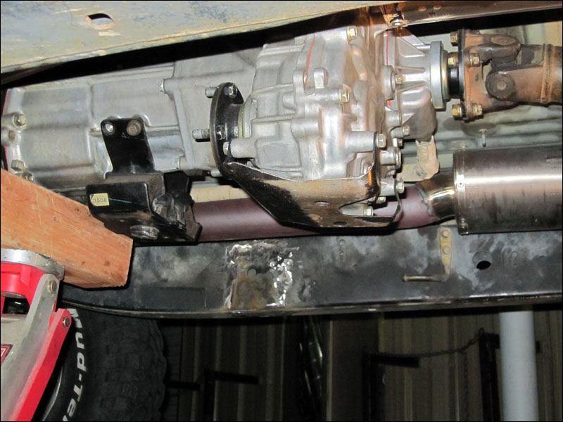

So that all went pretty smooth. Now for kicks here is a comparison of the before and after.
With the hurtin steel plate type brackets I made to get the truck rolling... gotta do what you gotta do!

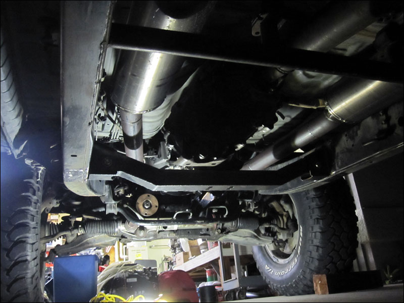

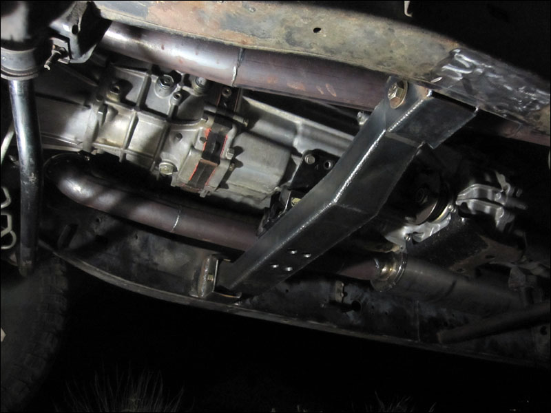

And the finished product! Very happy to have this done.
Unread 04-04-2010, 09:37 PM
Ahhh much better.
And the BEST part: The transfer case and new crossmember don't hang down below the frame so much anymore.

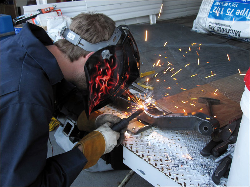

It's a lot of fun and just takes time. I'm glad I don't do this for a living.
Had to cut out a section for front driveshaft clearance to connect the 4wd once again.
And here is he action shot of Josh putting in work with the welder:
IMPORTANT NOTICE: No media files are hosted on these forums. By clicking the link below you agree to view content from an external website. We can not be held responsible for the suitability or legality of this material. If the video does not play, wait a minute or try again later.
I AGREE
