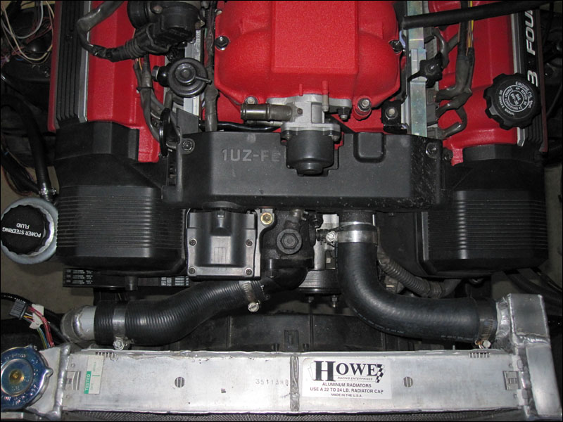

Just to clear up a few radiator and cooling issues for everyone. The coolant inlet of the 1UZ-FE engine is thermostat side. To be more clear the thermostat is held in place with the black plastic inlet that you see in the picture below.
1UZ coolant outlet: The round pipe on the right (facing forward) is the outlet.
