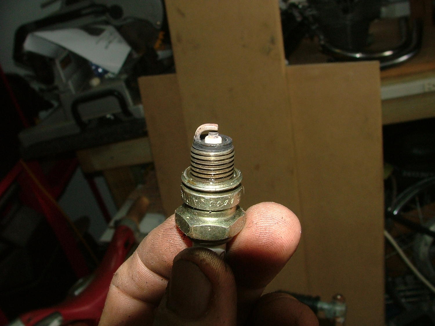

Anyway since part of my mission is "rehoming" bikes to folks needing a vintage experience, the opportunity came up to place this bike in a good home. Since I don't like passing problems on to other folks, I decided to pull the top end and get a look at the rings and determine if I had stuck or broken rings. Turns out that the later was the case and now I suspect the reason for parking the bike in the first place. Both plugs looked real good and the head and piston ( in the bore) looked normal. The bike ran well and seemed to have good compression (though I never did a comp check).

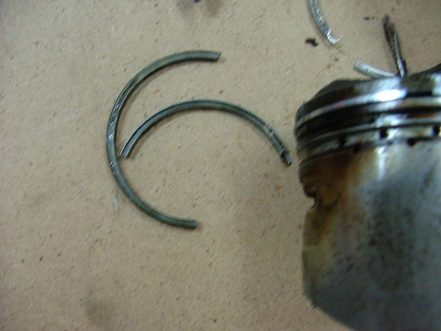

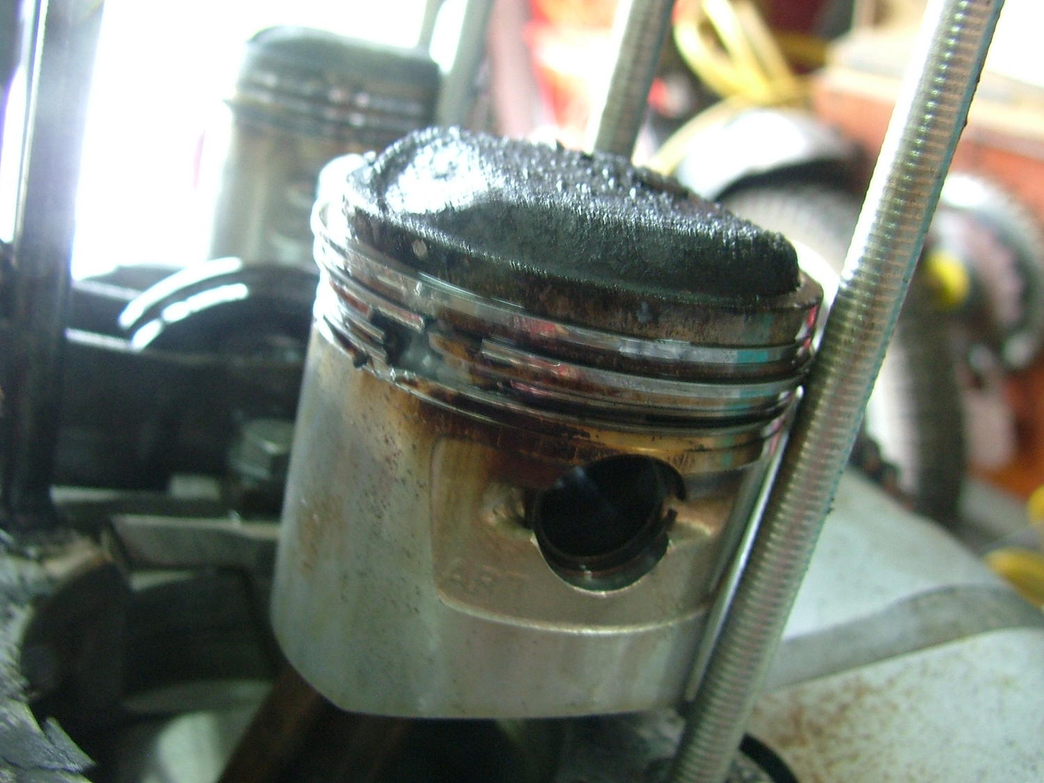

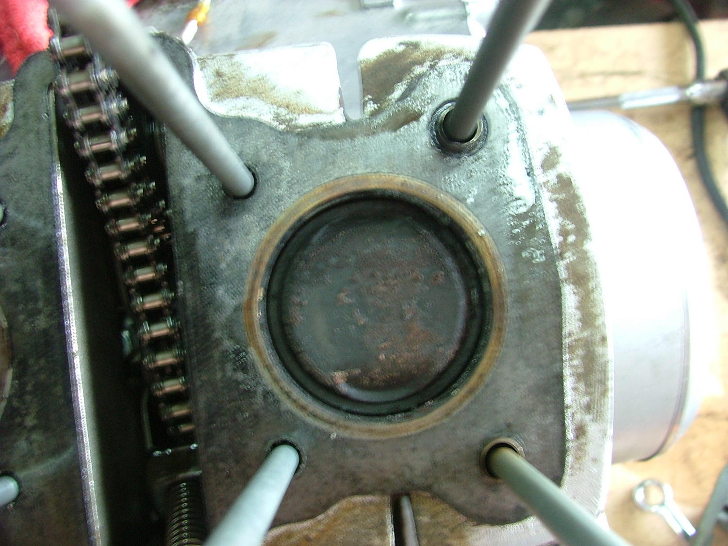

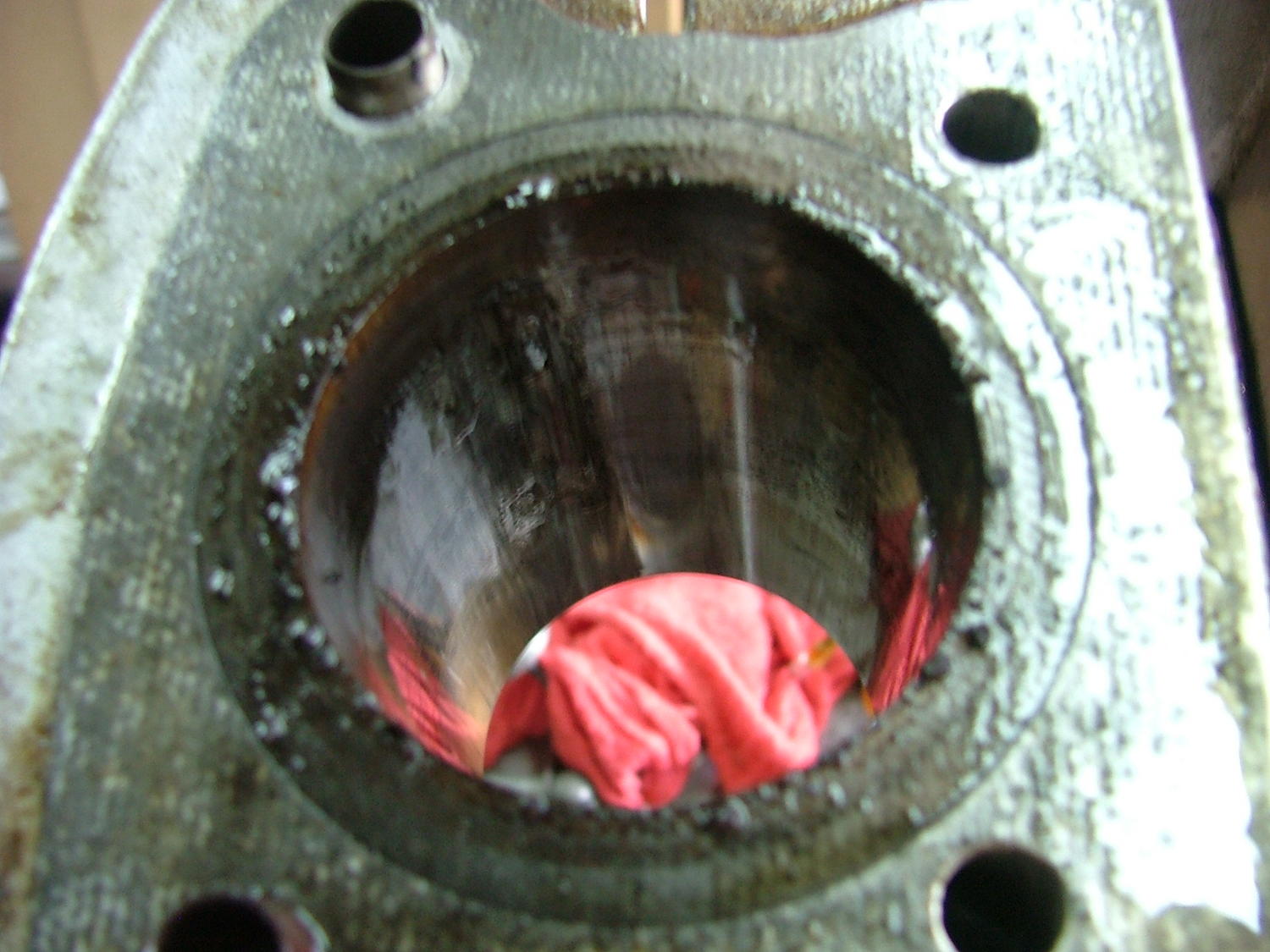

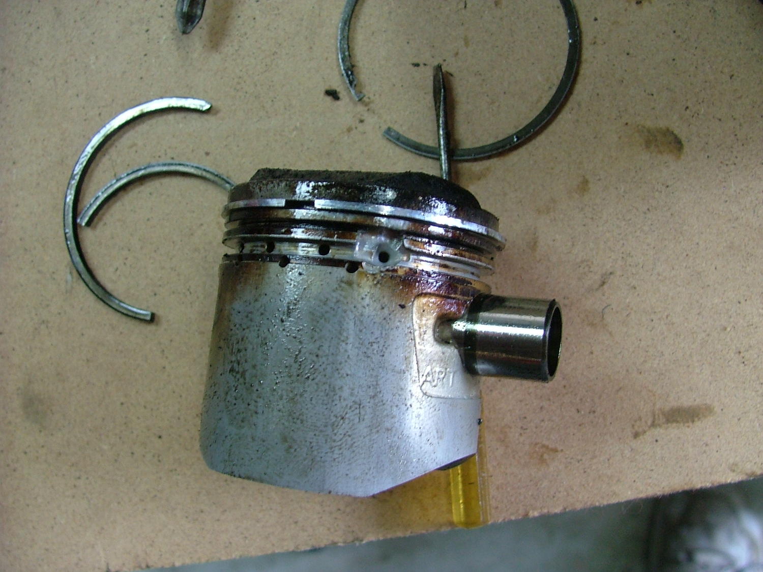

Up until this point I was fairly happy with how things had gone. The cylinders came off with no trouble and I found the little culprit causing my little red Honda to become and Indian sending smoke signals out the right pipe.The first fuzzy pic is the piston still mounted the next is the damage to the bore, the third the damage to the piston and finally the broken oil ring. Interestingly the top two rings were intact and I'd suspect that when doing a comp check at TDC might NOT have revealed the damage to the cylinder. Its hard to say at this point. The sad part is the damage to the bore. Upon measuring it would need at least the first if not the second overbore. Bummer. I called Terry at Western Hills and they can get everything to do the job and had all in stock except new wrist pins, which they could get. Without machine work we were at nearly $400. More bummer.

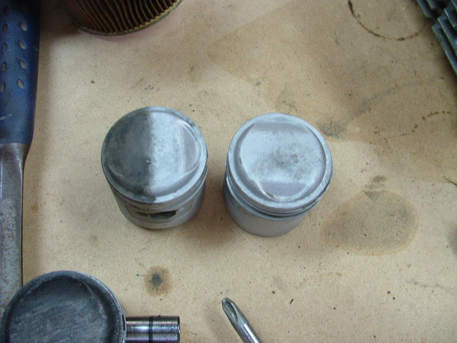

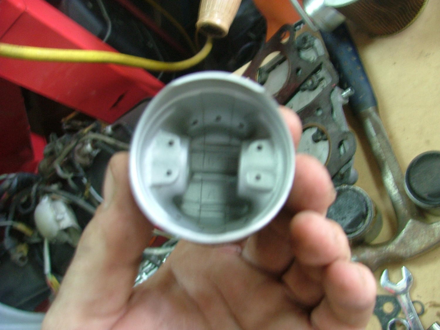

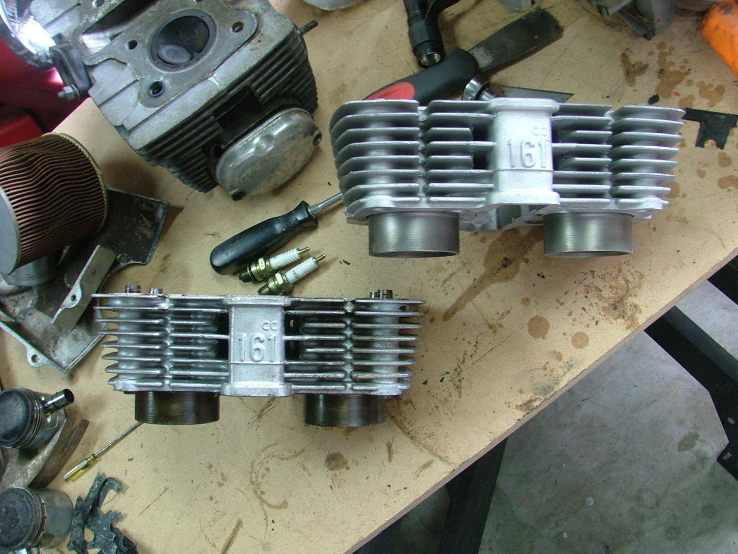

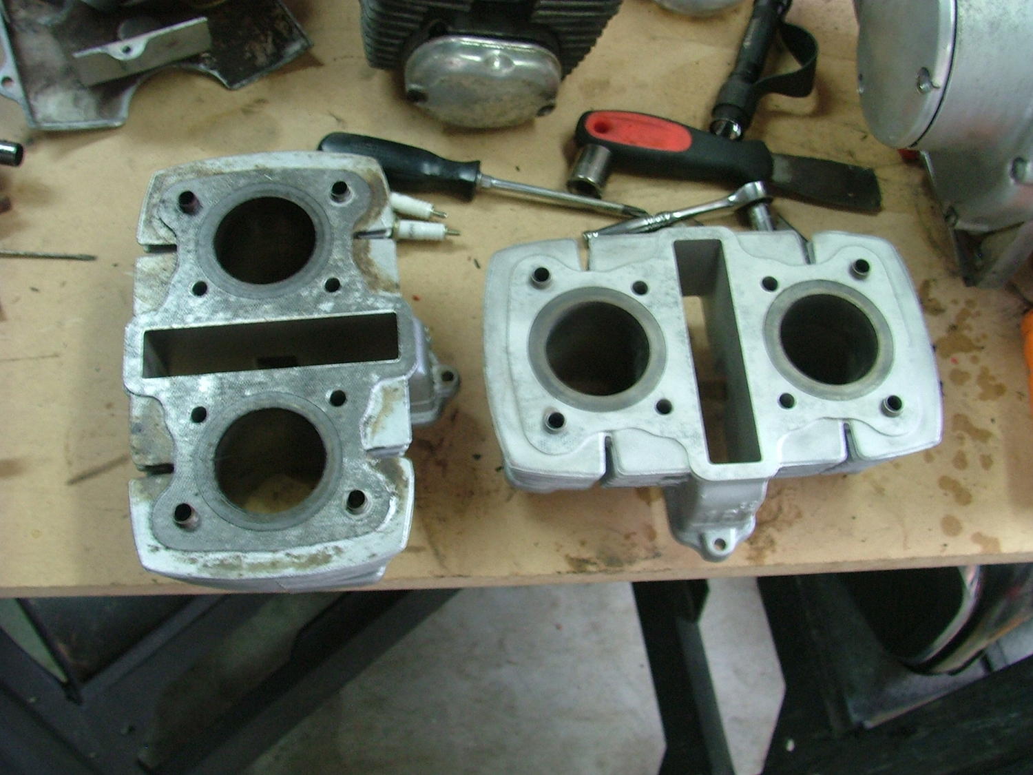

Fortunately, I happen to have a "spare" CA160 waiting it's turn in the shop. I knew this motor was "tight" and not in a good way, but thought what do I have to loose by tearing the top end down and taking a look. One commercial later I had a new bike- wait this isn't reality TV. Hours later and after struggling to get the pistons far enough down in the bore, I got the wrist pins out and removed the cylinder assembly. I could now pop the most stuck piston out of the top of the bore fairly easily, which occurred with no surprises. Initial inspection reveals nice cylinders on the factory bore and within specs and two undamaged pistons.
Funny enough though the stickiest of the two pistons did have stuck compression and second rings and remains stuck now (tho soaking in carb cleaner). In the end though I have two nice pistons and one good cylinder set all in standard bore. Don't get me wrong guys I have no trouble in going oversized but since this is less than 5000 mile bike and the object is preservation, a std bore means something to me wrt to originality.
The first pic has the original to the bike cylinder on the left and the replacement on the right. Bead blasted and cleaned ready for honing. The third pic is part way through cleaning the pistons. I wanted to show the next owner the reconditioning process and I finished the blasting.

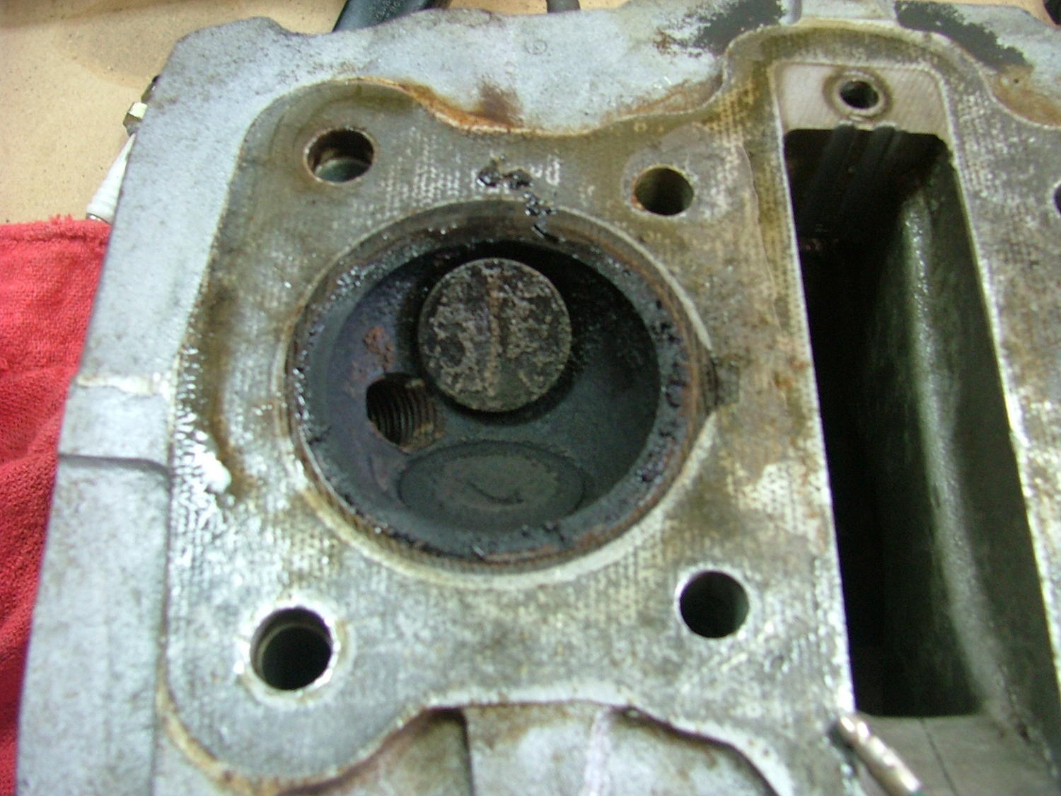

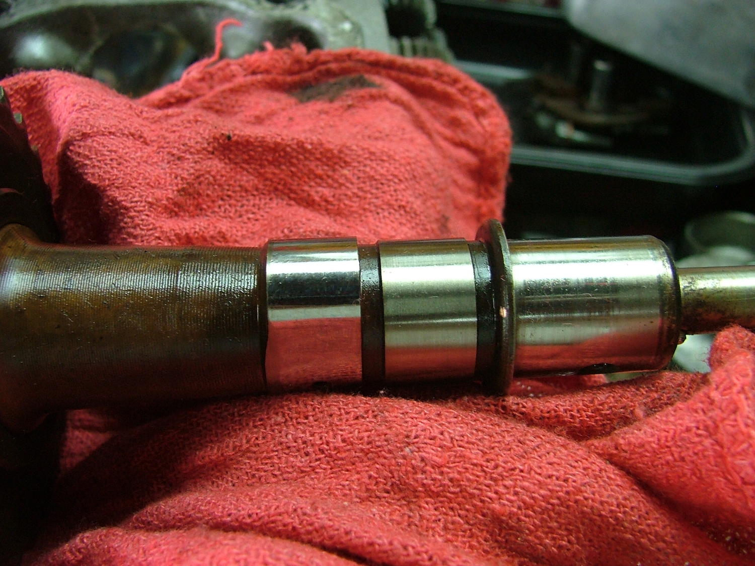

I next took to disassembling the head. The cam looks wonderful and the lobes and bearings will get a quick polish just to brighten them up. I removed all pieces and blasted the valves, compression chamber, exhaust ports and the rest of the head and labeled everything as to location. I'll get some lapping compound and "lightly" lap the valves.
Ultimately there could have been a burnt valve causing the initial problem but the chances of that were lower from the start so I was pleased at the condition of the valve set. I'll post pics of the reassembly once the rings and gaskets get here.

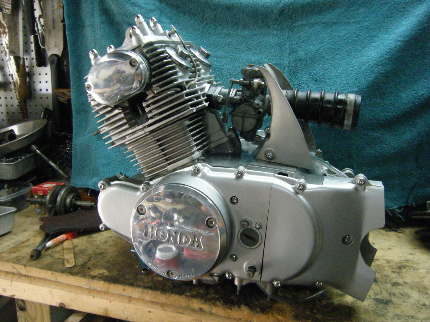

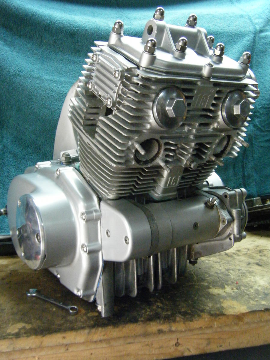

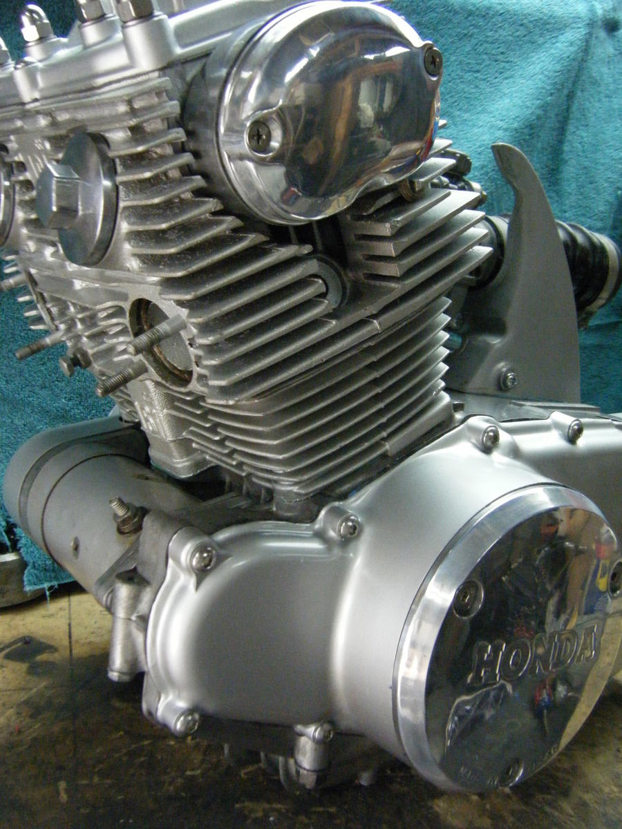

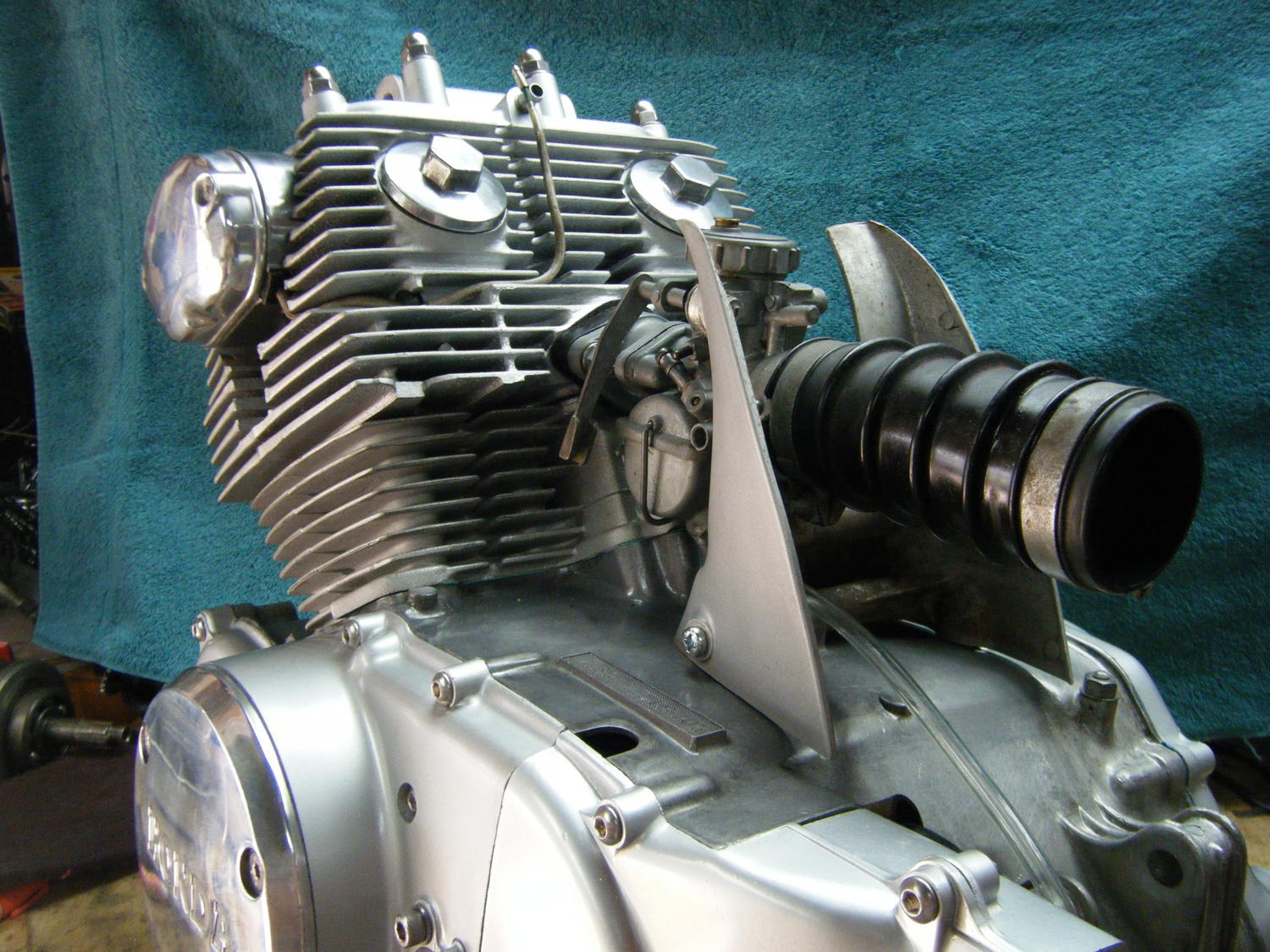

Finally got around to finishing the CA160 top end rebuild. All in all a pretty easy job. Made the usual mistakes, lost the cam chain tensioner a couple of times and learned how to "fish" cam chains. On the other hand I am certain about the timing and valve adjustments so am looking towards a nice start up.
I replaced the case fasteners with button head ss where possible, polished what I could, and painted the side covers. New rings on serviceable parts, std bore, lapped the valves ever so slightly, painted the cylinder and head, side covers and valve cover. Removed surface oxidation on the engine case and HI temp clear coated most everything. I probably should have replaced the clutch discs but I'm anxious to get it back together on the bike and the clutch project is an easy afternoon project.
Everybody likes engine pictures, right?
