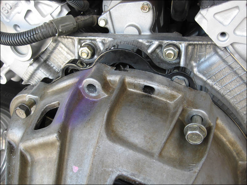

Smithers 03-07-2009 10:52 PM
DONE
http://www.fourwheelperformance.com/...1uzswap_55.jpg
http://www.fourwheelperformance.com/...1uzswap_54.jpg
Shake and Bake

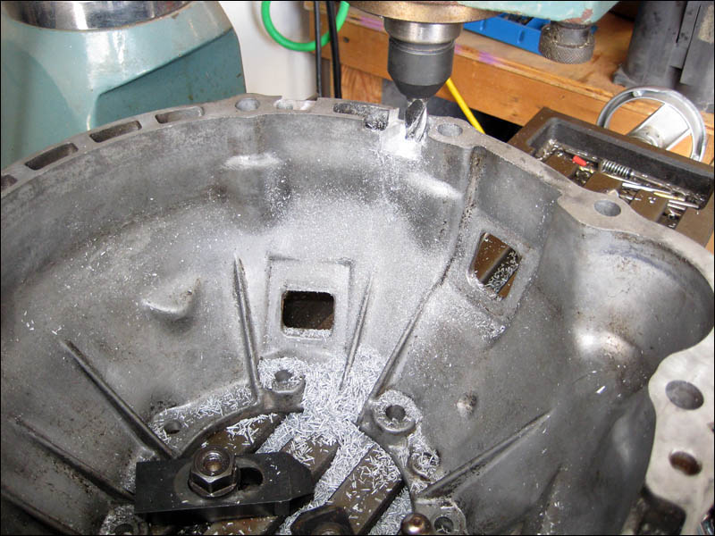

Smithers 03-13-2009 08:18 AM
It looks like I either need to get a longer transmission input shaft and swap it in OR I have to machine the bellhousing down by a total of maybe 3/4" at the most in order for things to work properly. Making this work isn't as easy as you would think. The adapter plate was very complicated to produce and you have to have the means to machine the bellhousing down properly as well. Of course there is someone in the midwest that has the ability to make and sell bellhousing adapters. But I would rather trust my machining ability in conjunction with factory Toyota parts.
To be continued...

NOTICE: The depth of the bellhousings. This is why I had to go through so much hassle to shorten my W59 bellhousing! This is a HUGE difference and this is why I don't recommend ANYONE attempt to do what I did. I basically just had a lot of fun fabbing mine but the resources (favors from machinists) I had to use were unbelievable. I would have swapped the R150 transmission in my Lexus V8 Tacoma creation without thinking about it twice! Hell I might still change my mind and go this way in the future if my tranny starts showing signs of weakness.
